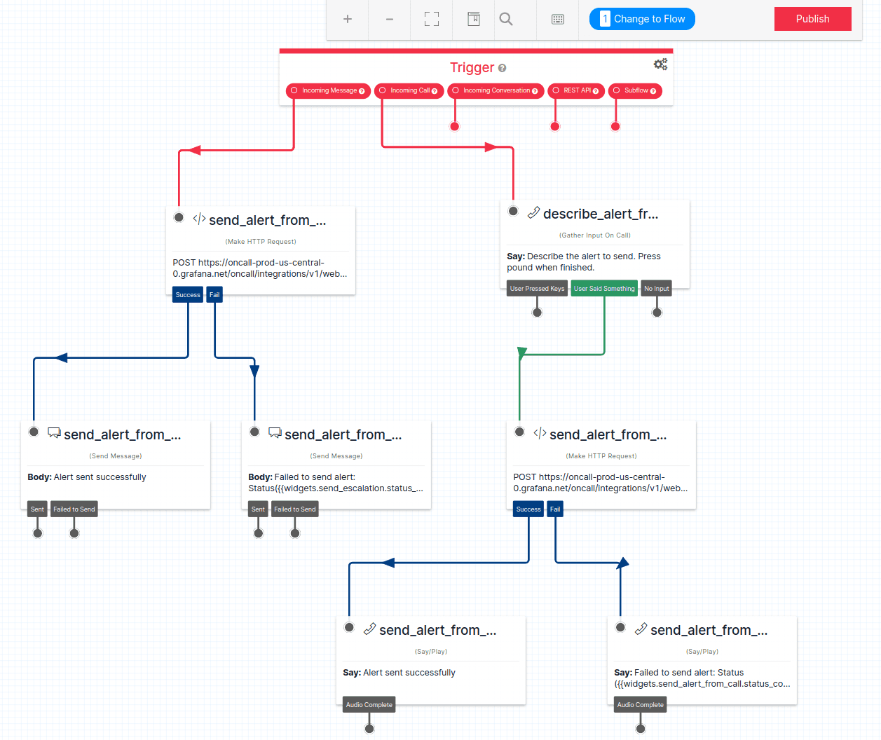

  6. After importing you should see something like this:
Studio flow workflow
This flow has two paths. The first path accepts the SMS message and forwards its contents to Grafana OnCall on the webhook integration we created. The content of the message will be passed as the message field along with the phone number the message was sent from. When the request is made to Grafana OnCall, whether it succeeds or fails, it will be communicated back to the sender.
The voice call path is similar — the caller describes the alert and it will be converted to text and sent to the integration in Grafana OnCall.
  1. Now press Publish to make the flow available to be connected to a phone number.

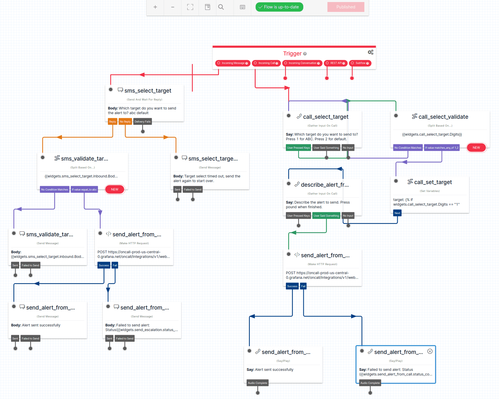

Here we need to set up a more complex Studio flow than the one we had in the “Basic setup” section.
  1. In the “Develop” tab, navigate to Studio -> Flows. (If you do not see Studio select Explore Products and select Studio under “Developer Tools” section; Also, pin it for easier access later.)
  2. On the Studio -> Flows page select Create new Flow.
  3. Enter a flow name and press Next.
  4. Select “Import from JSON” and press Next.
  5. Paste the following JSON into the dialog and replace <YOUR_INTEGRATION_URL> at Lines 54 and 156 with the URL of the webhook integration we created earlier in Grafana OnCall. Then press Next.

			"properties": {
				"offset": {
					"x": -330,
					"y": -50
				"service": "{{trigger.message.InstanceSid}}",
				"channel": "{{trigger.message.ChannelSid}}",
				"from": "{{flow.channel.address}}",
				"message_type": "custom",
				"body": "Which target do you want to send the alert to?\nabc \ndefault",
				"timeout": "300"
			"name": "sms_select_target_timeout",
			"type": "send-message",
			"transitions": [
					"event": "sent"
					"event": "failed"
			"properties": {
				"offset": {
					"x": -80,
					"y": 210
				"to": "{{contact.channel.address}}",
				"body": "Target select timed out, send the alert again to start over."
			"name": "sms_validate_target",
			"type": "split-based-on",
			"transitions": [
					"next": "sms_validate_target_fail",
					"event": "noMatch"
					"next": "send_alert_from_sms",
					"event": "match",
					"conditions": [
							"friendly_name": "If value equal_to abc",
							"arguments": [
								"{{widgets.sms_select_target.inbound.Body}}"
							"type": "matches_any_of",
							"value": "abc,default"
			"properties": {
				"input": "{{widgets.sms_select_target.inbound.Body}}",
				"offset": {
					"x": -590,
					"y": 210
			"name": "sms_validate_target_fail",
			"transitions": [
					"event": "sent"
					"event": "failed"
			"properties": {
				"offset": {
					"x": -700,
					"y": 500
				"body": "{{widgets.sms_select_target.inbound.Body}} is not a valid target."
			"name": "call_select_target",
			"type": "gather-input-on-call",
			"transitions": [
					"next": "call_select_validate",
					"event": "keypress"
					"event": "speech"
					"event": "timeout"
			"properties": {
				"number_of_digits": 1,
				"speech_timeout": "auto",
				"offset": {
					"x": 350,
					"y": 50
				"loop": 1,
				"finish_on_key": "#",
				"say": "Which target do you want to send to? Press 1 for ABC. \nPress 2 for default.",
				"stop_gather": true,
				"gather_language": "en",
				"profanity_filter": "true",
				"timeout": 5
			"name": "call_select_validate",
			"transitions": [
					"next": "call_select_target",
					"event": "noMatch"
					"next": "call_set_target",
					"event": "match",
					"conditions": [
							"friendly_name": "If value matches_any_of 1,2",
							"arguments": [
								"{{widgets.call_select_target.Digits}}"
							"value": "1,2"
			"properties": {
				"input": "{{widgets.call_select_target.Digits}}",
				"offset": {
					"x": 760,
					"y": 50
			"name": "call_set_target",
			"type": "set-variables",
			"transitions": [
					"next": "describe_alert_from_call",
					"event": "next"
			"properties": {
				"variables": [
						"value": "{% if widgets.call_select_target.Digits == \"1\" %}abc{% elsif widgets.call_select_target.Digits == \"2\" %}default{% endif %}",
						"key": "target"
				"offset": {
					"x": 760,
					"y": 300
	"initial_state": "Trigger",
	"flags": {
		"allow_concurrent_calls": true
  1. After importing you should see something like this:
Route added workflow
Here we have added steps that prompt the user to decide which target they want to send the alert to as well as validation steps to ensure the values are correct.
Reconfiguring the phone number
We can now change which flow our phone is configured to use.
  1. On the “Develop” tab, navigate to # Phone Numbers -> Manage -> Active Numbers.
  2. Select the purchased phone number from the list.
  3. In the “Voice Configuration” section, use the “A call comes in” dropdown and select “Studio Flow.” Set the flow to the new flow we created.
  4. In the “Messaging Configuration” section, use the “A message comes in” dropdown and select “Studio Flow.” Set the flow to the new flow we created.
  5. Press Save configuration,
Testing and troubleshooting
Testing and troubleshooting follows the same process as before. Exercise the SMS and voice call paths to test that you receive notifications from Grafana OnCall.
Next steps
Now that you’ve got everything connected, you can further edit and customize the Grafana OnCall routes and escalation chains. And by using the graphical editor for Studio flow, you can make changes to how SMS and voice calls are handled. Using these tools you can set up Grafana OnCall to send notifications to users in a way that matches your team structure using SMS and voice calls as a source of alerts.
