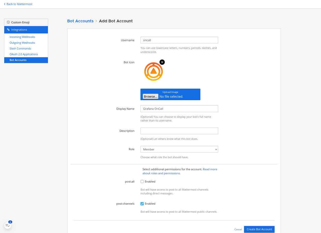

Mattermost is a popular open source and flexible messaging service supporting multiple integrations that you can self-host or use as cloud as a service. For this integration, the plan is to create a bot that will post alert group details to a Mattermost channel and keep those alert groups’ status and information up to date.
First, let’s create the bot account to access the Mattermost API using its access token:
Note: you may need to set the System Admin role to allow the bot to update the messages. See this Mattermost FAQ for more information.
You will get a token upon creation; make sure to keep that value at hand.

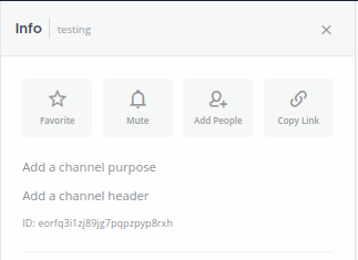

Next, add the bot user as a member in the channel you want the notifications posted to, and get the channel ID from that channel’s information view. To get there, click on the channel name dropdown and you will see the “View Info” option.

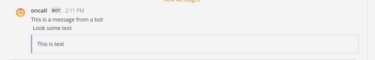

At this point you should have a token and the ability to use that token, as well as the channel ID, to hit the Mattermost API to post a message in the indicated Mattermost channel as the bot. Use this curl command to test the flow we want to use in Grafana OnCall:
$ curl -i -X POST -H 'Content-Type: application/json' -d '{"channel_id":"eorfq3i1zj89jg7pqpzpyp8rxh", "message":"This is a message from a bot", "props":{"attachments": [{"pretext": "Look some text","text": "This is text"}]}}' -H 'Authorization: Bearer qwd4k954qjyx3euumnbnqfa6wo' http://localhost:8065/api/v4/posts8065/api/v4/postsWhich should return an output similar to the following:

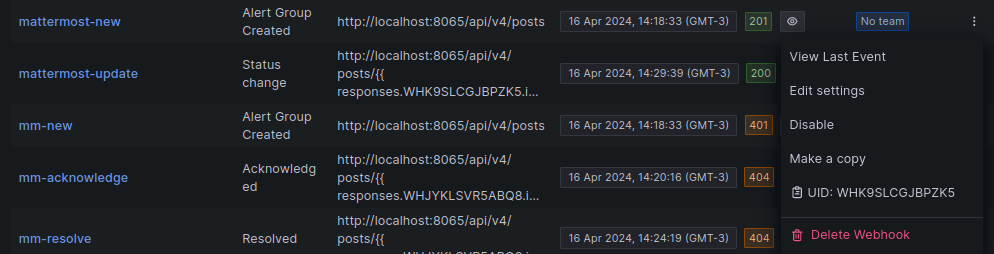

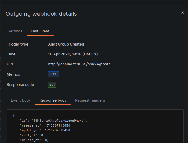

}To update a sent notification, you need to have the original message ID. This ID is included in the response after triggering the webhook we just created. Grafana OnCall webhooks maintain a record of previous responses linked to an alert group, allowing us to reference this information in our update webhook.

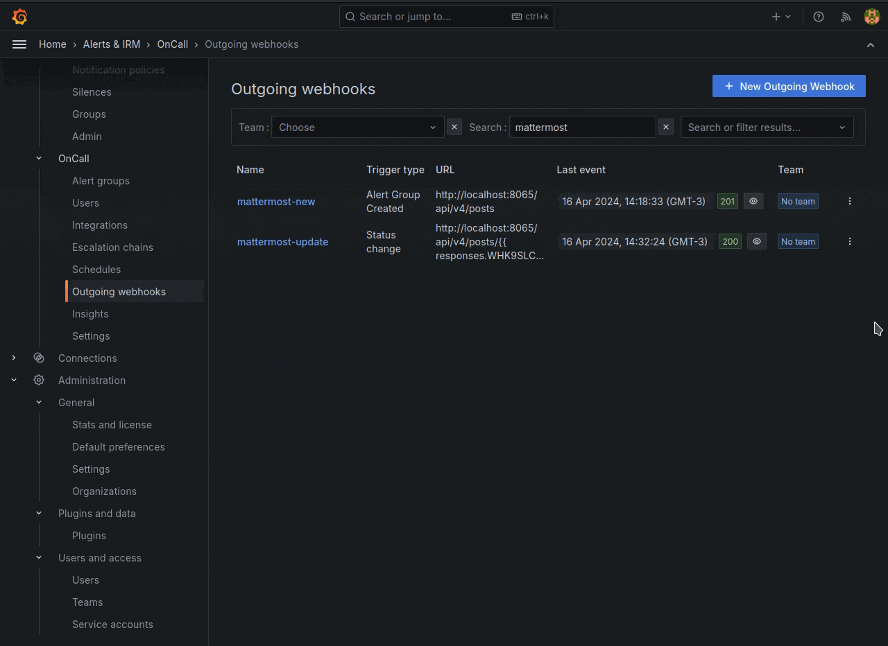

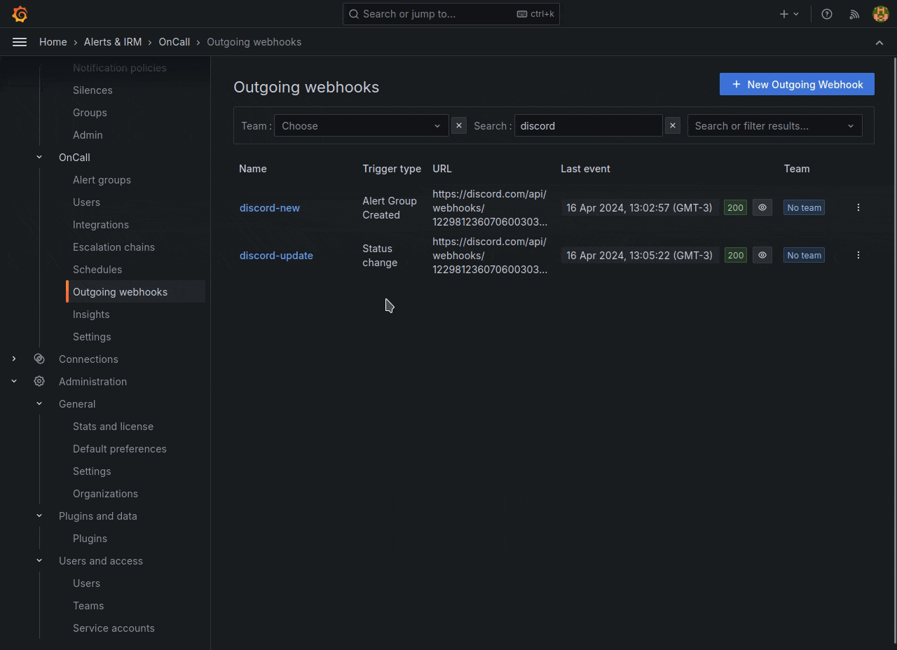

Then, we can use the template expression {{ responses.WHK9SLCGJBPZK5.id }} to reference the id field from the previous response to the webhook with ID WHK9SLCGJBPZK5, corresponding to the same alert group triggering the status change. (This is the mattermost-new webhook. You can get this ID from the webhooks listing UI; see below.)

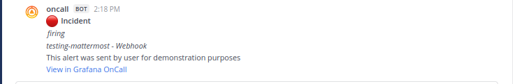

}And that’s it! If you send a demo alert, you should get a notification similar to this one:

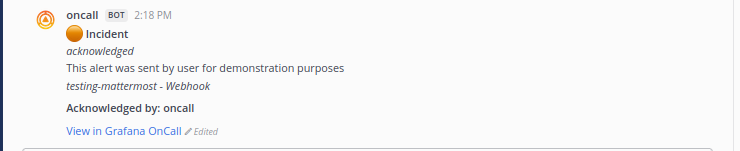

Which, after acknowledging, will be updated to:

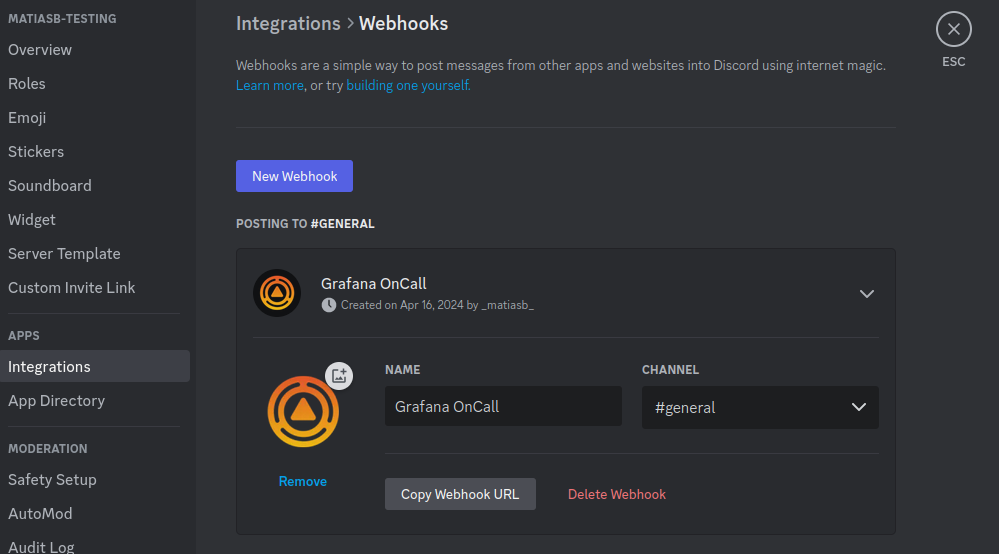

How to integrate Grafana OnCall with Discord
Discord is an instant messaging and VoIP social platform that supports voice calls, video calls, text messaging, and media and files. For this integration, the plan is to create a bot that will post alert group details to a channel and keep those alert groups’ status and information up to date.
In this case we will use Discord webhooks to implement the notifications:
Through a webhook URL we can do multiple operations. For our purposes, we are interested in:
- Creating a message, to post a new alert group notification
 - Editing a message, to update a previously sent notification when the alert group is updated
Note: when creating a message we will need to set the ?wait=true query param to get a response with the created message information, which we will need to update that message later.
How to connect Grafana OnCall to Discord
Similar to what we did for Mattermost, we need to create the Grafana OnCall webhooks following the linked API’s specification:
Here is what you need to enter to achieve what you see in the steps outlined in the GIF above:

}For the update webhook, we will use the message id from the previous discord-new response in the URL path:
- Name: discord-update
 - Enabled: True
 - Trigger type: Alert group status change
 - HTTP method: PATCH
 - Webhook URL: (Use your discord-new webhook ID instead.) [your Discord webhook URL]/messages/{{ responses.WH5PXWNJ7MT9Y5.id }}
 - Forward all: False
 - Data:
"content": "{% if alert_group.state == 'acknowledged'%}:orange_circle:{% elif alert_group.state == 'resolved'%}:green_circle:{% elif alert_group.state == 'silenced'%}:white_circle:{% else %}:red_circle:{% endif %} **{{ alert_group.title }}**\n*{{ alert_group.state }}*\n{{ alert_payload.message }}\n*{{ integration.name }}*\n\n{% if event.type == 'acknowledge' %}**Acknowledged by: {{ user.username }}**{% endif %}{% if event.type == 'resolve' %}**Resolved by: {{ user.username }}**{% endif %}{% if event.type == 'silence' %}**Silenced by: {{ user.username }} (until {{ event.until }})**{% endif %}\n\n[View in Grafana OnCall]({{ alert_group.permalinks.web }})"

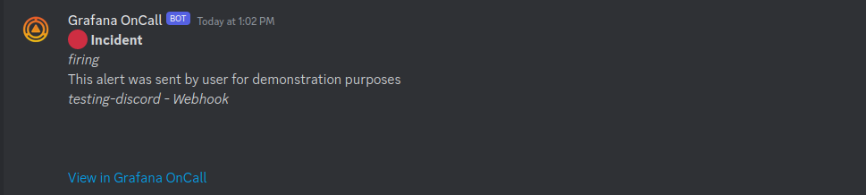

}Let’s trigger a demo alert and see how the notification looks:

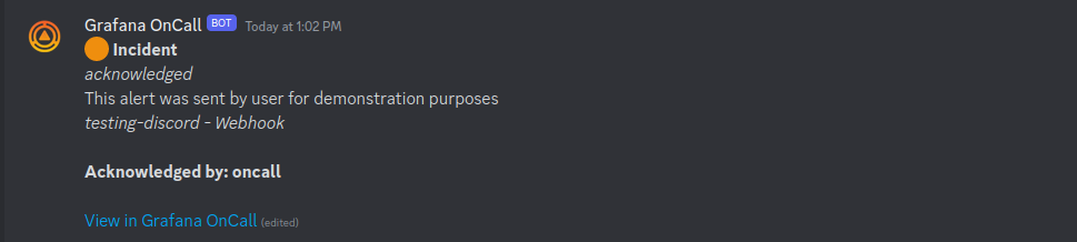

Which is then updated on acknowledgement:
