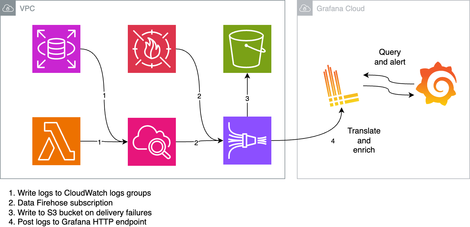

This solution makes it easy to connect Amazon CloudWatch logs to Grafana Cloud because you don’t have to deploy agents or local configurations. Instead, a Firehose stream is configured on your AWS infrastructure.
Delivery streams are configured to batch and send ingested records to Grafana Cloud Logs, which is powered by Grafana Loki, our open source log aggregation system. You can use the Firehose delivery stream to send logs from multiple AWS offerings, including Amazon CloudWatch (through subscription filters), VPC Flow Logs, AWS CloudTrail, and more.
To prevent potential data loss, you can also back up events to an Amazon S3 bucket. You can configure this for all log events or just for those that failed to get delivered—for example, if the delivery quota is exceeded. For more information about adjusting your backup based on the amount of log data you’re streaming, see the AWS documentation on data delivery failure handling.
A flowchart of AWS resources moving to Firehose, then to Loki and Grafana
Implement this architecture to process and deliver AWS logs to Grafana Cloud.

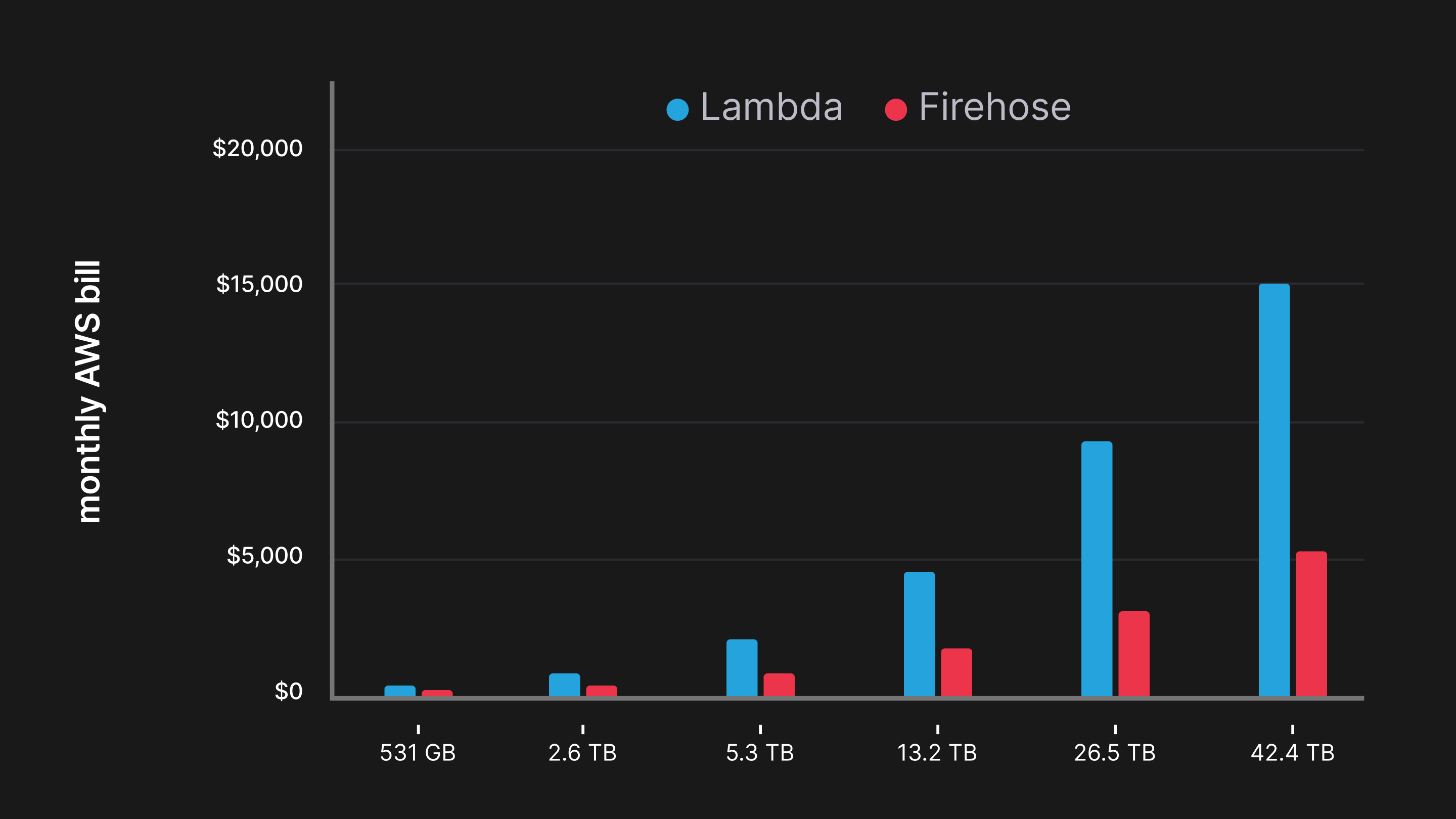

Historically, Logs with Lambda (also known as lambda-promtail) has been the de facto way to ship logging data from applications hosted in AWS and AWS-native services to Grafana Cloud Logs. This approach is versatile, but it can get really expensive as your log volume grows.
A bar chart shows the price differences in a monthly AWS bill for using Lambda and Firehose, with Lambda becoming more expensive as log volume grows.
The analysis above, which was done using the AWS Pricing Calculator, gives a rough idea of the cost trends associated with using Lambda vs. Firehose to ship logs from AWS. As you can see, Logs with Lambda can quickly become 3x more expensive than Logs with Firehose.
With AWS Lambda, CloudWatch Logs triggers one invocation per log entry. Lambda charges per invocation, so that approach can get expensive really quickly. On the other hand, Firehose is a stateless component, with no runtime that can fail (in comparison to Lambda), and it’s designed to batch and send data. Also, you’re billed by data volume, not by count, which makes Firehose the perfect solution for streaming a large volume of logs.
