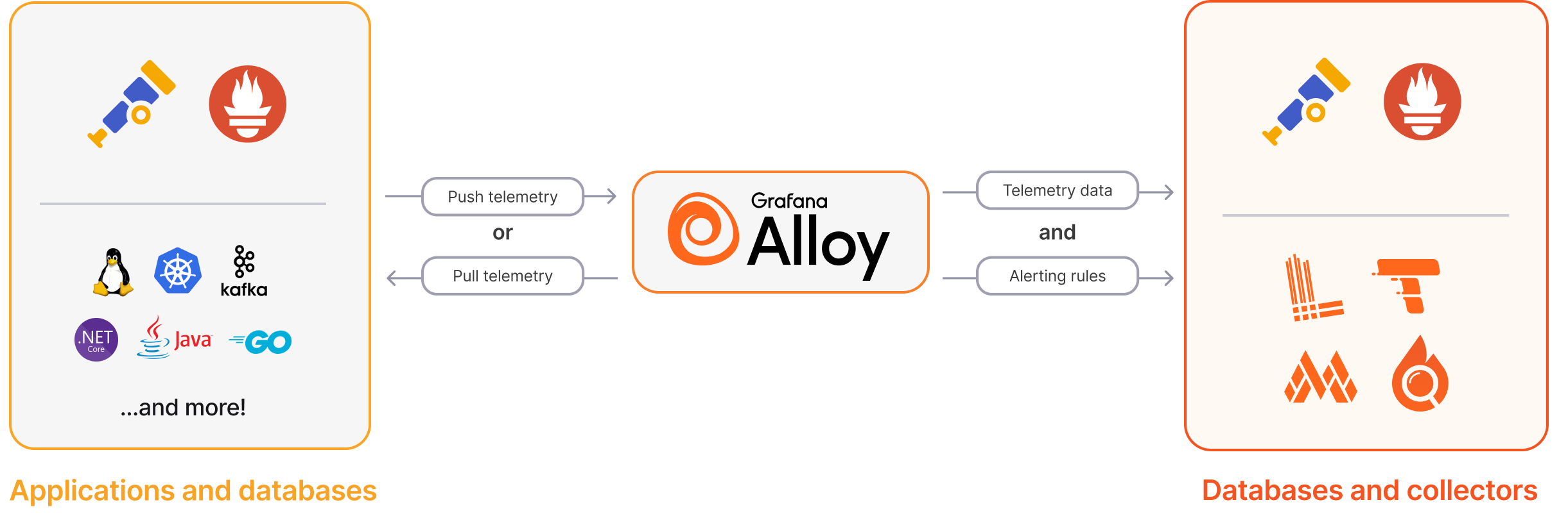

Architecture diagram for Grafana Alloy
Alloy can also be used with Grafana Cloud or any compatible backend from other vendors. You can configure Alloy with your observability solution to fit on-prem, cloud only, or a mix of both. It’s also flexible enough to cater to different users, large and small, at different phases of their observability journey.
