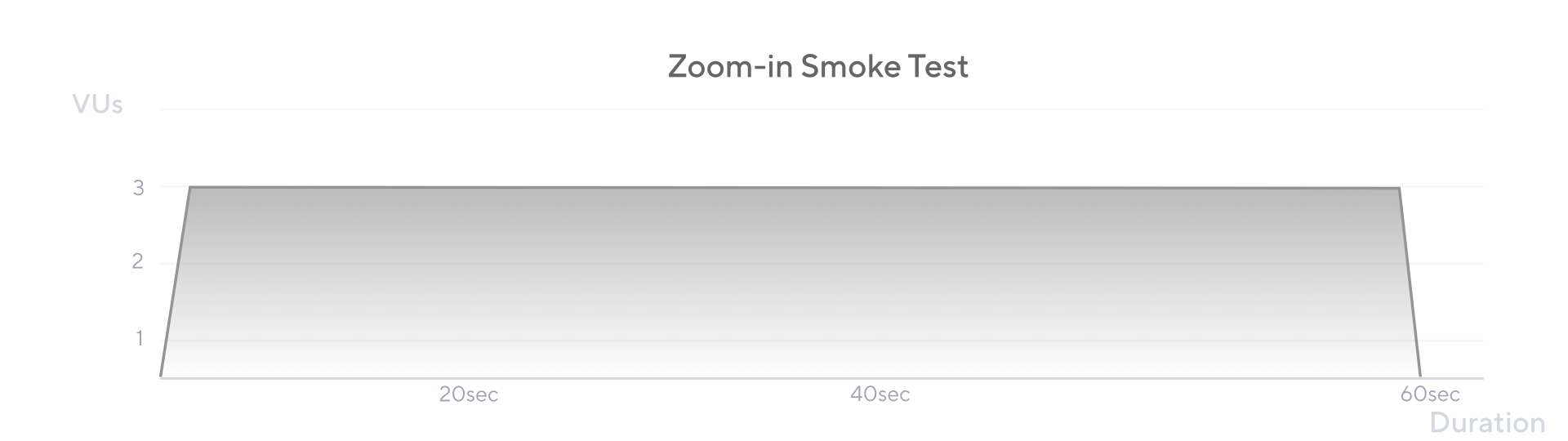

The following script is an example smoke test. You can copy it, change the endpoints, and start testing. For more comprehensive test logic, you can find more load testing examples in our k6 documentation. The VU chart of a smoke test should look similar to this:
Smoke test chart for a longer duration in Grafana k6.
