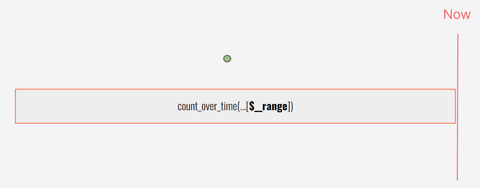

Grafana has a variable that can make our lives a lot easier. This variable will map the time selector automatically to this range value, so if we select 1h or 6h from the time picker our query will automatically adjust to that range.
A diagram of an instant query with a variable.
Note: The font makes it hard to see, but the variable is dollar sign, two underscores, range.

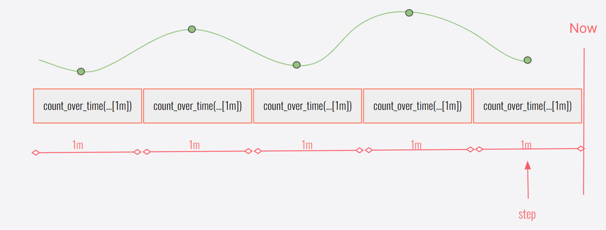

We started with instant queries because they are simpler — and they’re actually the building block of a range query — but range queries are what most people work with most of the time because they produce a graph result.
Range queries are nothing more than an instant query executed multiple times. For each execution we get a point (or points for multiple series) in our result. It looks like this:
A diagram of a range query.

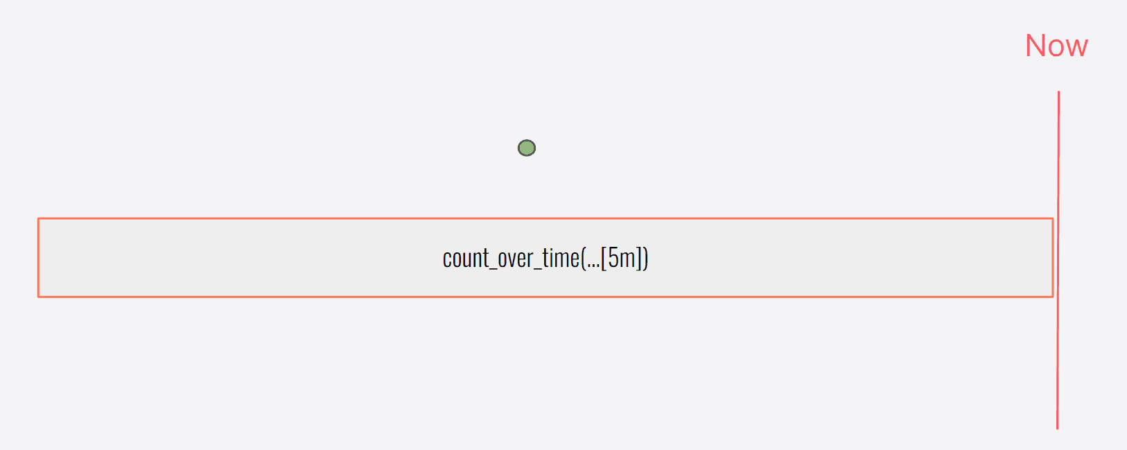

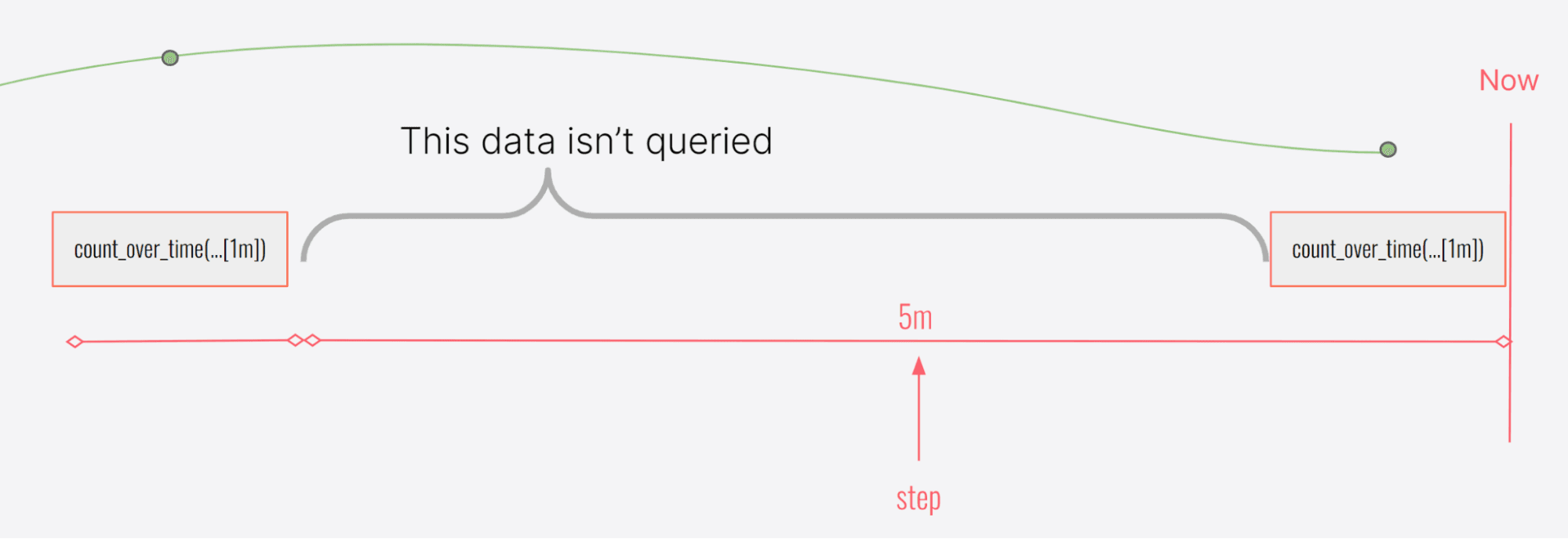

In the example above, the range value in the query was 1m and the step was 1m. This is great, but what happens when they aren’t the same?
A diagram visualizes the concept described below.
In this example, the step is 5m but the range value was only 1m. This might happen if you have a really large time window (weeks or a month) and Grafana chooses a larger value for the step based on its calculation of interval.

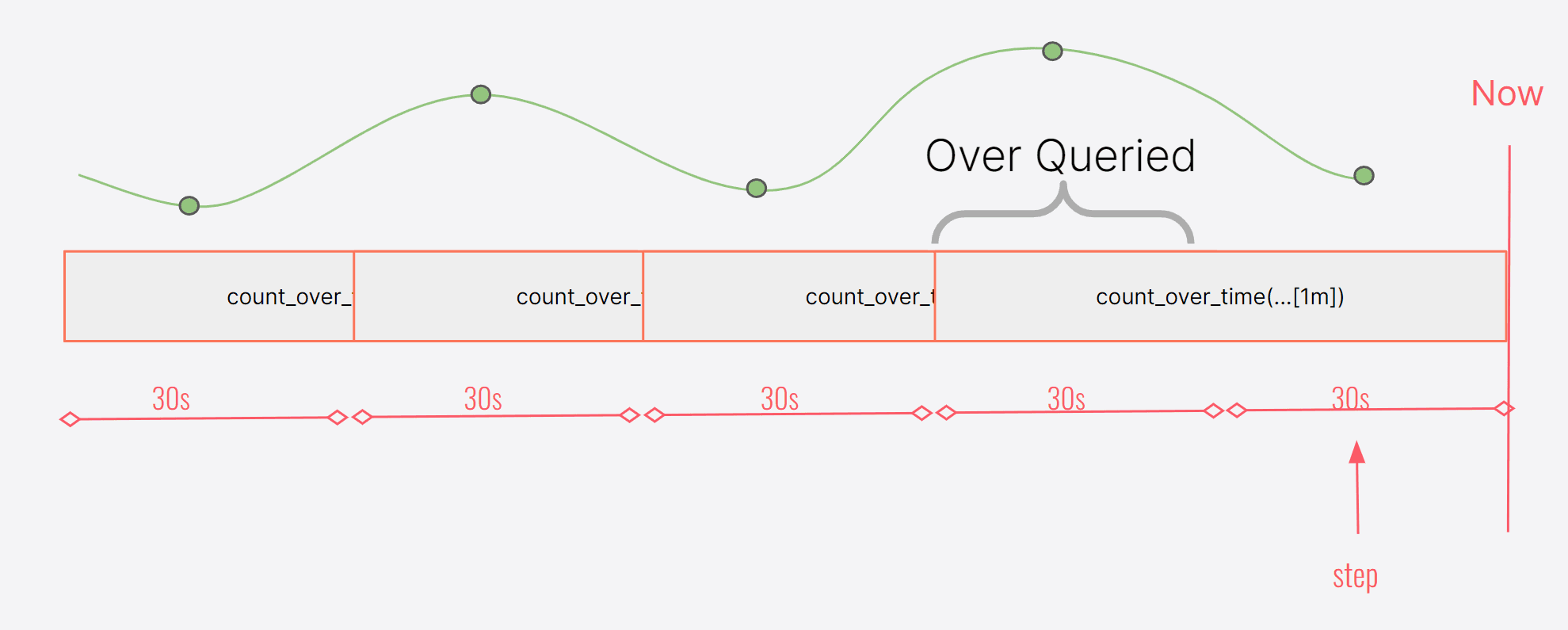

A diagram illustrates overquerying.
Here’s the opposite example. Perhaps the time window was only a few hours. In that case, the step might have been much shorter than the range. If the query is only for an hour, the step could only be a few seconds.
In both of these examples Loki is executing a count_over_time, and in both examples it’s going to produce a result which may not be what you expected. In the first, there is data that isn’t counted, and in the second there is data that is counted twice.

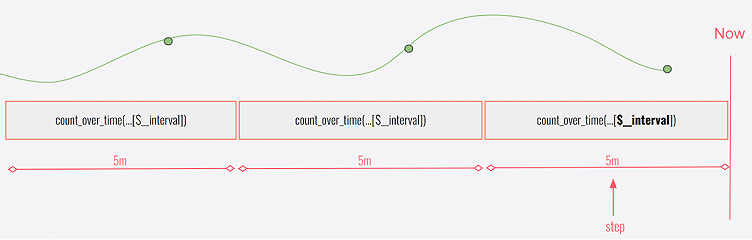

Good news! Grafana has another variable we can use that will address this:
A diagram illustrates the concept described in the copy below.
By using $__interval inside the square brackets, Grafana will substitute the value it calculates for interval, which is the same value it will send to Loki as the step. This will guarantee that no matter how much you zoom in and out, Loki will always exactly query all your data.
This is why 99.9% of the time I recommend using [$__interval] for range — it will give you the best result and offer the best performance.
