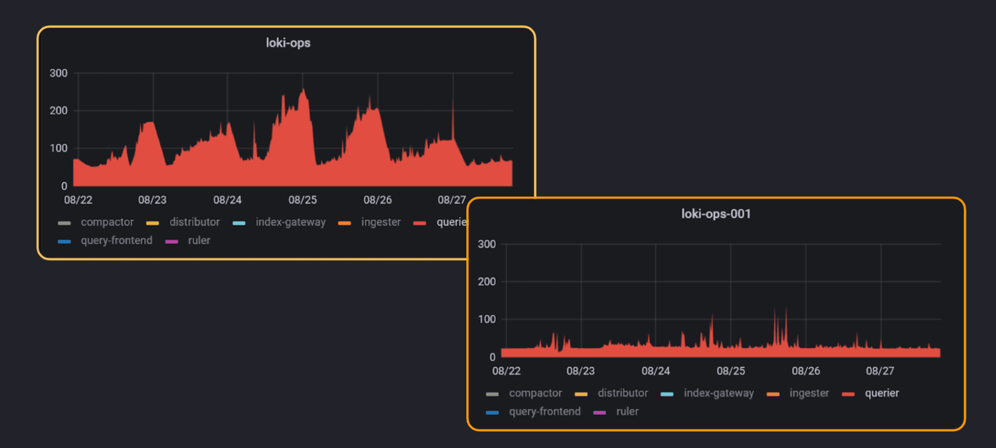

For the operator: Improved resource utilization. One benefit that jumps off the page is the reduction in object storage footprint, which directly translates to money saved for the user. When operating Loki with TSDB index internally, we’ve seen a 75% reduction in the size of our indices, with a much lower, and healthier, compression ratio.
The TSDB index also allows us to better provision resources at query time. While this has fantastic benefits for the person performing the query, this smarter query planning also allows us to better provision compute resources.

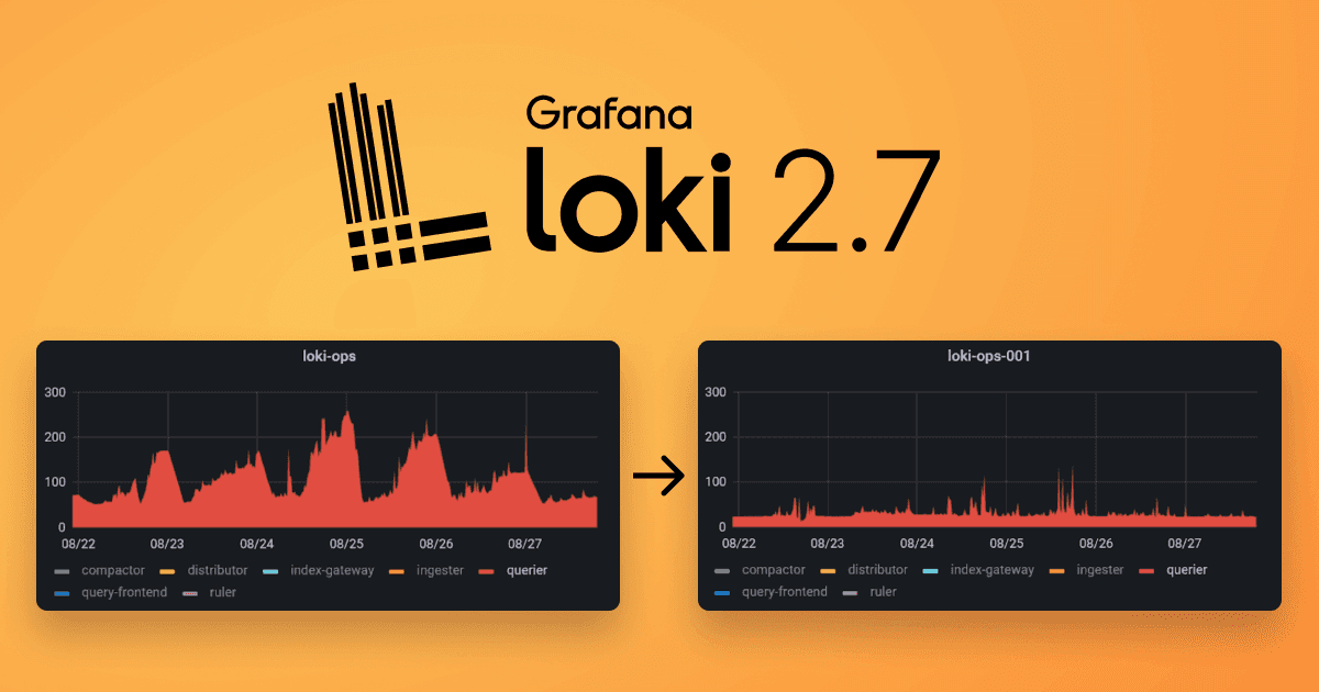

Dashboards showing the decrease in CPU usage using the TSDB index in Grafana Loki 2.7
For the end user:More performant querying. At peak performance, we’ve seen that Loki can now scan log lines at up to 400GB/second, roughly 4x faster than before. The improved query planning, combined with a few other enhancements, makes queries much more responsive, and users can get to their vital log data faster.
