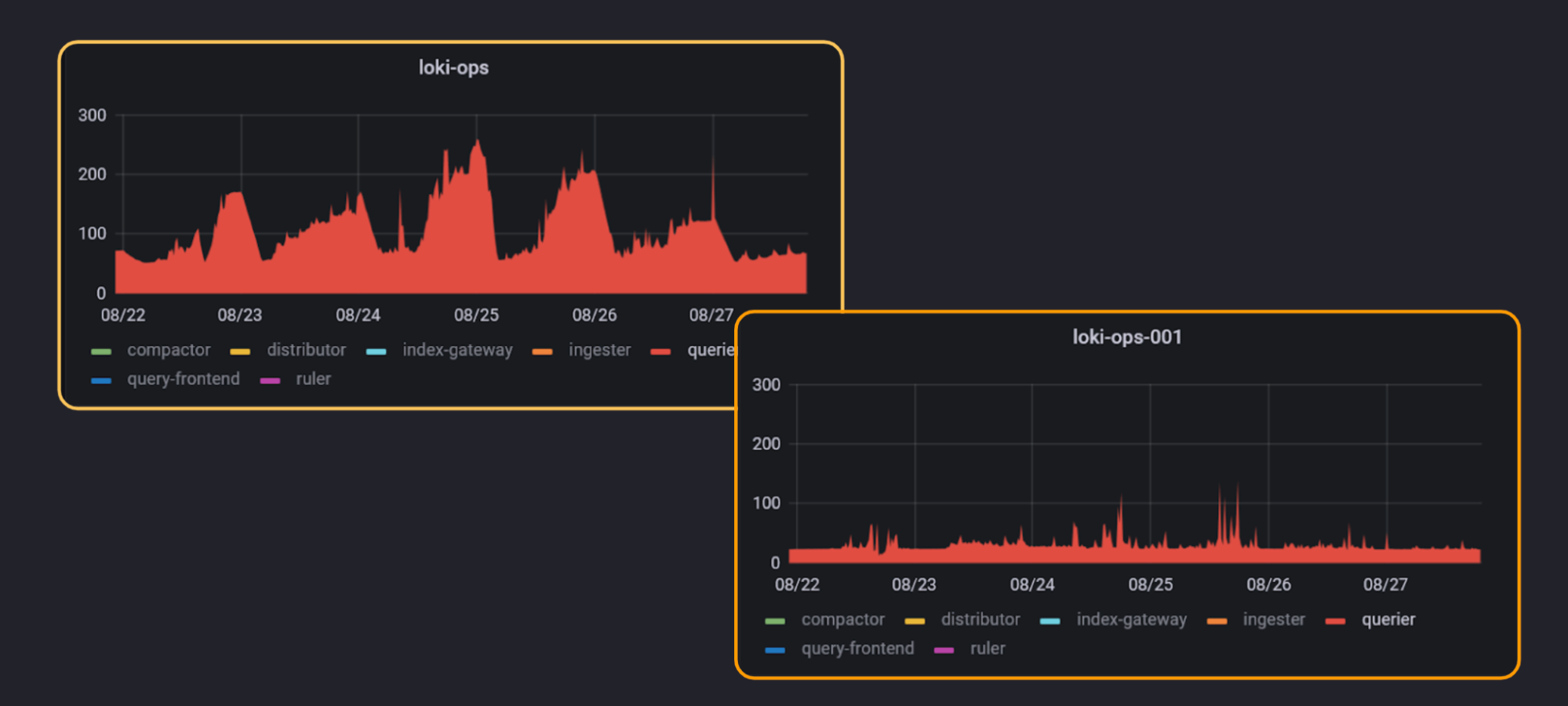

Dashboards showing the decrease in CPU usage using the TSDB index in Grafana Loki 2.7
Stark improvements in query resource utilization after TSDB rollout: fewer resources consumed, more predictable workload.
For the end user: More performant querying. At peak performance, we’ve seen that Loki can now scan log lines at up to 400GB/second, roughly 4x faster than before. The improved query planning, combined with a few other enhancements, makes queries much more responsive, and users can get to their vital log data faster.
