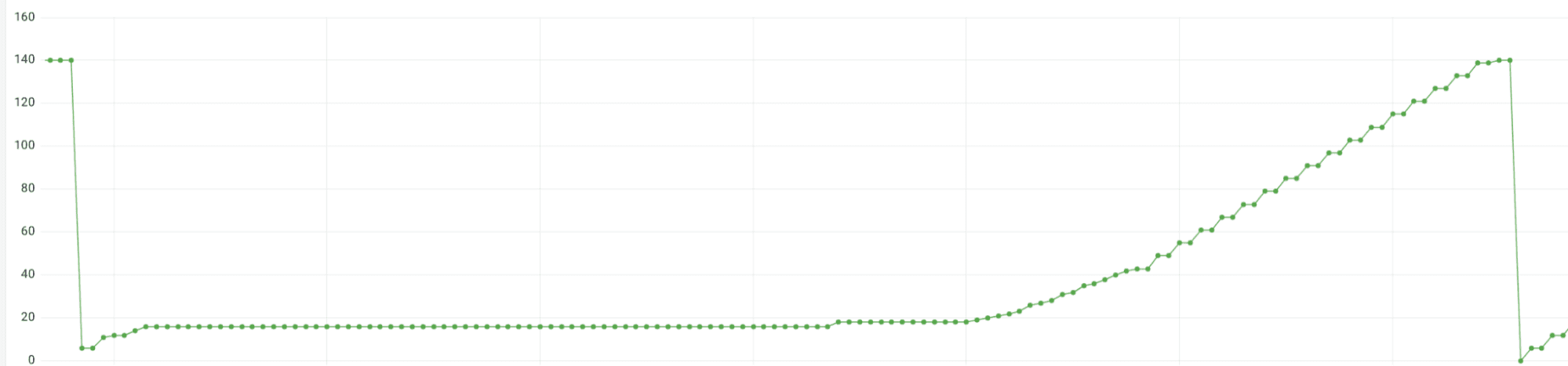

Luckily we collect tons of metrics and logs from all our services as well as Kubernetes. The first clue that something was off was that kubectl get pods and the Kubernetes metric for the number of pod replicas that have been updated since the last config change showed that only 10% of distributor pods had been restarted. Initially, we thought that because of how log streams are sharded and replicated to certain subsets of pods that there could be a particularly high volume stream that had an increase in throughput, or many more additional streams had been created, and we just happened to deploy at an inopportune time.
Graph showing Kubernetes metric kube_deployment_status_replicas_updated.
In the graph above, the Kubernetes metric kube_deployment_status_replicas_updated shows that for the duration of our outage, 16/140 distributors were in an “updated” state.

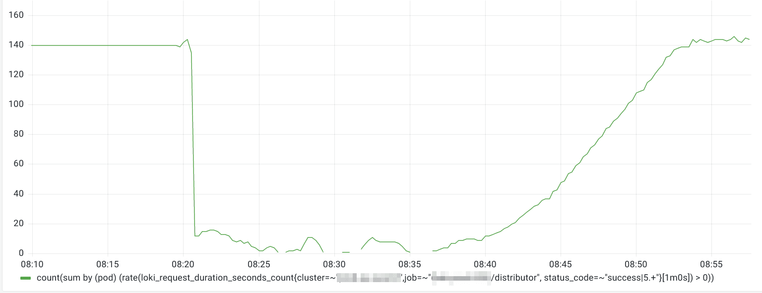

However, again we have metrics for the rate of incoming write requests as well as the number of active streams and neither metric had changed immediately before the incident. We now suspected that something had changed with the routing of requests to distributors and were looking for confirmation. Using the metric loki_request_duration_seconds_count reported by each distributor pod, we could look at the rate of incoming requests for the writes route where the rate was > 0 during the incident and count the number of series, which showed us that 16/140 distributor replicas were receiving write requests.
Dashboard showing Kubernetes distributors serving 0 requests per second.Line graph showing Kubernetes distributors underperforming.Graph showing a normal Kubernetes rollout.Embedded image
The graph above is the same loki_request_duration_seconds_count query from above. Here you can see that we essentially have no drop in the number of distributors successfully serving requests since they’re able to quickly start up properly. The baseline near the bottom of the Y-axis of the graph is the 140 amount. The reason the graph goes above 140 is because of the behavior of Prometheus rate queries using time ranges to look back in time.

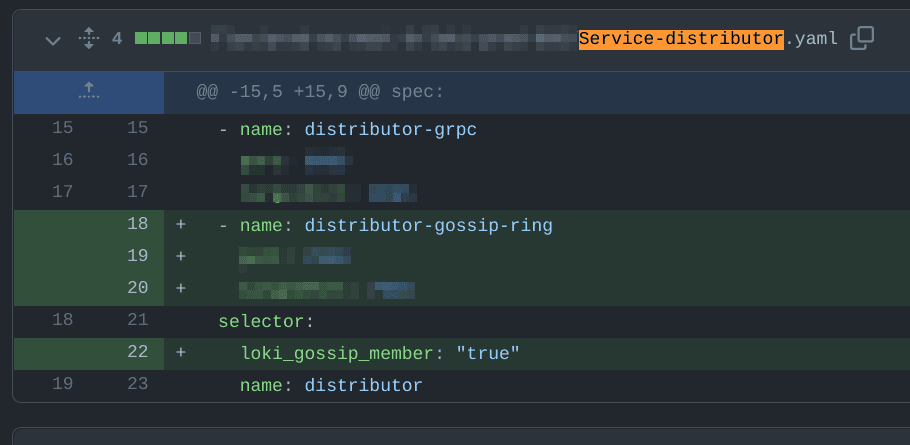

Now we just needed to find the cause. Luckily we have automation in place to generate diffs between the Kubernetes manifests for all pull requests that will result in changes to any environments. These diffs are posted to PRs and are even stored in a separate repository. Looking at these diffs, we were able to determine that the selector was added to the distributor service and had resulted in the recreation of the distributor service within that Kubernetes cluster/namespace. This is something that is not normally part of any deploys. After reading the documentation for Kubernetes labels and selectors, we knew this was the cause.
Code adding the Kubernetes label selector.
