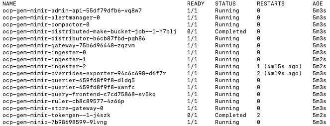

Step 4: Check the status of the Pod that is running the tokengen job.
Once it’s completed, check that job’s logs for the new admin token:
oc logs ${TOKEN_GEN_POD_NAME} -n ${PROJECT_NAME}
After a couple of minutes you should see the following by running: oc get pods -n ${PROJECT_NAME}
Below is the OpenShift UI representation of the running pods and completed token job.
