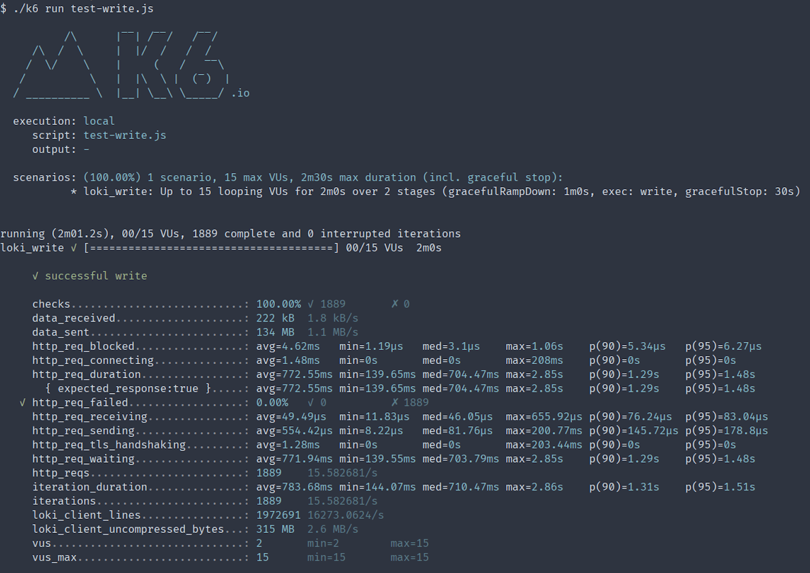

Last but not least, what would a load test be without gathering hard data that you can analyze and compare? In addition to the build-in metrics of k6, the extension collects additional custom metrics — both for push and query requests — and they are printed in the end-of-test summary. Here’s an example of what one looks like:
Embedded image
For query requests, these metrics are exposed:
  • loki_bytes_processed_total
  • loki_bytes_processed_per_second
  • loki_lines_processed_total
  • loki_lines_processed_per_second
loki_bytes_processed_total and loki_lines_processed_total are counters for bytes and lines respectively.
loki_bytes_processed_per_second and loki_lines_processed_per_second are throughput rates for bytes and lines respectively.
All four metrics are derived from the query response statistics sent by the Loki server.
And for push requests, you’ll want to use:
  • loki_client_lines
  • loki_client_uncompressed_bytes
loki_client_lines is a counter that counts the total number of lines that have been pushed to Loki during the time of the load test. loki_client_uncompressed_bytes counts the total number of bytes of the pushed log lines.
These metrics provide insights in how much data was transferred to and processed by Loki.
