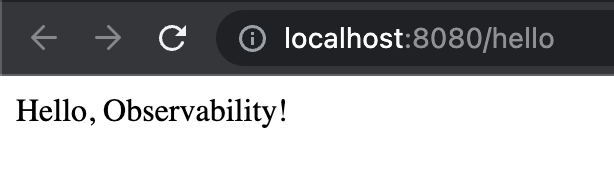

You can then run the application directly and access it here: http://localhost:8080/hello. Very simple application, indeed!

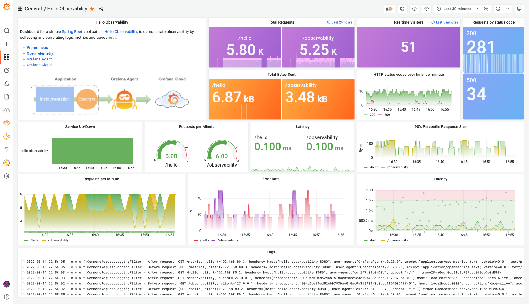

We have not done any instrumentation to collect logs, metrics, and traces so far. To do so, you will have to start all services using docker-compose. All configurations needed to generate and collect logs, metrics, and traces are already configured.
Let’s now run the whole stack locally inside Docker to see it in action. The whole stack contains:
- The Hello Observability application
- A simple load runner
- Prometheus for metrics
- Grafana Loki for logs
- Grafana Tempo for traces
- Grafana Agent to collect logs, metrics, and traces
- Grafana
cd hello-observability/local
docker-compose up
After all the containers are up, you can access the application here: http://localhost:8080/hello, and Grafana here: http://localhost:3000. A dashboard called Hello Observability is also pre-loaded.

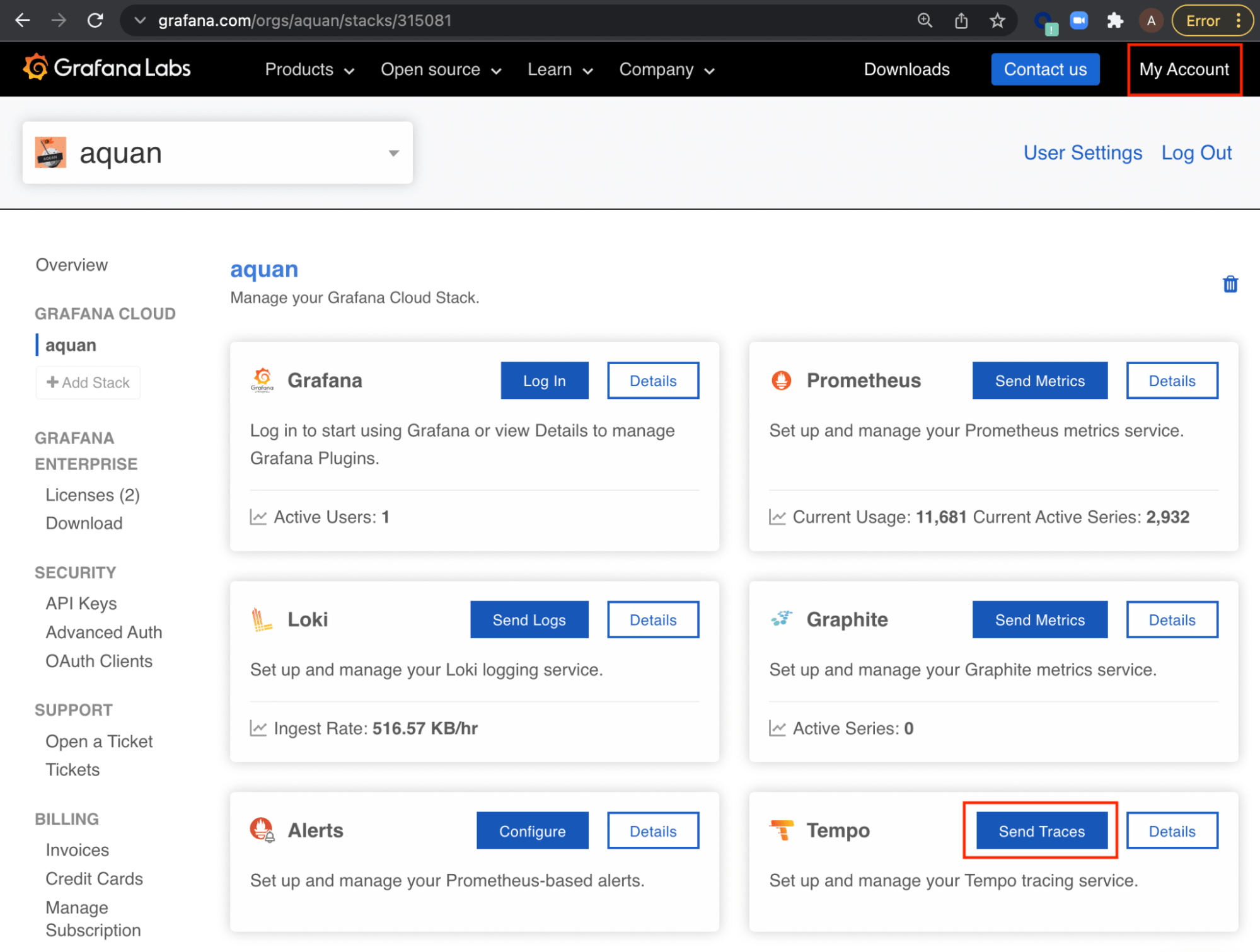

To send logs, metrics, and traces to Grafana Cloud, we need to gather our Grafana Cloud connection information for Loki, Prometheus, and Tempo, so that we can configure our Agent accordingly. That’s what we will do next.
Connect Grafana Cloud Traces
Grafana Cloud Traces is the fully-managed, highly-scalable, and cost-effective distributed tracing system based on Grafana Tempo. That’s where our traces will go.
Tempo connection information includes endpoint URL and user credentials. Navigate to grafana.com and login. Make sure you select the right account from the account dropdown. My account name is aquan. Click on My Account, then Send Traces in the Tempo section.
You should see something like the screenshot below, with information about the endpoint and user credentials. You can generate a new API Key by clicking on the Generate now link or navigate to the Security → API Keys section.

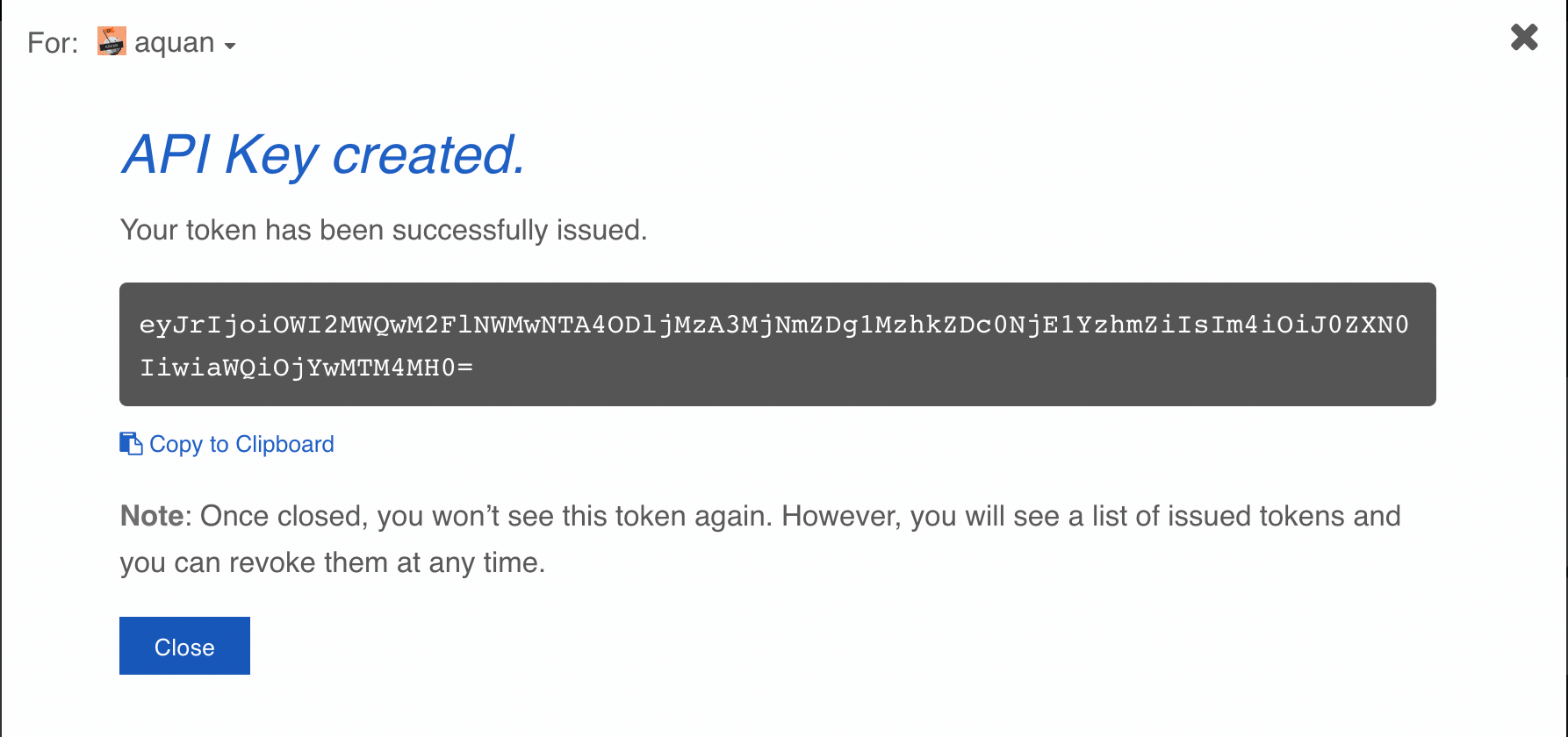

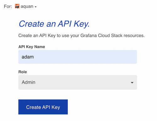

Either way, the API Key creation screens look like below. (No worry about me exposing my API Key. It’s already deleted.)
In this case, here is the Tempo information for my Grafana Cloud account:
- Endpoint:
https://tempo-us-central1.grafana.net:443
- User:
160639
- API Key:
eyJrIjoiZGNjYjFjMzFjMTQ2YTA4MmI3YzhiMWRhNDdlOTFhNmJiNGE5OTRmMyIsIm4iOiJhZGFtIiwiaWQiOjYwMTM4MH0=

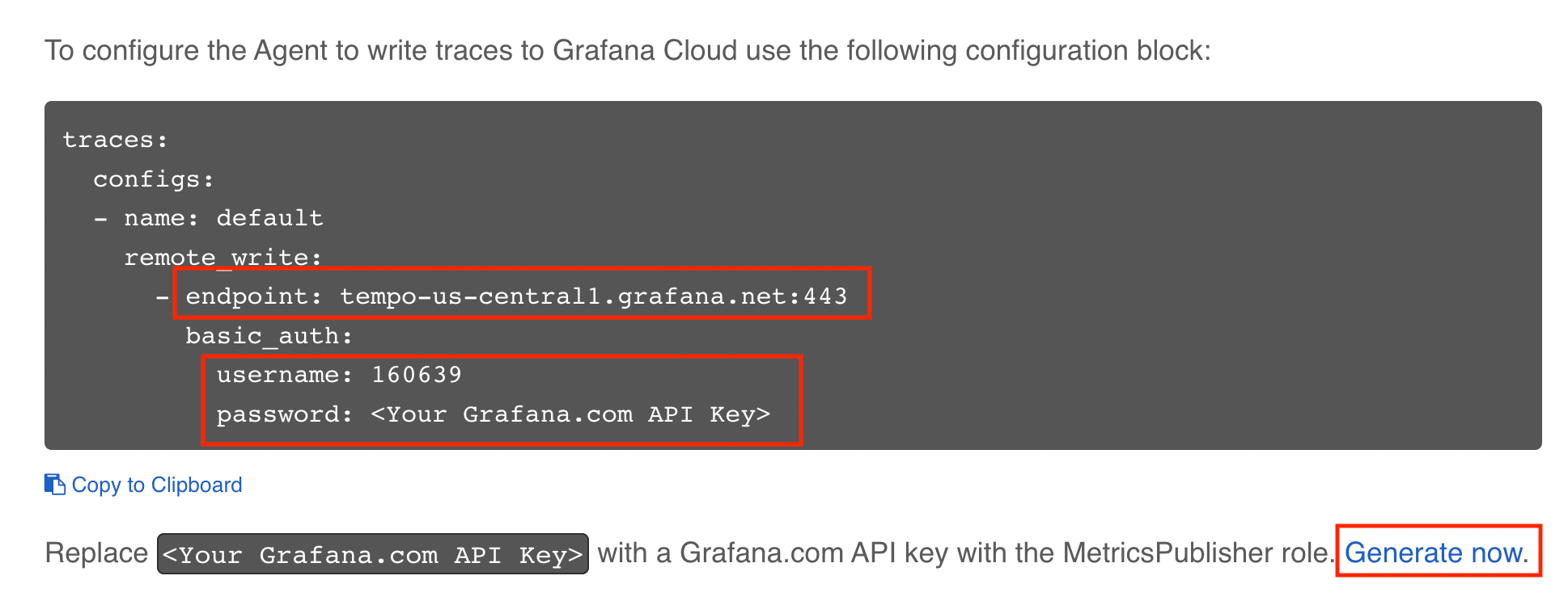

Configure traces
In the context of tracing, Grafana Agent is commonly used as a tracing pipeline, offloading traces from the application and forwarding them to a storage backend. The Grafana Agent supports receiving traces in multiple formats: OpenTelemetry (OTLP), Jaeger, Zipkin, and OpenCensus.
Here is the traces
section from the Grafana Agent configuration file. Other than the Grafana Cloud Tempo URL and authentication information, we are basically saying the agent is expecting traces in OTLP format over the HTTP protocol. You can also configure it to use Jaeger format if you like, but we recommend the OTLP format.
traces:
configs:
- name: default
remote_write:
- endpoint: tempo-us-central1.grafana.net:443
basic_auth:
username: 160639
password: <API_KEY>
receivers:
otlp:
protocols:
http:

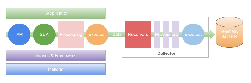

How to instrument Spring Boot with OpenTelemetry
The open source observability framework, OpenTelemetry, is gaining popularity very quickly. OpenTelemetry is the result of merging OpenTracing and OpenCensus. As of writing today, traces are the most mature component of OpenTelemetry, and logs are still experimental. We will focus on the tracing aspect of OpenTelemetry in this blog.
OpenTelemetry is a collection of APIs, SDKs, and tools that you can use to instrument, generate, collect, and export telemetry data that can in turn help you analyze your software’s performance and behavior. OpenTelemetry is both vendor and platform agnostic, which is one of the reasons it’s getting popular very quickly.
In general, instrumentation can be done in three different places: your application code; libraries and frameworks your application depends on; and the underlying platform, such as Kubernetes, Envoy, or Istio. The nice thing about OpenTelemetry is that instrumentations are already done in many popular libraries and frameworks, such as Spring, Express, etc.
Something that is worth noting is the auto-instrumentation capability of OpenTelementry. Auto-instrumentation allows developers to collect telemetry data without making any code changes. We will be leveraging the auto-instrumentation capability of the Java Agent to instrument our Hello Observability application, with no code change necessary.

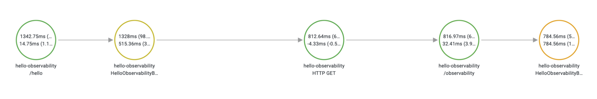

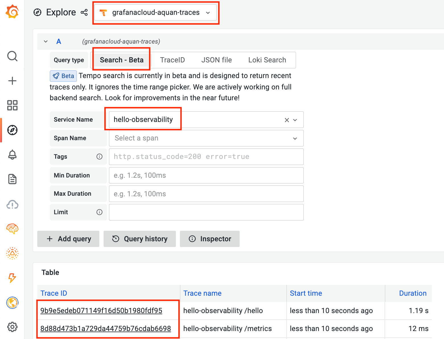

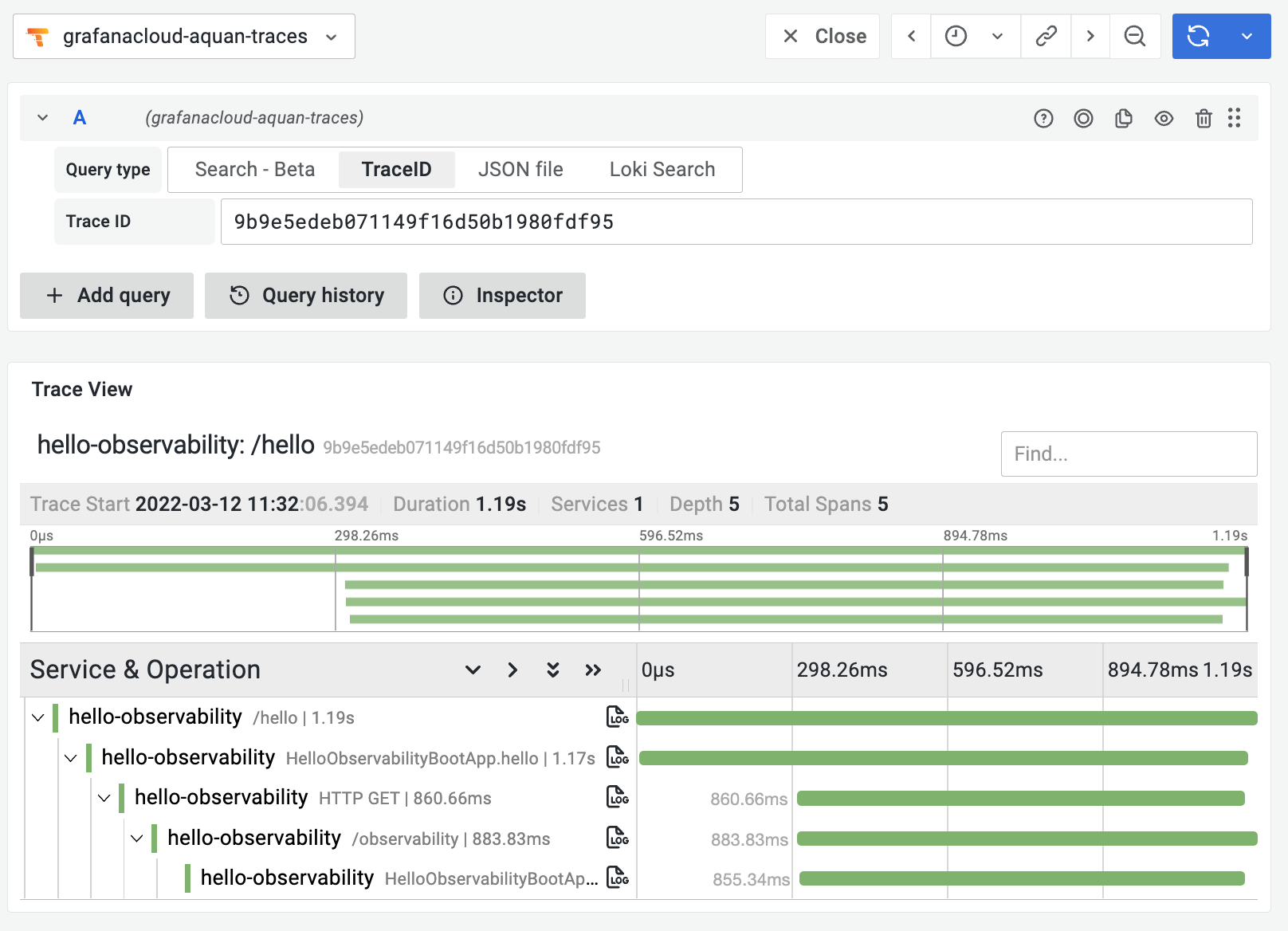

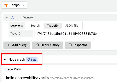

While the application is running, log into your Grafana Cloud account. Select your Tempo data source from Explore. In my case, it’s called grafanacloud-aquan-traces. See your traces by clicking on the Search button and selecting hello-observability for Service Name. Remember we set OTEL_SERVICE_NAME
to hello-observability
Click on one of them to see the waterfall visualization of the trace. Later, once we have logs and metrics shipped to Grafana Cloud too, you will be able to correlate logs, metrics, and traces together! The power of a unified observability platform!
If you are running everything locally, you will also be able to see the bonus Node Graph, which is still in beta, as of writing.
This is what the node graph for the trace above looks like:

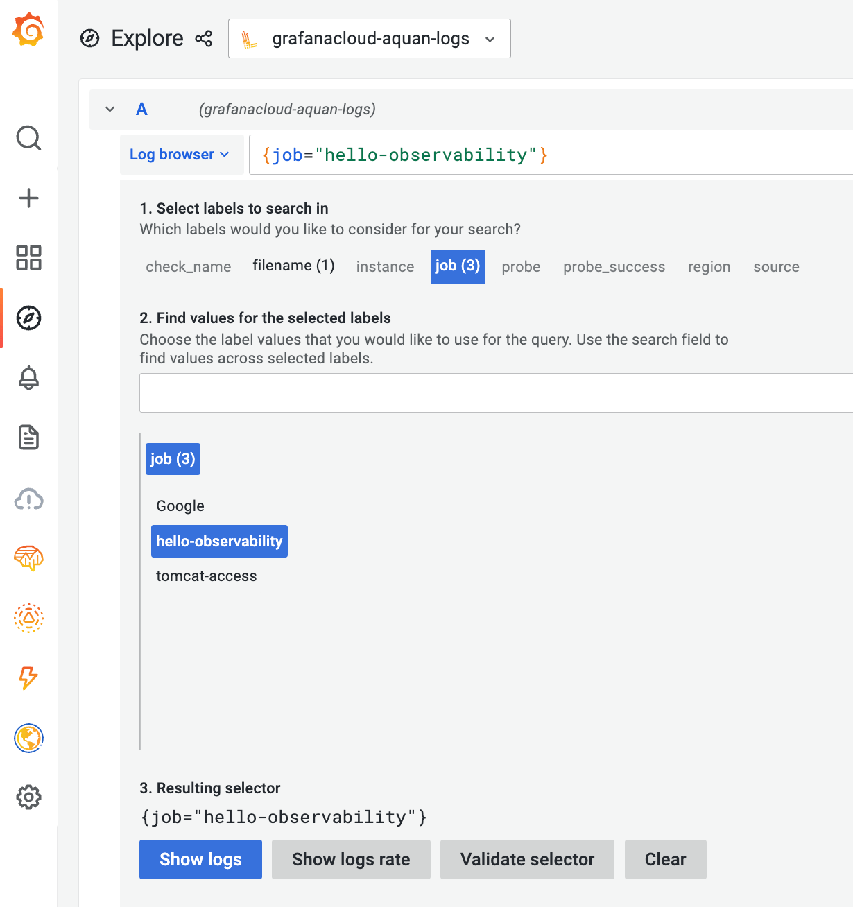

Go to Grafana Cloud, then Explore, and select the Loki data source. In my case, it’s called grafanacloud-aquan-logs
. Use the Log browser to select the hello-observability
job. Then click on Show logs.

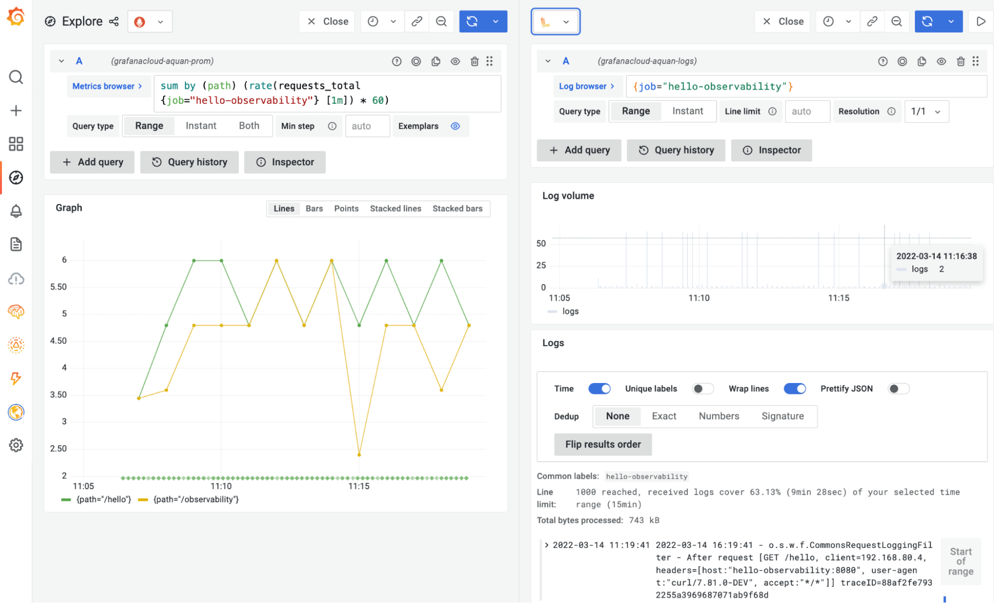

You should see some log lines. Expand one of the log lines and click on grafanacloud-quan-traces
, you should see something like this below. The magical correlation between the logs and traces all done automatically because of the trace ID!

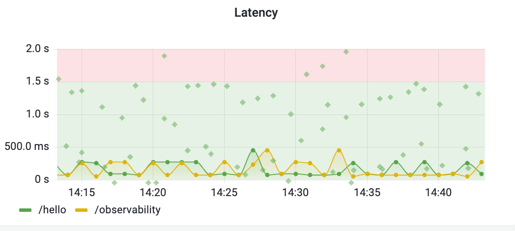

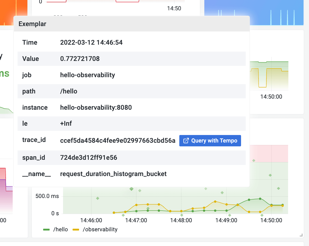

Make sure the application is running. Go to Grafana Cloud, and the Hello Observability dashboard. The Requests per Minute visualization shows Prometheus metrics with exemplars, which are the green dots.
Mouse over one of them, and you will see a pop-up panel with a trace_id
label that has a link to take you to the trace directly. The power of exemplars!
If you are curious about the metrics with exemplars collected by Prometheus, send a request to
http://localhost:9090/api/v1/query_exemplars?query={job=”hello-observability”} and check it out. It will look something like the following. The exemplars are set as metadata labels, as span_id
and trace_id
{"labels":{"span_id":"405e4b409d62cd38","trace_id":"7893cdf3ce9d2401ffcee7d7f0db569d"},"value":"1.090101375","timestamp":1647142355.737}

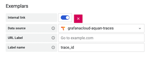

For the exemplar pop-up dialog to show a link to Tempo, you do have to configure the Label name to be trace_id
in the Prometheus data source configuration. The default is traceID
. Otherwise, you will not see the link. You cannot edit the pre-configured Prometheus data source in your cloud account. You will have to create another Prometheus data source with the same connection information, then add the exemplar configuration.
Also, since exemplars are still new, you do have to request it to be enabled for your Grafana Cloud account. If you run Grafana locally, the latest release of Grafana already supports exemplars.
Correlating logs, metrics, and traces in Grafana
Observability is not only just about collecting all the telemetry data in the form of logs, metrics, and traces. More importantly, it’s about the ability to correlate this telemetry data and derive actionable insights from it.
You can obviously connect and correlate any telemetry data visually by graphing them onto the same dashboard. Import the Hello Observability dashboard from the exported cloud/dashboards/hello-observability.json
file and select the corresponding Loki and Prometheus data sources. You will see the same Hello Observability dashboard showing and connecting logs, metrics, and traces together.
On top of dashboards, Grafana enables you to connect and correlate logs, metrics, and traces in many different ways:
- Find relevant logs from your metrics using split screen. Loki’s logs are systematically labeled in the same way as your Prometheus metrics, using the same Service Discover mechanism. This enables you to find the logs for any given metrics visualization for faster troubleshooting from one UI with just a few clicks. For example, from the Requests per Minute panel, click on Explore then Split, and select the Loki data source. You will see relevant logs for the metrics in the same time range. The logs provide the exact context for the metrics we are visualizing and investigating.

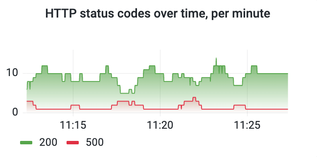

- Extract metrics from logs using Loki. Loki uses LogQL, a Prometheus-inspired query language to extract metrics from logs. Extracting metrics from logs and visualizing log messages in time series visualizations makes it easy and fast to get rich insight into the behavior of applications. As an example, the HTTP status codes over time panel is a metrics visualization created based on Tomcat access logs, using the following query:
sum by (status) (count_over_time( {job="tomcat-access"} | pattern
<> - - <> “!= "/metrics" [1m]))
- Find traces using logs with trace ID. As you have seen, you can pivot from logs to traces easily following the trace ID link. Using logs, you can search by path, status code, latency, user, IP, or anything else you can add onto the same log line as a trace ID. For example, you can easily filter the logs down to see only the traces that failed, exceeded latency SLAs, etc. This makes it much easier to troubleshoot issues when they do occur.
- Find all the logs for a given span. Spans contain links to associated logs. You can explore relevant logs associated with spans with just one click.
- Find traces from metrics using exemplars. When traces, logs, and metrics are decorated with consistent metadata, you can create correlations that were not previously possible. As you have seen from the Latency panel, Prometheus metrics are decorated with trace ID when OpenTelemetry is also used for tracing. When you jump from an exemplar to a trace, you are now able to go directly to the logs of the struggling service!
