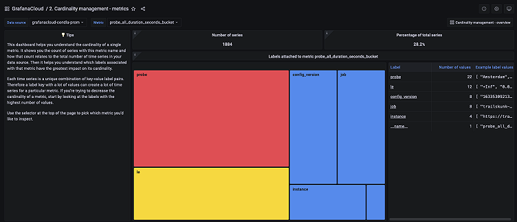

Metrics dashboard
This dashboard helps you understand the cardinality of an individual metric. At the top of the dashboard, you can select a data source and a metric you want to explore.
Grafana cardinality dashboards: Metrics dashboard.
Considering the example above with the HTTP status codes, you could potentially identify that the label that keeps track of the status code values is especially high and decide to act upon it as outlined above: keep, remove, or reduce.
