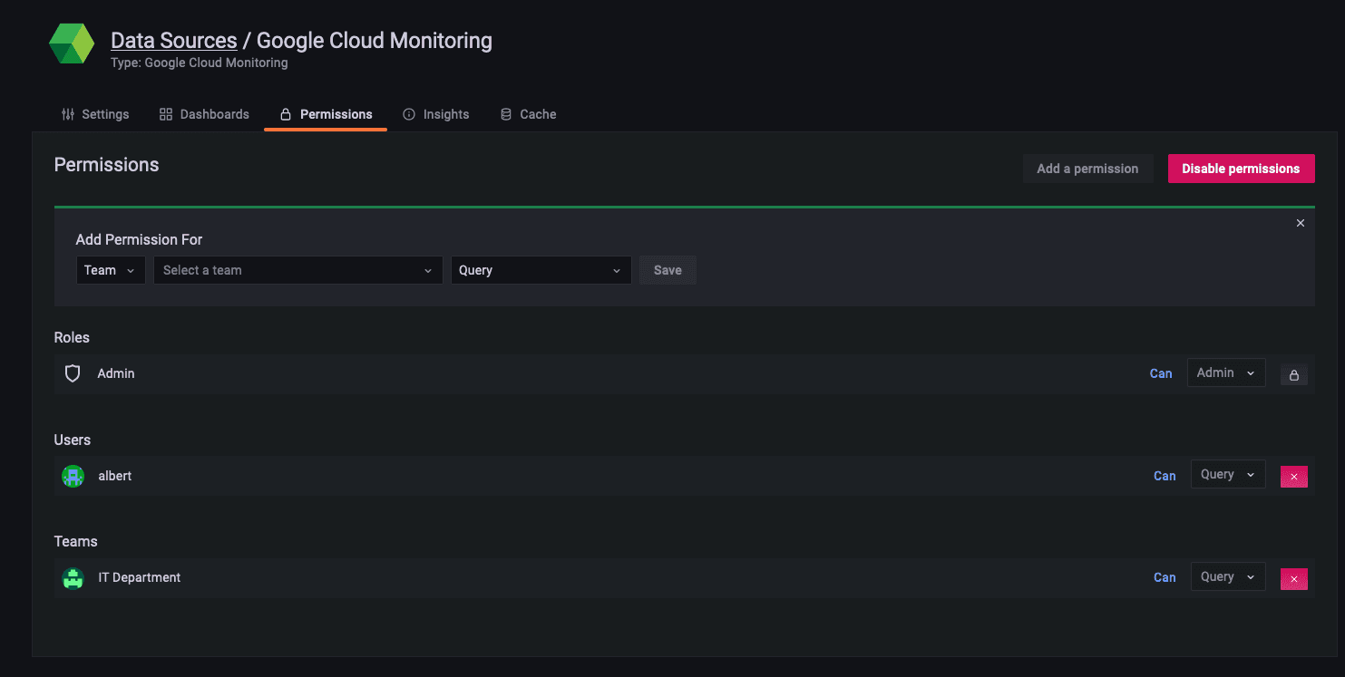

- One of the most important features is data source permissions. By default, any role could potentially access all data sources configured in Grafana with the same access level to the backend that is configured in the data source. Furthermore, any role, even the Viewer, could potentially randomly query these data sources. Data source permissions allow you to decide which user or team is able to query which data source and thereby help restrict the number and the groups of users who can access the data.
- Fine-grained access control (FGAC) is currently in beta and rapidly growing in features as well as constantly improving in regards to user experience. It allows you to create new roles and define a certain set of permissions for each of these roles. If the four default roles don’t meet your organization’s needs, you can assign every user individual fixed or custom roles to define exactly what they are allowed to do on a fine-grained basis. Examples from the documentation include giving certain users the ability to create reports or not allowing them to invite other users to use the Grafana instance. Grafana 8.3 added this functionality to the user interface, and Grafana 8.4 adds FGAC functionality to Grafana teams.
- I’ve already mentioned team sync in the authentication section. The value of keeping teams and Identity Provider groups in sync is that any user you add or remove to these external groups inherit the Grafana teams’ permissions and thereby keeps your efforts to manage these teams to a minimum.
In this data source permissions example above, only a user with the name “albert” as well as the users in the team “IT Department” have read access to data from the Google Cloud Monitoring data source.

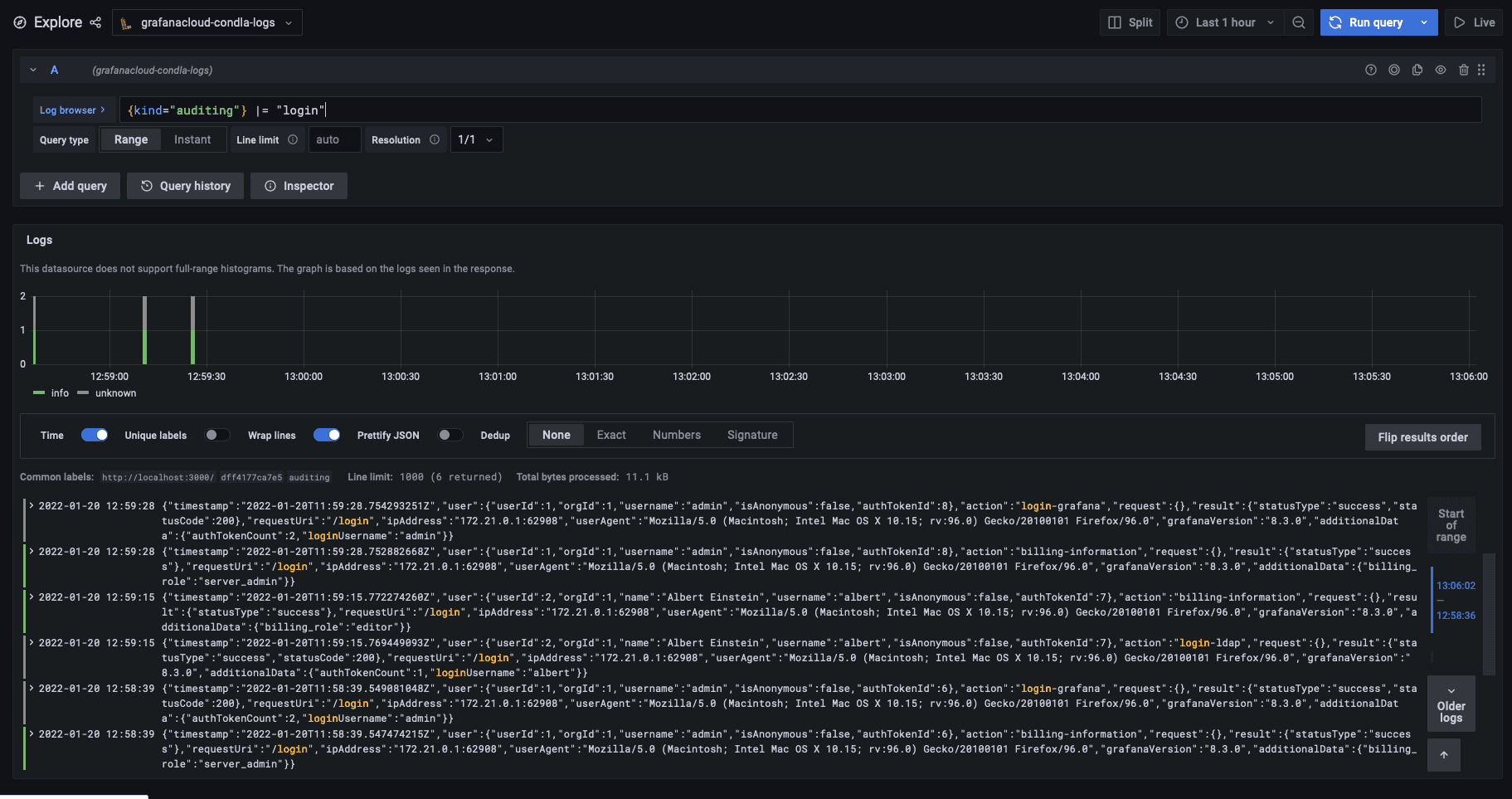

The audit capabilities are well integrated into Grafana itself. Here, you can see a simple Loki query to show the login events to the Grafana instance in the last hour.
