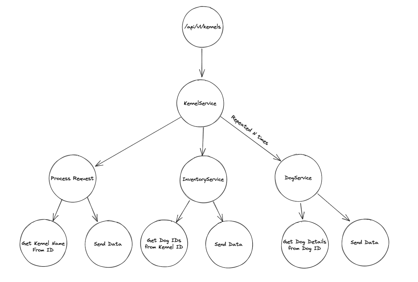

So, let’s start from the top. We are tasked with setting up tracing for the hypothetical company DogBook. One of our users, Floor, is trying to fetch a list of kennels as well as the dogs that live there using our API, in this case, /api/v1/kennels.
As her request is processed by the kennels endpoint, a root span is created. This span will contain timings for the full request, end-to-end. It will also serve as a container for all other spans created as part of the request.
For each subsequent operation, additional spans will be created and nested underneath their parent span. So in our example, the root span is created as the request reaches api/v1/kennels, and then, as we ask the kennel microservice for a list of kennels, another span will be created.

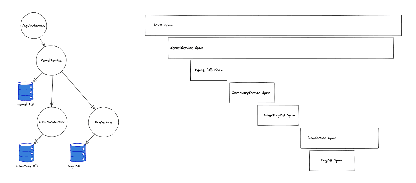

When the kennel microservice asks the dog microservice for the name of the dogs in that particular kennel, a third span will be created, and so on, forming a causal relationship model.
Embedded image
Maybe the diagram on the right looks a bit familiar? You’ve probably seen something similar before. While not exactly the same, most modern web browsers do something similar and use it in a similar manner, only the data presented is gathered in a somewhat different way.
Embedded image
In addition to being nestable, each span also holds instrumentation data and timings, which is what makes distributed tracing so powerful.

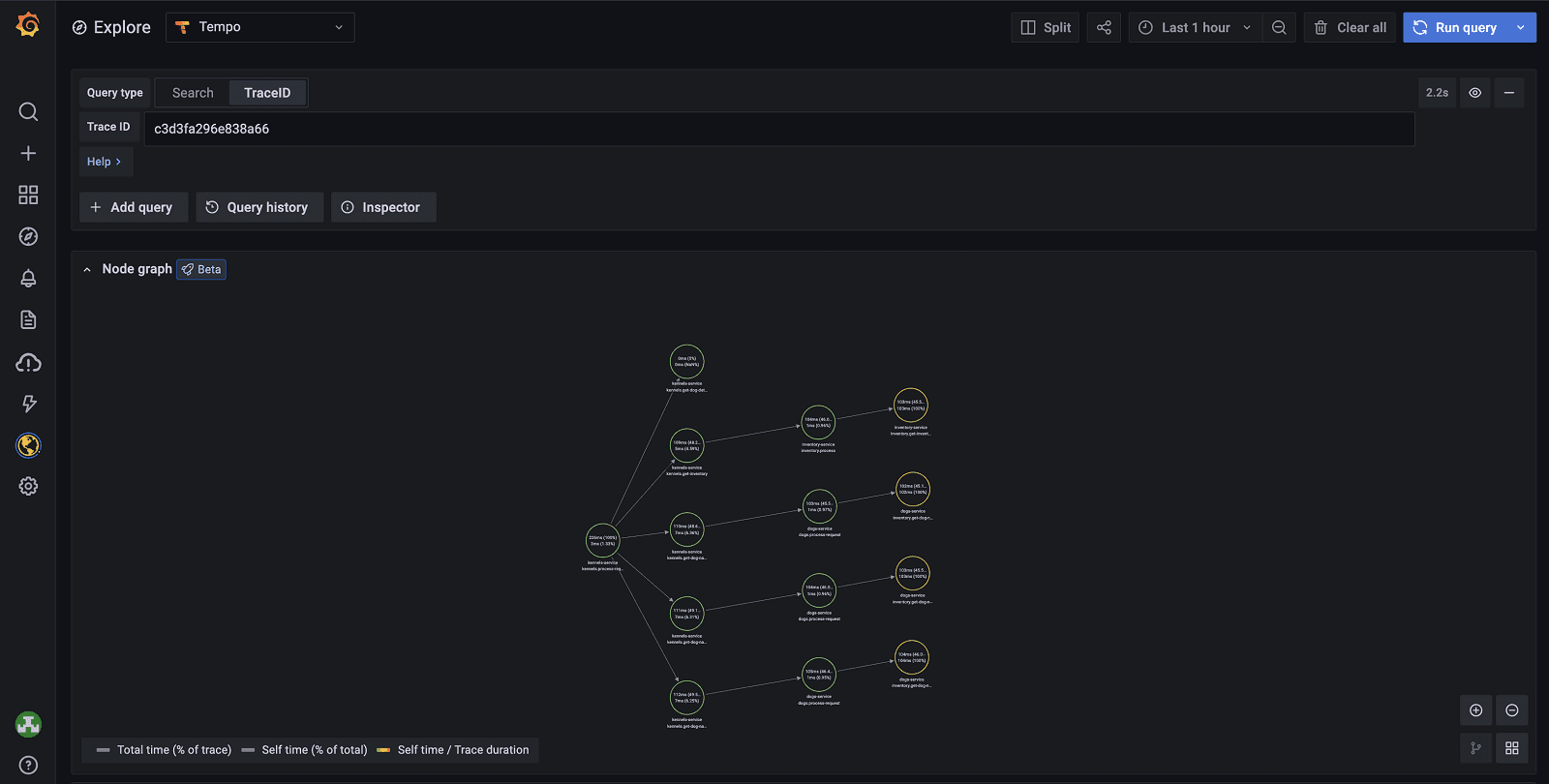

We’ll then do a request and check the logs for a trace id:
$ curl localhost "localhost/api/v1/kennels?id=2" && docker logs distributed-tracing-demo_kennels_1
INFO  Reporting span c3d3fa296e838a66:c3d3fa296e838a66:0:1

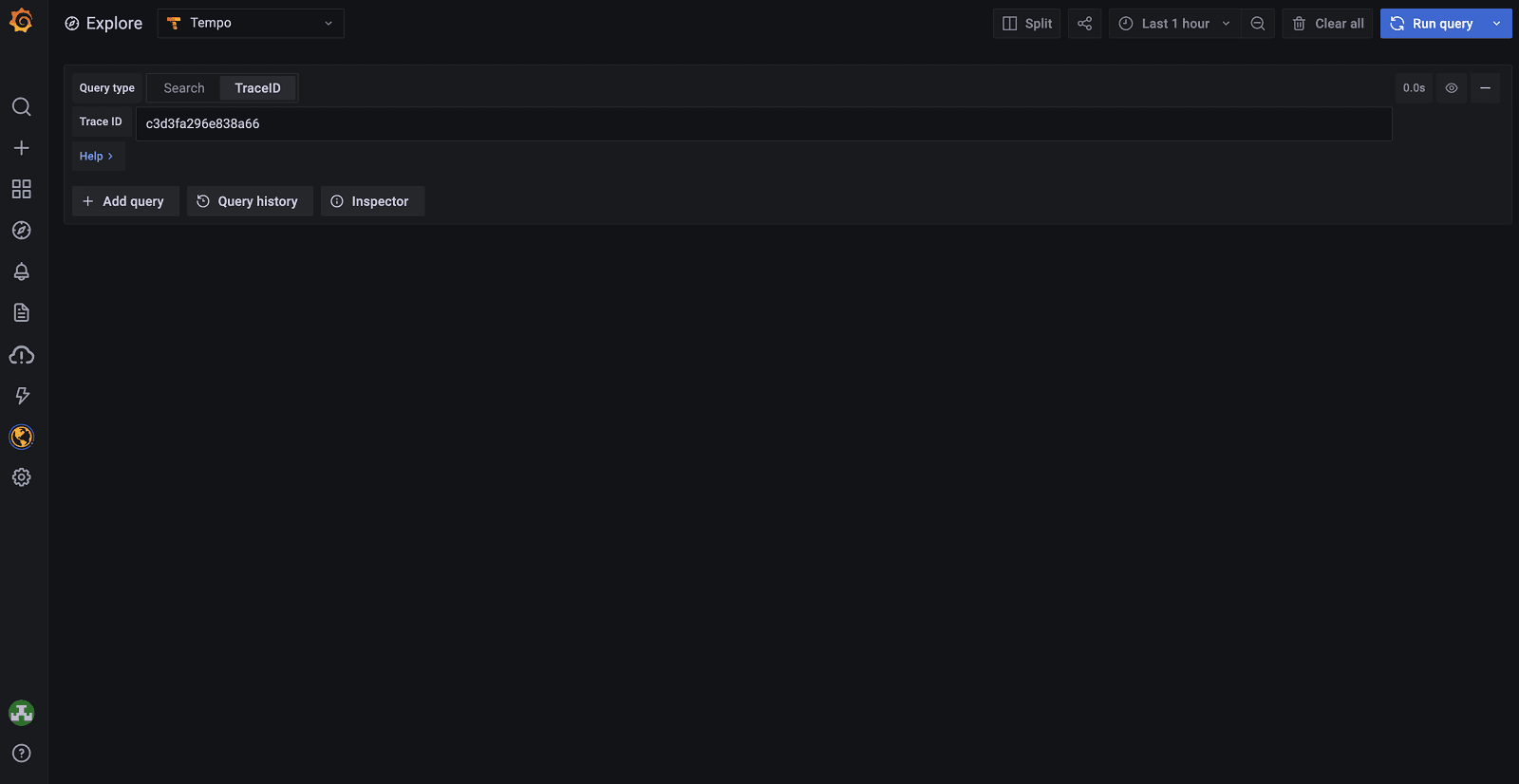

Let’s copy the first part of the span ID, c3d3fa296e838a66, which is the trace ID, and search for it in Grafana.
Embedded imageEmbedded image
All right, this is actually quite cool already! We’re able to see the causal relationship model we talked about earlier and what percentage of the execution time is used in each span.

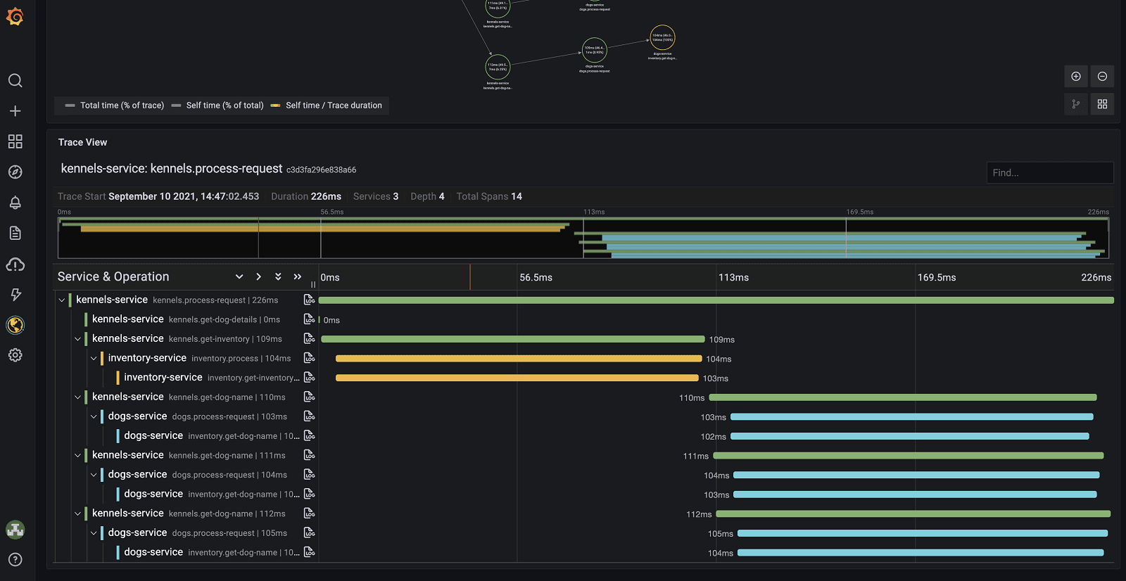

Embedded image
If we scroll a bit further down the page, we get the waterfall view of the same trace, with the ability to drill down further into the details and inspect things like tags, logs, etc.
