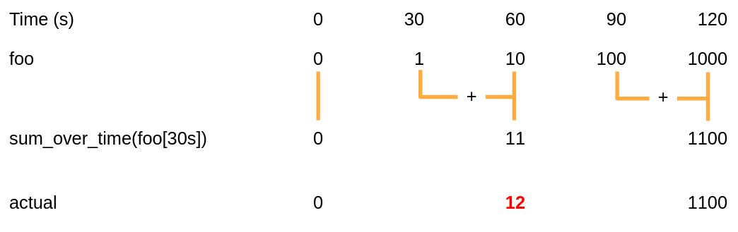

Trying different sample values in the failing test, I started to notice a pattern.
For example, with the sample values [0, 1, 10, 100, 1000] loaded at 30-second intervals and the same query and step as the previous example, the result at 60 seconds was 12 instead of 11.
The second sample in the series was being double-counted. For this example, the sample at 30s (with value 1) was double-counted, leading to the result at 60s being 1+1+10=12 instead of 1+10=11.
Going back to the initial example, the sample at 30s (with value 10) was double-counted, leading to the result at 60s being 10+10+15=35 instead of 10+15=25.

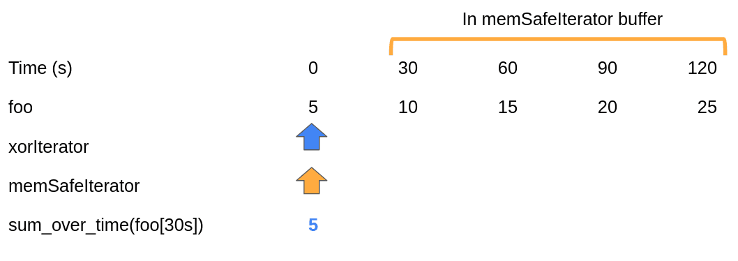

At the start, both the internal xorIterator and memSafeIterator are pointing at the initial sample at 0s. To evaluate the sum_over_time() query at 0s, the sample value at 0s is read. Since that sample is not in the buffer, the result of the internal iterator is used (i.e., 5).

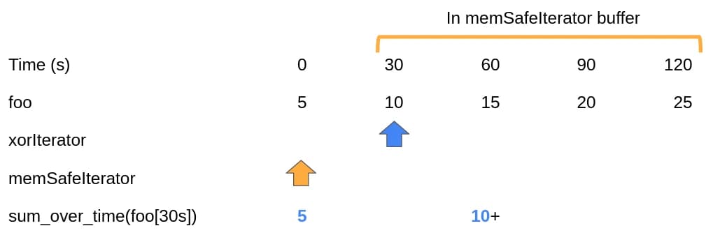

Then the query is evaluated at 60s. This means that all the sample values from 30s to 60s are summed. The Seek() method is called to move to the earliest sample in that time range (in this case the sample at 30s). With the bug, only the internal iterator updates its current sample to the one at 30s. memSafeIterator remains at the 0s sample.
memSafeIterator does not think it has reached its buffer, so when reading the current sample, it uses the result from the internal iterator instead. The internal iterator returns 10 as the first value in the time range.

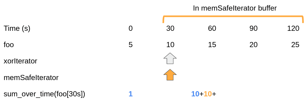

As the end of the time range hasn’t been reached, Next() is called to get the following sample. This causes memSafeIterator to advance to the sample at 30s. It detects that it has reached the buffer, and therefore stops reading from the internal iterator. Instead, the 30s sample value is read again, but this time from the buffer.

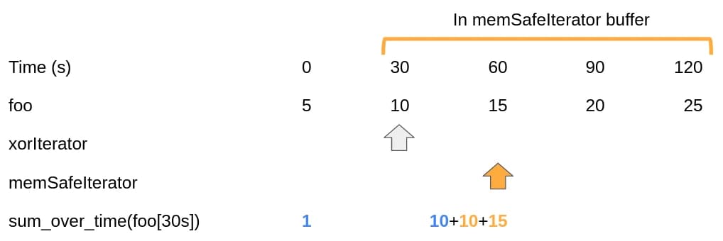

Next() is called again, advancing the memSafeIterator to the last sample in the current time range, the 60s sample, which has a value of 15.
Summing up the collected sample values (10+10+15), we get the incorrect answer of 35.
