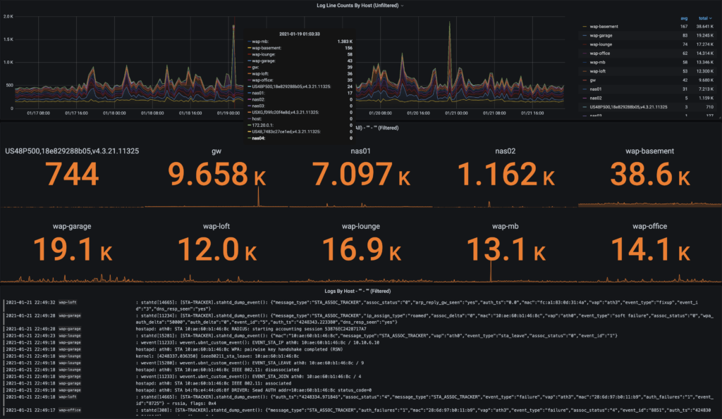

The relabeling in Promtail takes the hostname of the device sending messages into syslog-ng and turns it into a host label for Loki to index. Within a few minutes, I had all of my hosts streaming syslog from my network into Loki, and it was explorable within Grafana!

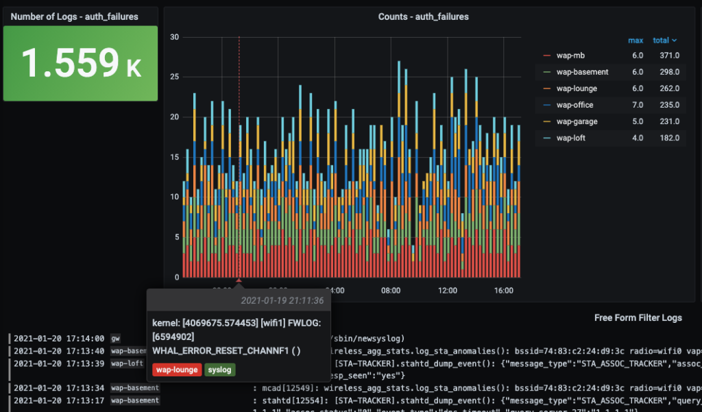

I returned to my effort to build out a dashboard, taking all of my (now easily gathered) device logs and applied the “logs to metrics” magic recently released with Loki. The net result was group summary counts over time by wireless access points!
This was my first LogQL query that started my logs to metrics journey:
count_over_time({host=~"$hostname", job="syslog"}[$__interval] |="$filter”)
And this example below is showing the number of logs over time filtered by hostname ($hostname) coming from my syslog Promtail job (syslog) with a freeform search query string from my Grafana variable ($filter) auth_failures.
Embedded image
With a bit more dashboard tweaking, I was able to visualize other types of syslog messages from some additional network devices, such as my network gateway, my server IPMI stats, and NAS details. I could now scroll back through my log history, which up until that point was invisible to me. I also had a way of visually understanding the frequency and type of messages being collected, as well as an easy way to free-text filter all of my logs. Truly, logs AND metrics!
