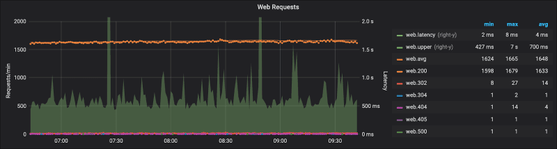

You’re troubleshooting performance issues, and you want to know whether an increase in traffic has a negative effect on latency. You set up your graph so that the left axis displays the traffic, and the right axis displays the latency.
In the graph below, the number of requests are encoded as points, while latency is shown as a line fill. From this, we’re able to tell that even with consistent traffic at ~1600 requests per minute, several requests are taking longer than 2 seconds.

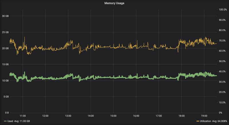

The example below displays absolute memory usage in bytes on the left axis, and relative usage in percent on the right axis.
This allows you to maximize the vertical resolution of visualizing absolute use while allowing you to see how much that’s relative to available resources at a glance.
Embedded image
If you only monitor a single machine, you can accomplish the same thing by setting the Y-max on the left axis to the total memory installed on that machine. In a cluster of machines with different memory configurations, however, you might not be able to set a single Y-max for all resources.

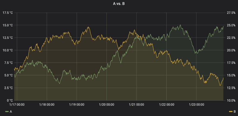

While dual axis graphs can be helpful, they’re unfortunately not very intuitive and are devilishly easy to misuse. By having too much information in your graphs, you risk obscuring your message. With dual axes, that risk is even greater. For example, since you’re essentially drawing two graphs on top of each other, it can be unclear which series belongs to which axis.

Align baselines
Since both the scale and baseline of each axis can vary independently from the other, they can tell vastly different stories for the same dataset, essentially manufacturing a correlation where there is none.
For example, by changing the scale and baseline, it can look like the two series are increasing at the same rate. By tweaking the scales, you can make the graph fit almost any narrative.
(For more information on the dangers of dual axes, check out this blog post: Why not to use two axes, and what to use instead.)
So be careful when using dual axis charts. Since both the magnitudes and the minimum values of each axis can be set arbitrarily, they can easily become misleading.
One way to reduce ambiguity is to align the axes to 0: Under Visualization settings -> Axes -> Y-axis, enable Align.
