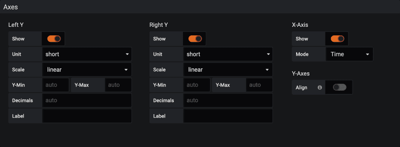

You’re done setting up your first graph panels in Grafana. You want to do more, look around the visualization settings, and discover the settings for the X and Y axes. You stumble over the configuration for a “Right Y” axis. You ask yourself, “Why on earth would I need another Y axis?”
![Right Y settings Right Y settings](/static/assets/img/blog/right-y.png)
You toggle it back and forth and change some settings, yet that makes no difference to your graph. What gives?

To create a dual axis graph, start by assigning a time series to the right Y axis:
- In the panel legend, click the colored line next to the name of the time series.
- In the Colors pop-up, click the
Y-Axis
tab, and enableUse right y-axis
The panel moves the legend for the series to the right side and draws the right Y axis. You can also individually configure the unit and range of each axis.

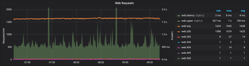

You’re troubleshooting performance issues, and you want to know whether an increase in traffic has a negative effect on latency. You set up your graph so that the left axis displays the traffic, and the right axis displays the latency.
In the graph below, the number of requests are encoded as points, while latency is shown as a line fill. From this, we’re able to tell that even with consistent traffic at ~1600 requests per minute, several requests are taking longer than 2 seconds.

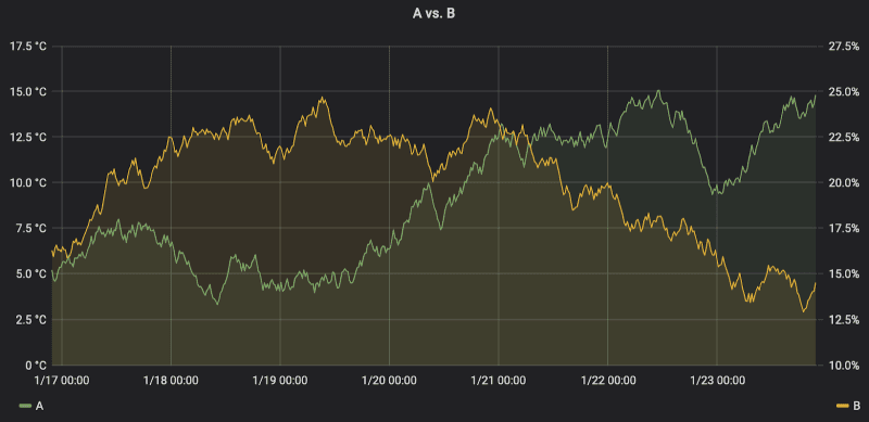

Since both the scale and baseline of each axis can vary independently from the other, they can tell vastly different stories for the same dataset, essentially manufacturing a correlation where there is none.
For example, by changing the scale and baseline, it can look like the two series are increasing at the same rate. By tweaking the scales, you can make the graph fit almost any narrative.
(For more information on the dangers of dual axes, check out this blog post: Why not to use two axes, and what to use instead.)
So be careful when using dual axis charts. Since both the magnitudes and the minimum values of each axis can be set arbitrarily, they can easily become misleading.
One way to reduce ambiguity is to align the axes to 0:
