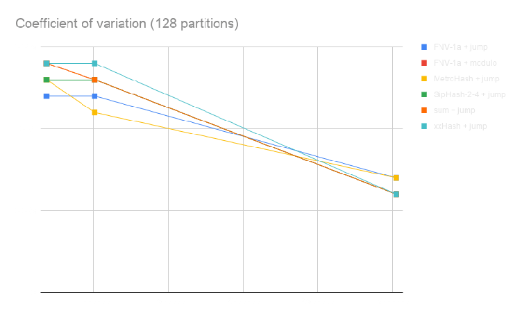

We then tested these functions on 3 production datasets of sizes ranging from half a million to millions of items, testing with 32 and 128 partitions, and computing each time:
- The coefficient of variation – which is the ratio of the standard deviation to the mean (an excellent measure of variation!) – of the number of metrics per partition.
- The percentage difference between the minimum number of metrics in a partition and the maximum number of metrics in a partition.
For both criteria, a lower value means a more even distribution of the data across partitions.
We plotted the results for 128 partitions only because they were very similar for 32 partitions:
%3Aquality(100)%2F&w=3840&q=75)
All functions behave quite similarly; however, sum + jump and FNV-1a + jump are much more costly on CPU.
xxHash + jump is very competitive on both criteria when the amount of data increases and is cheaper on CPU than all the other functions.
