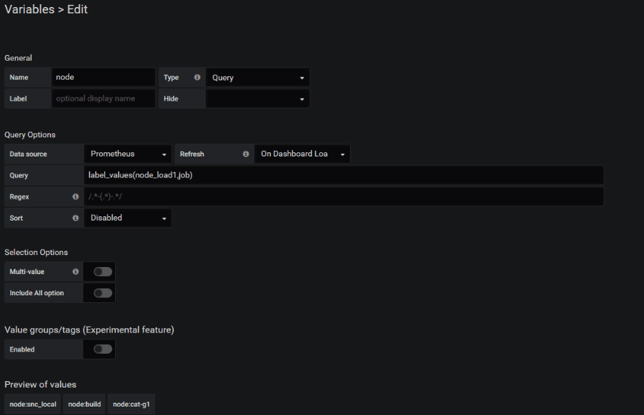

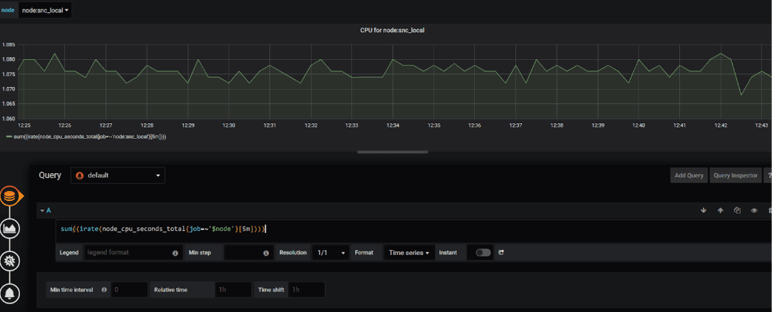

First, let’s create a simple dashboard with a working variable in it.
Simple dashboard
Simple dashboard
Variables edited
Variables edited
Variables edited dashboard
I also created a few edits to the dashboard, so we can see how versioning works. More on that later.

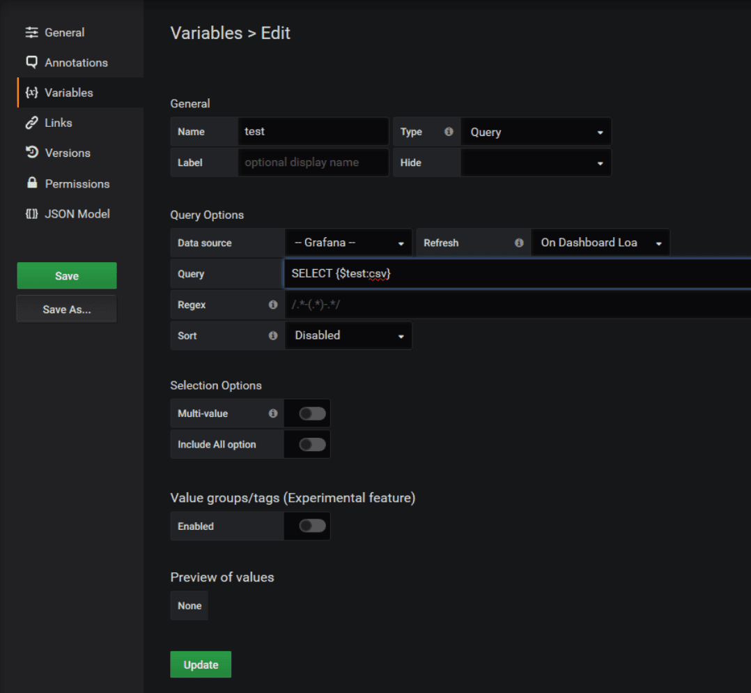

Now let’s break the dashboard by adding a self-referencing variable.
Variables broken
Variables broken

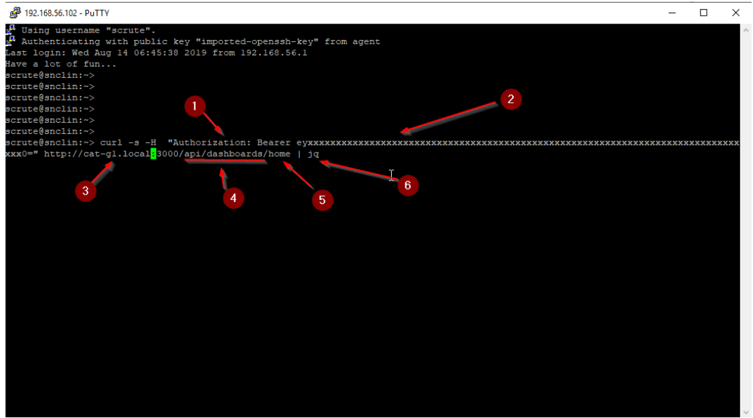

Let’s dissect that curl command line.
Variables dissecting curl command
  1. The preamble you need in the authorization header
  2. The API key you just generated (obviously this has been obfuscated)
  3. The URL of my test grafana server
  4. The API call URl. These are all documented
  5. The parameter sent to the API call
  6. Pipes the output through jquery, so we can coloured formatting etc.
If you’re doing a lot of API calls from the command line, it may be useful to create a small shell script to run CURL instead.
The output of this command is actually the JSON describing your home dashboard, so we’ve nearly got access to what we want already.
