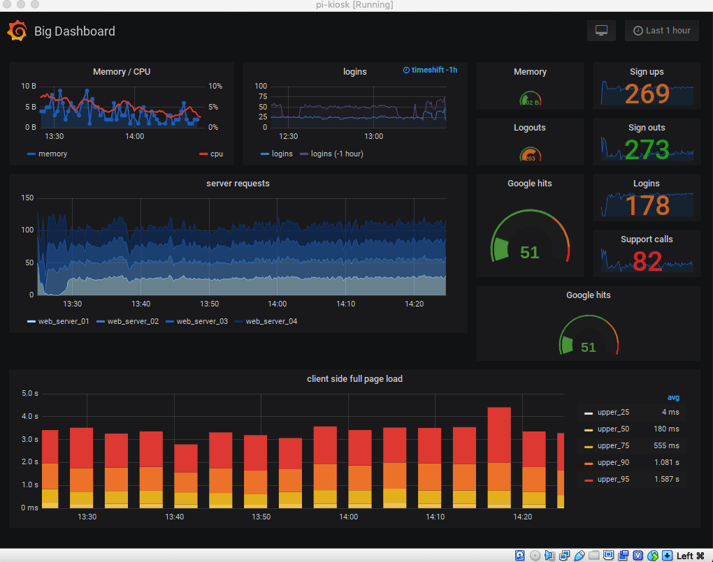

A kiosk displaying the default dashboard on https://play.grafana.org in full screen:

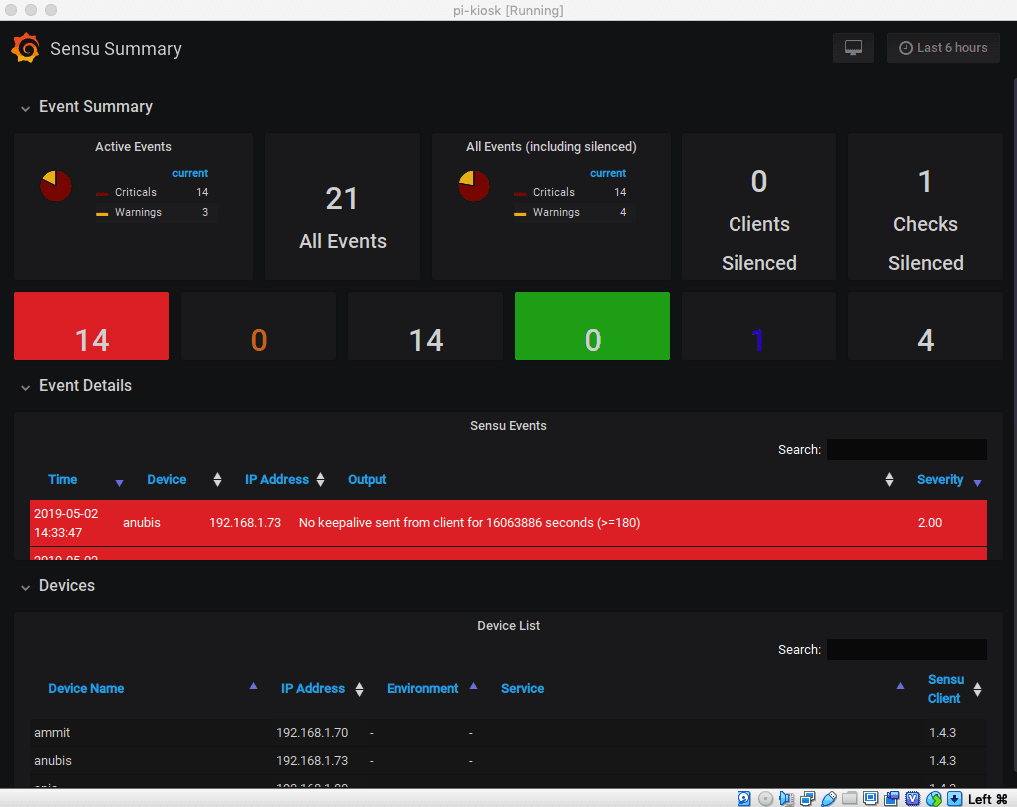

A kiosk displaying a specific dashboard on https://play.grafana.org in TV mode:

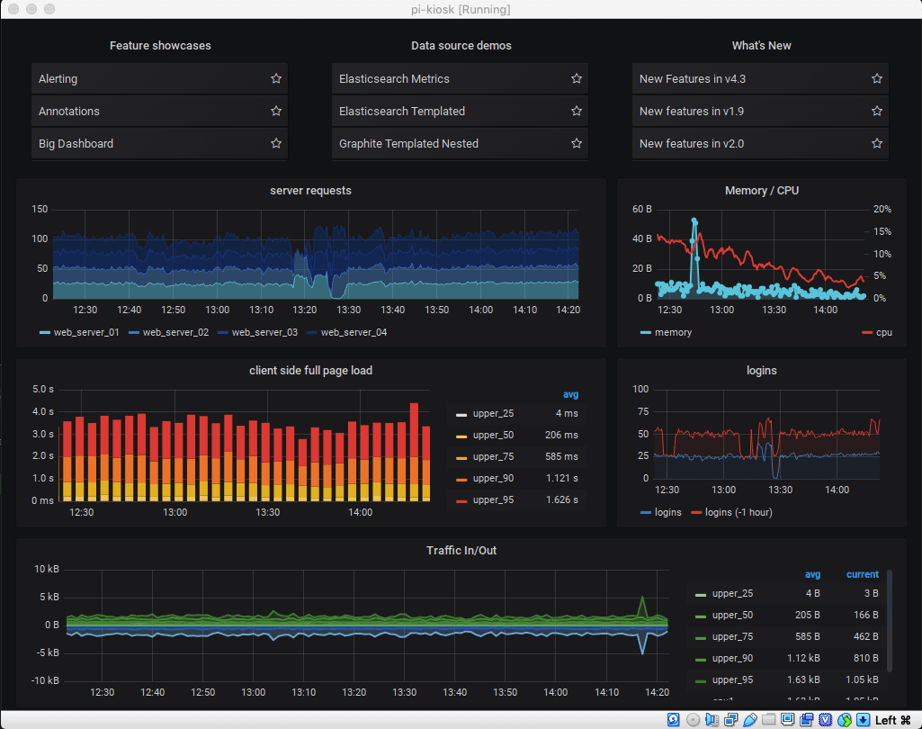

A kiosk displaying another dashboard on https://play.grafana.org in normal mode:

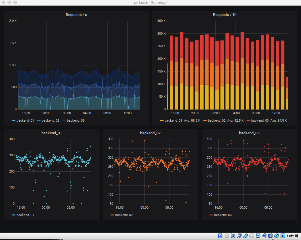

A kiosk with a playlist running on https://play.grafana.org in full screen:

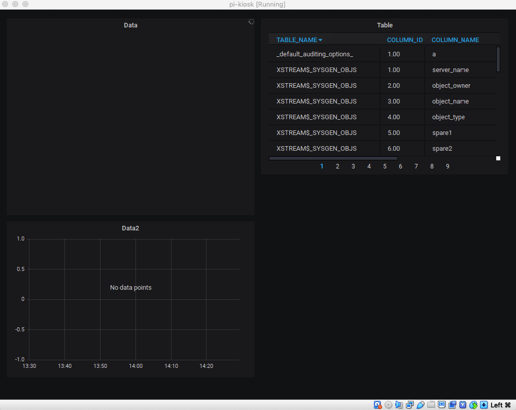

A kiosk using Hosted Grafana login:

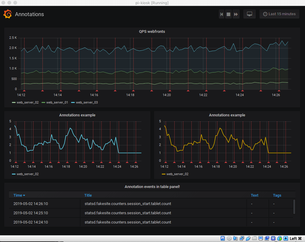

A kiosk using local login:
