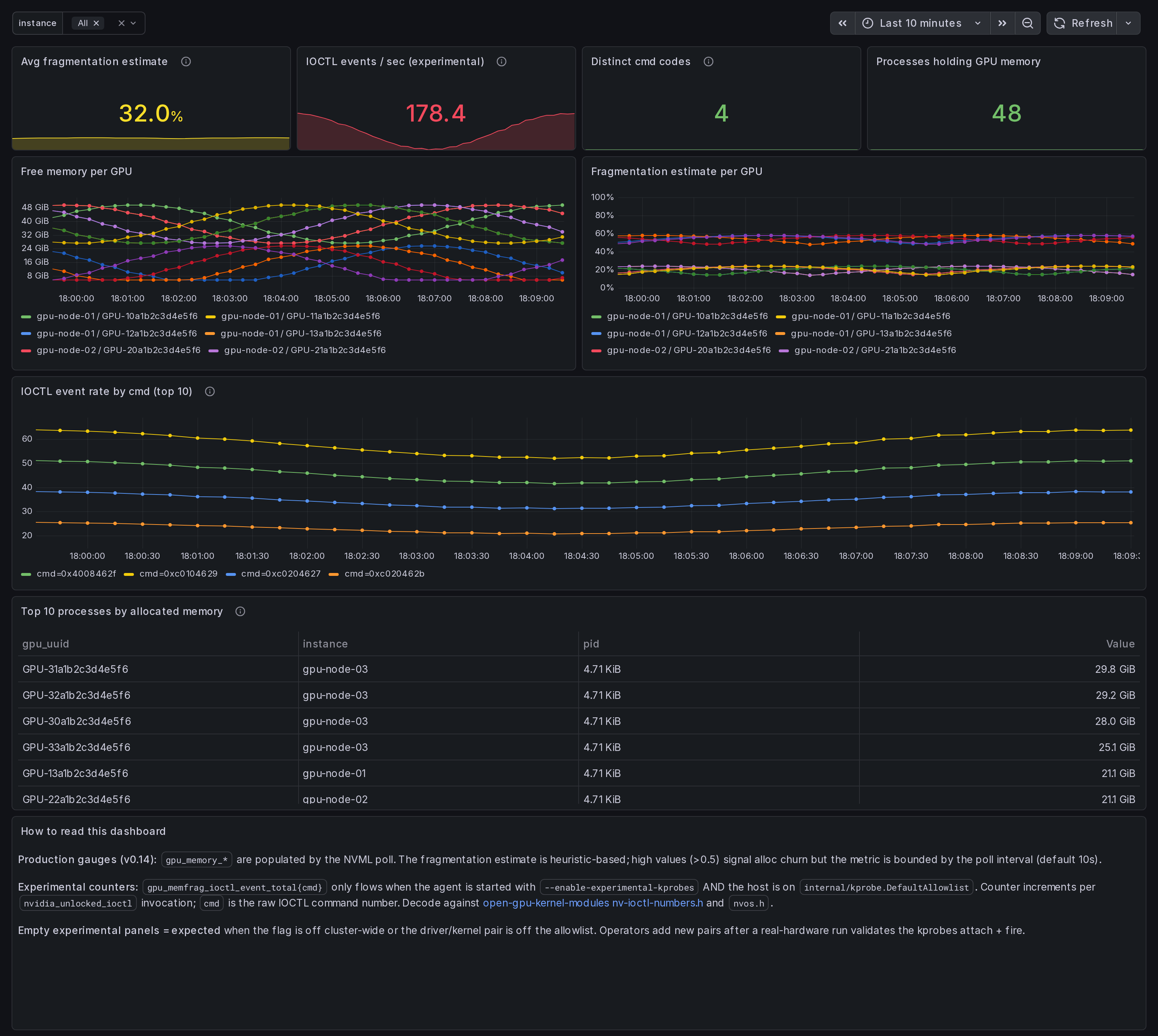

What this dashboard shows
A multi-node NVIDIA GPU memory fragmentation view. For the "my GPU is half-empty but allocations fail" debugging case across a cluster.
The headline panels:
  • Avg fragmentation estimate - across selected GPUs. Heuristic: 1 - (largest free block / total free). 0 = unfragmented; 1 = fully fragmented.
  • Free memory + fragmentation per GPU - time series. Spikes correlate with alloc churn (DataLoader rebuilds, optimizer state shuffles, KV-cache reset).
  • IOCTL events / sec + distinct cmd codes - aggregate signal from the experimental memfrag IOCTL kprobe. Higher rate
    • more diverse cmd codes = more memory operations underway.
  • Top 10 IOCTL events by cmd - per-cmd time series. Decode cmd values against nv-ioctl-numbers.h and nvos.h from NVIDIA's open-gpu-kernel-modules repo to map raw codes to RM operation kinds.
  • Top 10 processes by allocated memory - from gpu_memory_process_allocated_bytes.
Linux only. amd64 + arm64 agents.

How to read the heuristic
The fragmentation estimate is a coarse signal. Values above ~0.6 across multiple sequential polls usually correlate with:
  • Alloc / free churn (DataLoader workers, KV-cache reset)
  • Mixed-size allocator pressure (a single PyTorch process running variable-batch inference, or a Triton server hot-reloading models)
  • Driver-side fragmentation that survives cudaMemPool trimming
For the actual allocator-level signal (per-cmd IOCTL volume), turn on --enable-experimental-kprobes and watch the bottom panel.
