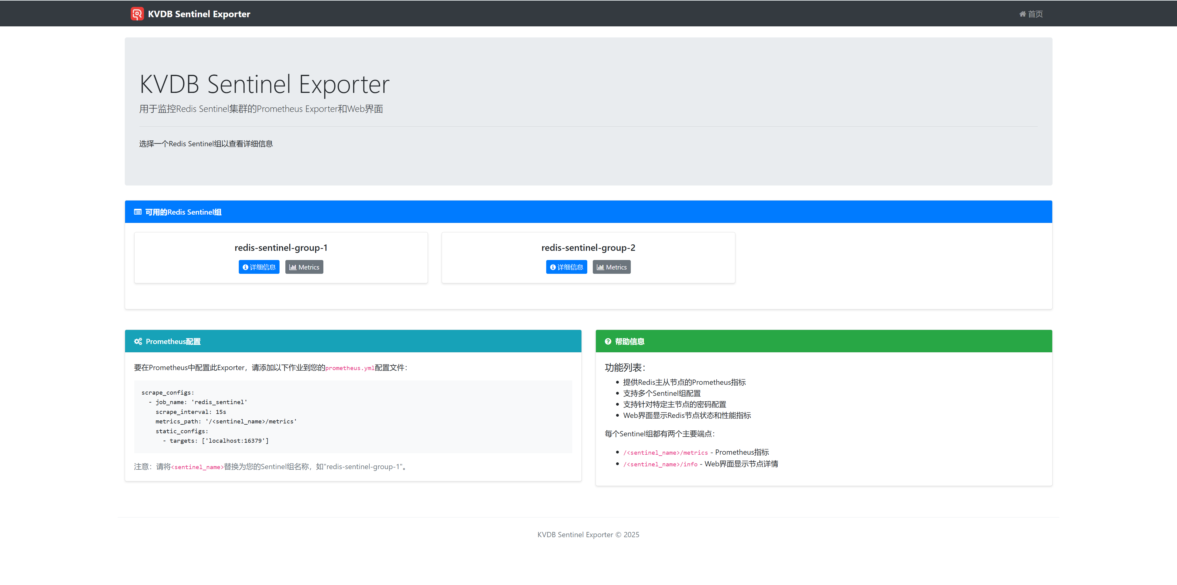

Index Page

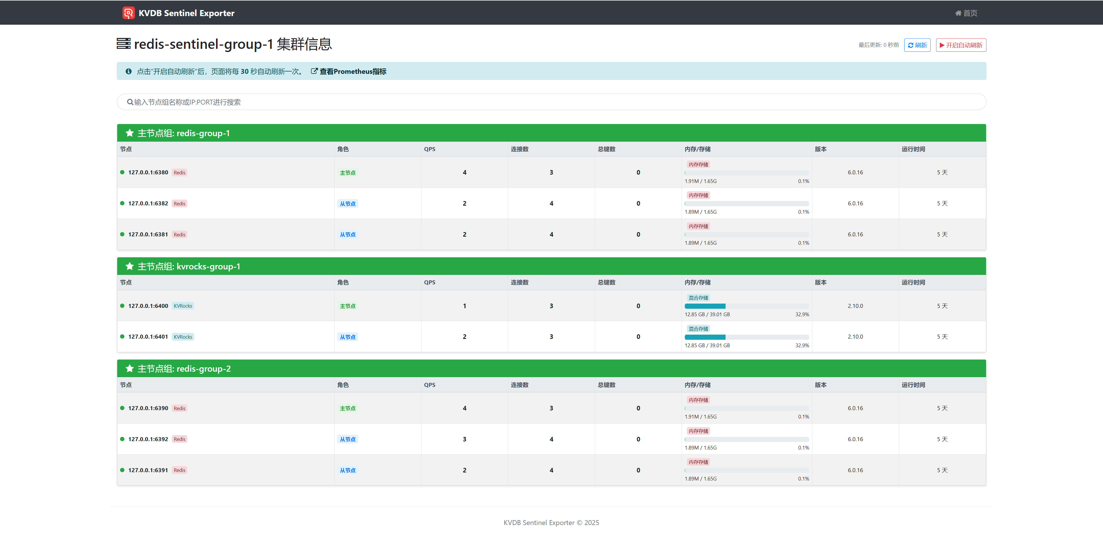

Info Page

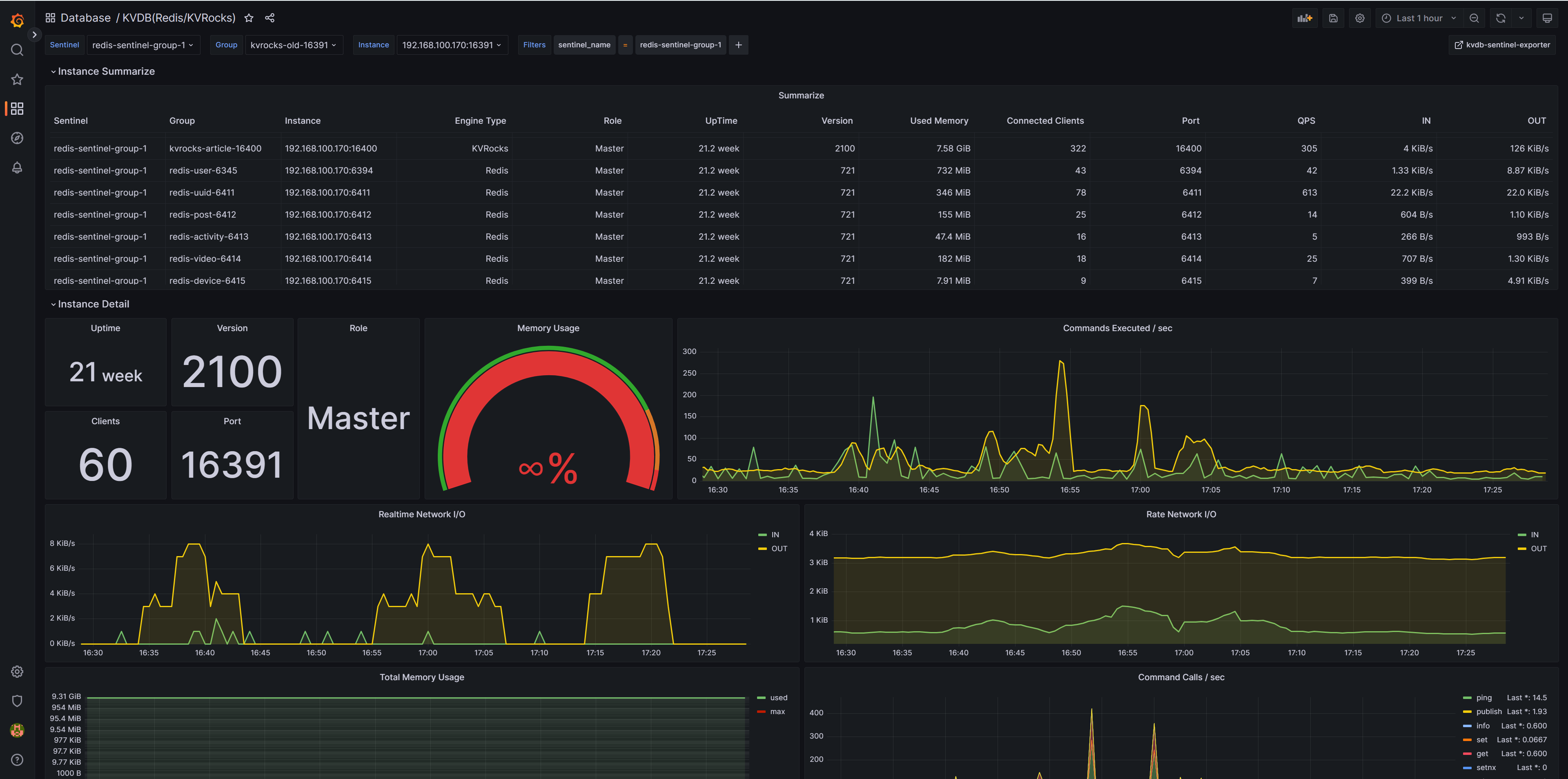

Grafana Metrics Page
