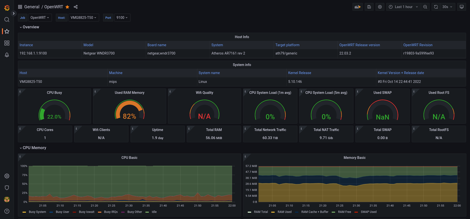

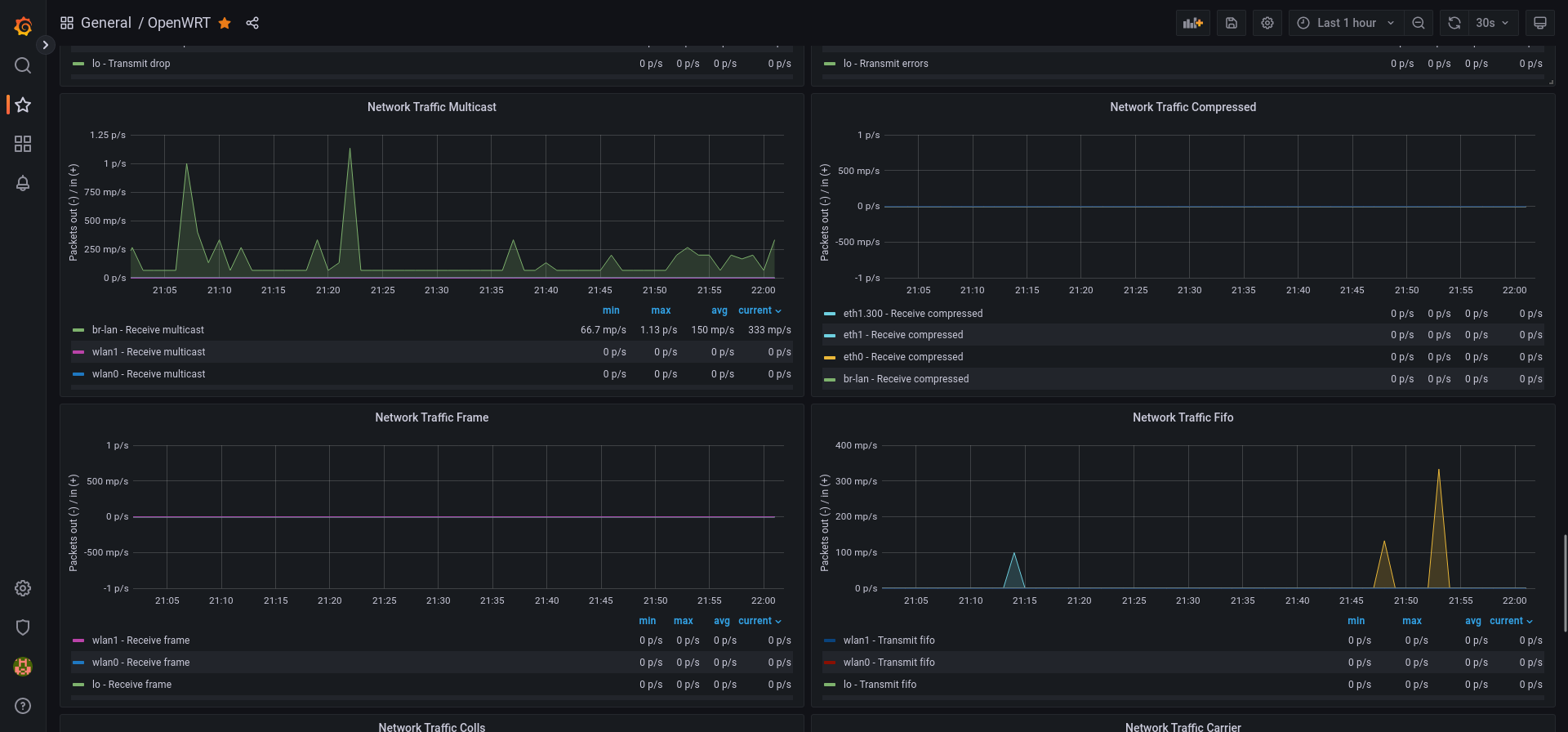

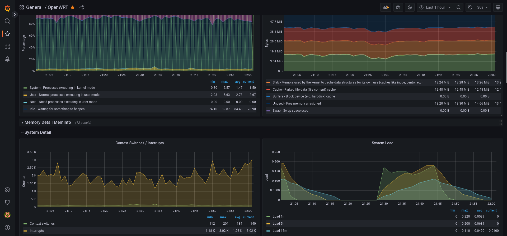

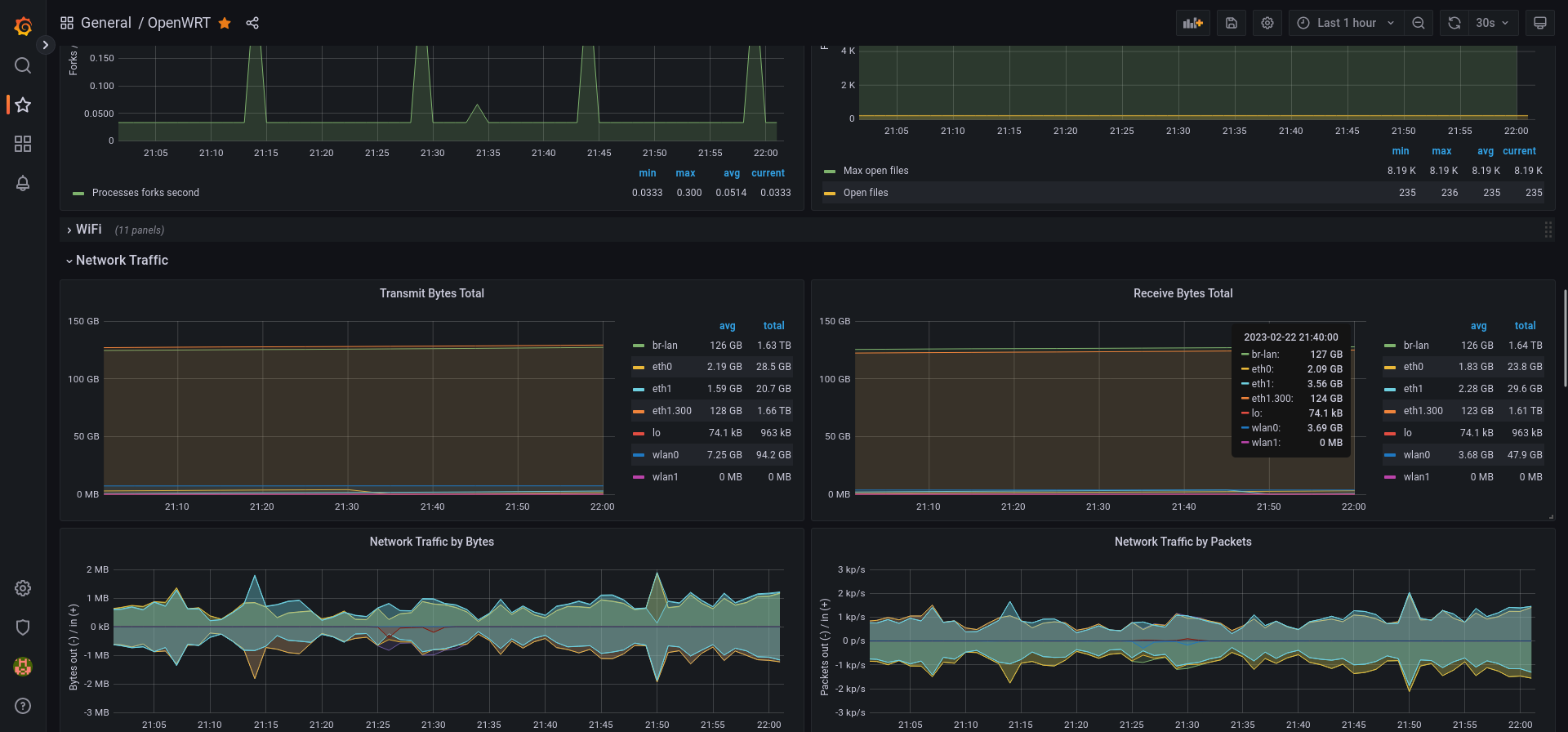

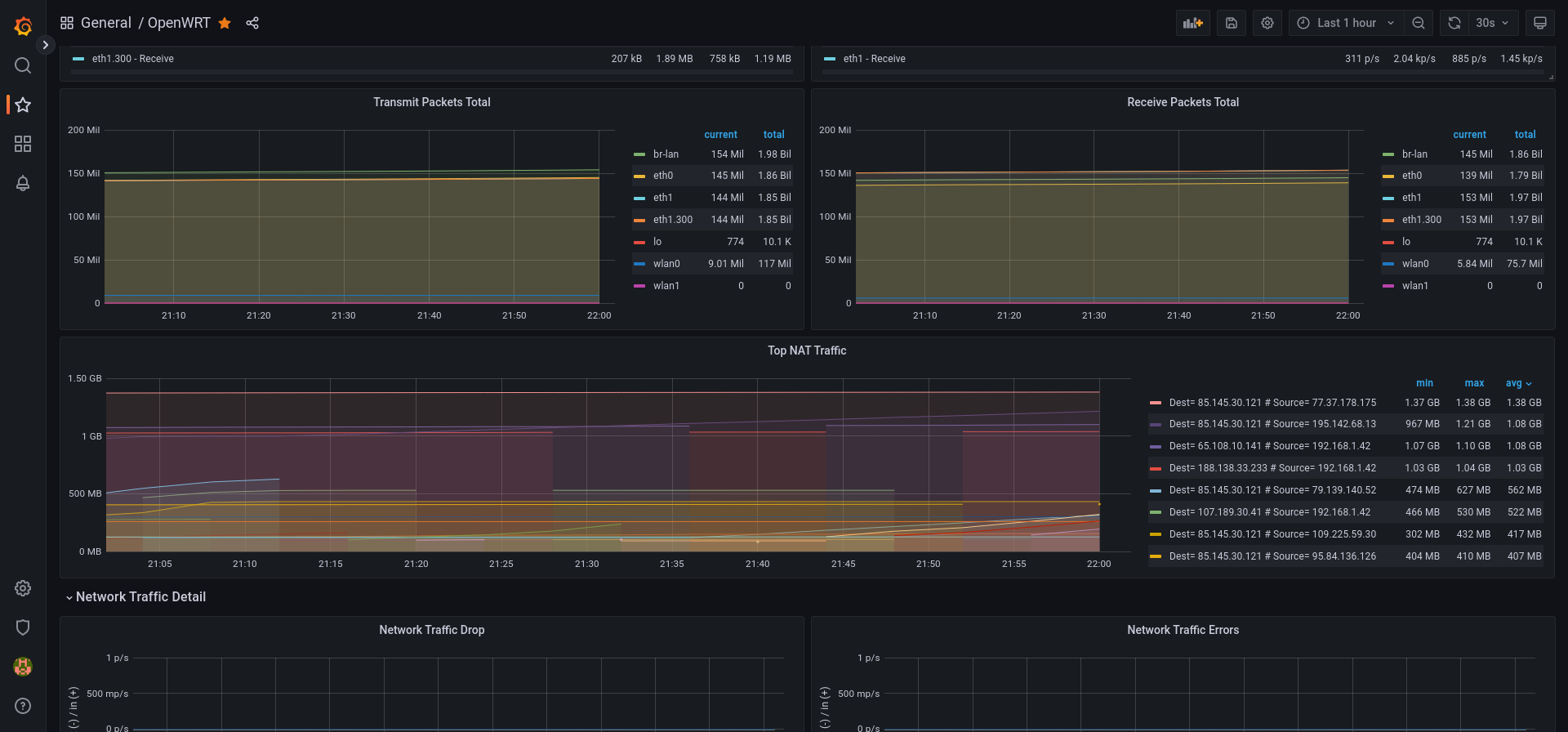

Dashboard for OpenWRT routers with installed Prometheus lua exporter scripts.
OpenWRT screenshot 1
OpenWRT screenshot 2
OpenWRT screenshot 3
OpenWRT screenshot 4
OpenWRT screenshot 5
