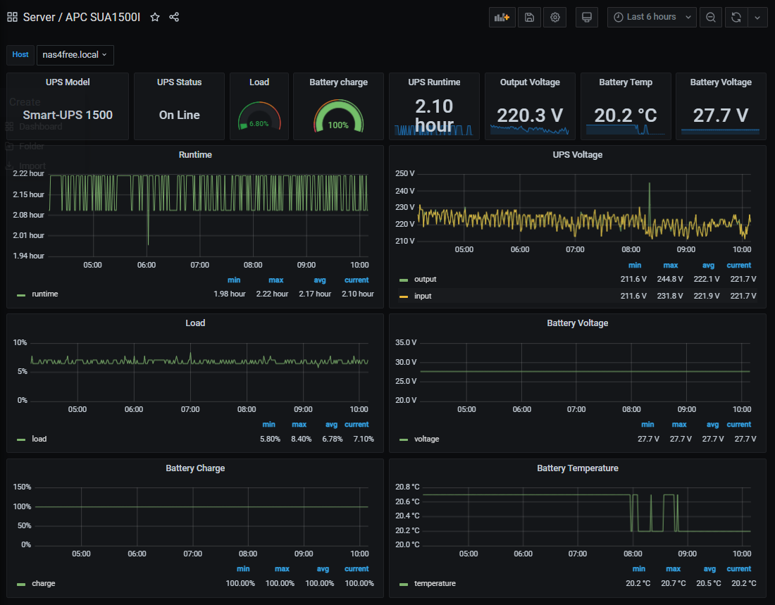

APC SUA1500I for XigmaNAS
Smart-UPS APC SUA1500I created for XigmaNAS
