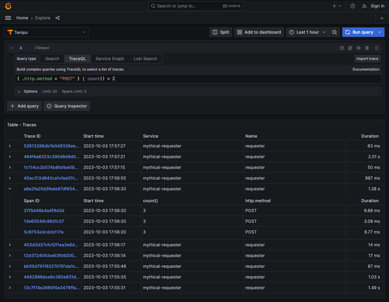

TraceQL queries in Grafana Explore
You can use the TraceQL query editor and query builder in the Tempo data source to build queries and drill-down into result sets. The editor and builder are available in Grafana’s Explore interface. For more information, refer to Write TraceQL queries in Grafana.

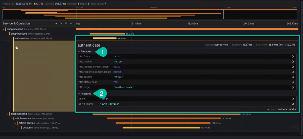

There are two types of attributes: span attributes and resource attributes. By expanding a span in the Grafana UI, you can see both its span attributes (1 in the screenshot) and resource attributes (2 in the screenshot).
Attribute fields are derived from the span and can be customized. Process and span attribute types are defined by the attribute itself, whereas intrinsic fields have a built-in type. You can refer to dynamic attributes (also known as tags) on the span or the span’s resource.
Attributes in a query start with a span scope (for example, span.http) or resource scope (for example, resource.namespace) depending on what you want to query. This provides significant performance benefits because it allows Tempo to only scan the data you are interested in.
To find traces with the GET HTTP method, your query could look like this:
{ span.http.method = "GET" }For more information about attributes and resources, refer to the OpenTelemetry Resource SDK.

{ span.http.status_code = 200 } | count() > 3Grouping
TraceQL supports a grouping pipeline operator that can be used to group by arbitrary attributes. This can be useful to find something like a single service with more than 1 error:
{ status = error } | by(resource.service.name) | count() > 1Arithmetic
