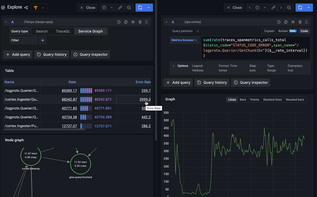

Error rate example
Let’s say you want to learn more about why cortex.Ingester has the highest error rates. Selecting the second row of the Error rate column displays details about the span metrics in a new window on the right side.
Error rate example

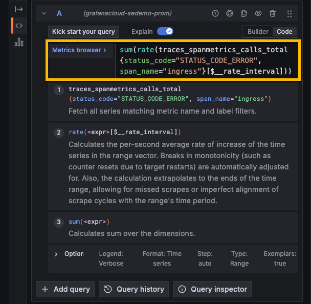

The metrics query used to generate the data appears in the Metrics browser field.
Error example query editor

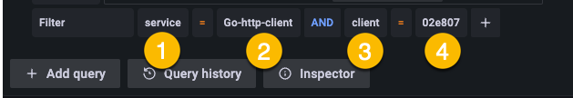

Each field or label represents a key-value pair. Number 1 selects a service as the label whose value is Go-http-client (2). The second key-value pair has a client as a label whose value is 02e807.
Filter example with numbers
