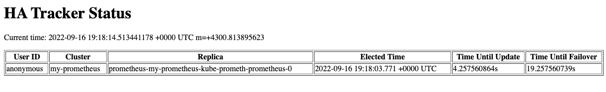

ha_tracker’s page
Port forward Mimir distributor service. The argument after port-forward must match your Mimir’s distributor name.
bash
kubectl -n <mimir-namespace> port-forward service/mimir-distributor 8080:8080
You can use the following command to get the distributor name:
bash
kubectl -n <mimir-namespace> get service | grep distributor
Open http://localhost:8080/distributor/ha_tracker in a browser. You should see the output similar like the following. If the table is empty, it means there is something wrong with the configuration.
HA Tracker status

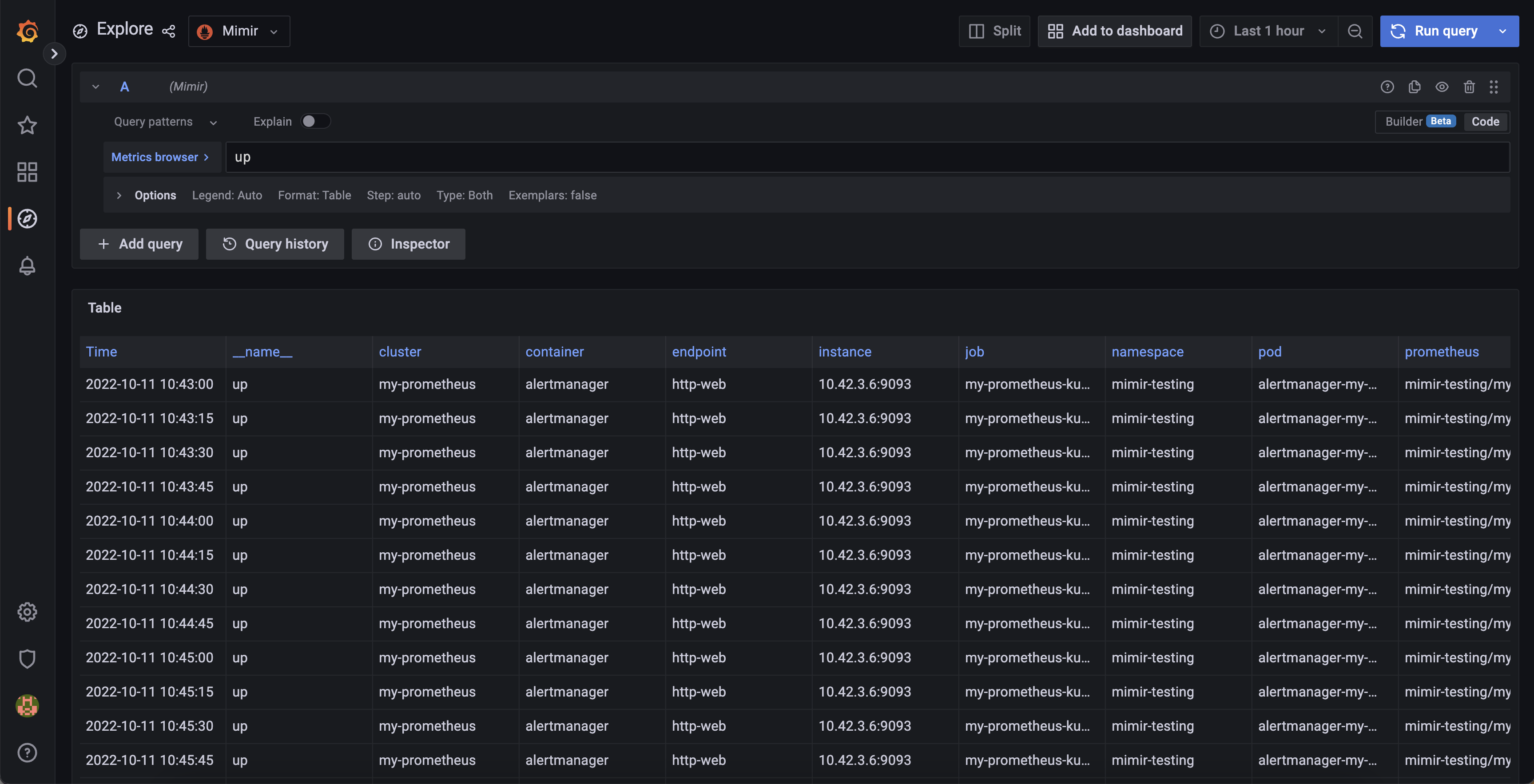

Ensure HA metrics are deduplicated
Go to Grafana explore page and select Mimir datasource. Then execute the following query: up. In the Options drop down, select Format = Table. In the result you can see the several time series with different labels.
Verify deduplication
The most important thing is you will not find __replica__ label (or any label that you set in ha_replica_label config) anymore. This means you have configured the deduplication successfully.
