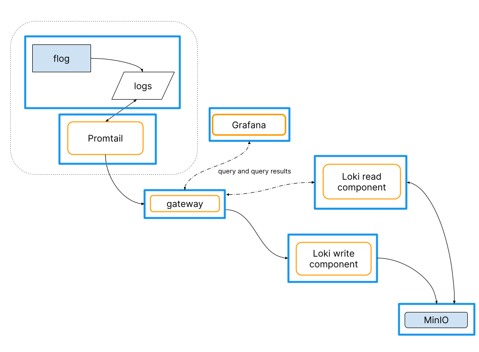

This guide assists the reader to create and use a simple Loki cluster. The cluster is intended for testing, development, and evaluation; it will not meet most production requirements.
The test environment runs the flog app to generate log lines. Promtail is the test environment’s agent (or client) that captures the log lines and pushes them to the Loki cluster through a gateway. In a typical environment, the log-generating app and the agent run together, but in locations distinct from the Loki cluster. This guide runs each piece of the test environment locally, in Docker containers.
Grafana provides a way to pose queries against the logs stored in Loki and visualize query results.
The test environment uses Docker compose to instantiate these parts, each in its own container:
- One single scalable deployment mode Loki instance has:
- One Loki read component
- One Loki write component
- Minio is Loki’s storage back end in the test environment.
- The gateway receives requests and redirects them to the appropriate container based on the request’s URL.
- Flog generates log lines.
- Promtail scrapes the log lines from flog, and pushes them to Loki through the gateway.
- Grafana provides visualization of the log lines captured within Loki.
