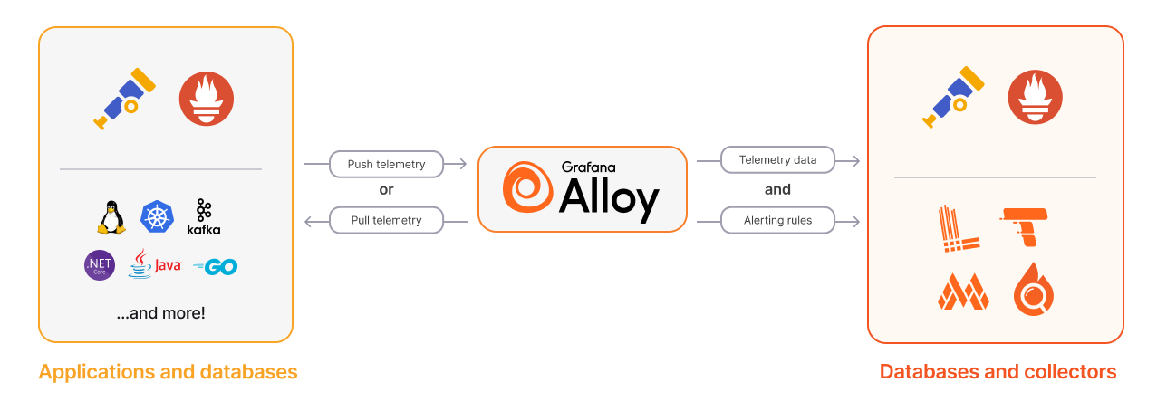

Grafana Alloy is a versatile observability collector that can ingest logs in various formats and send them to Loki. We recommend Alloy as the primary method for sending logs to Loki, as it provides a more robust and feature-rich solution for building a highly scalable and reliable observability pipeline.
Alloy flow diagram

Alloy pipelines are built using components that perform specific functions. For logs these can be broken down into three categories:
  • Collector: These components collect/receive logs from various sources. This can be scraping logs from a file, receiving logs over HTTP, gRPC or ingesting logs from a message queue.
  • Transformer: These components can be used to manipulate logs before they are sent to a writer. This can be used to add additional metadata, filter logs, or batch logs before sending them to a writer.
  • Writer: These components send logs to the desired destination. Our documentation will focus on sending logs to Loki, but Alloy supports sending logs to various destinations.
