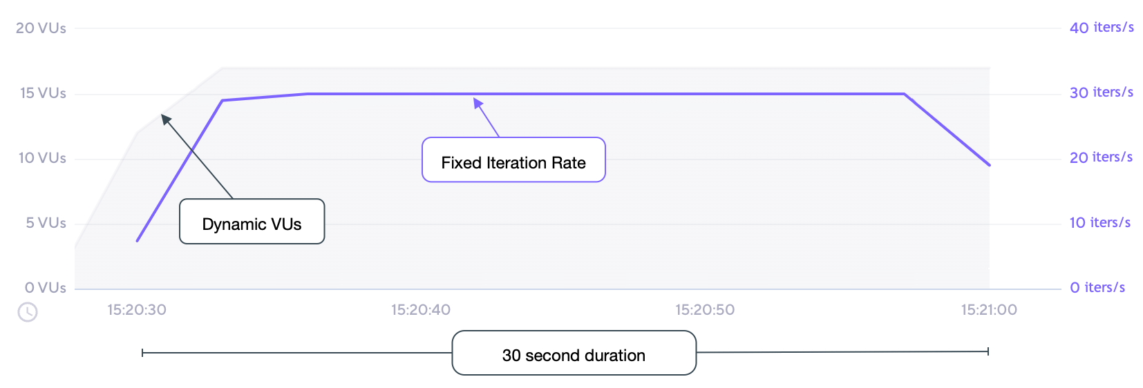

Observations
The following graph depicts the performance of the example script:
Ramping VUs
Based upon our test scenario inputs and results:
  • The desired rate of 30 iterations started every 1 second is achieved and maintained for the majority of the test.
  • The test scenario runs for the specified 30 second duration.
  • Having started with 2 VUs (as specified by the preAllocatedVUs option), k6 automatically adjusts the number of VUs to achieve the desired rate, up to the maxVUs. For this test, this ended up as 17 VUs.
  • The number of VUs to achieve the desired rate varies depending on how long each iteration takes to execute. For this test definition, if it would take exactly 1 second, then 30 VUs would be needed. However, as it takes less than 1 second, then less VUs are needed.
Using too low of a preAllocatedVUs setting will reduce the test duration at the desired rate, as resources need to continually be allocated to achieve the rate.
