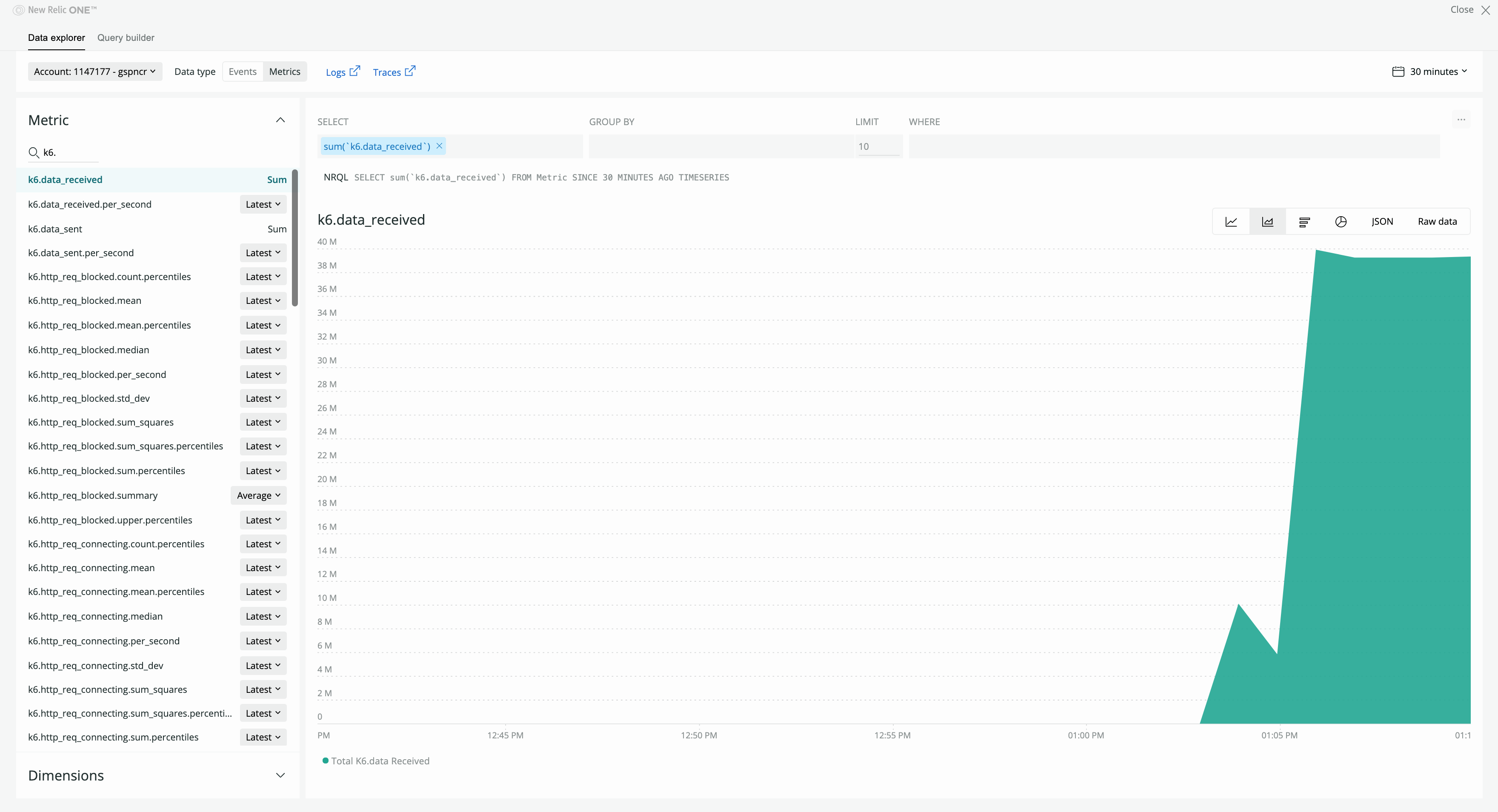

As your k6 test is running, k6 is sending performance metrics to the New Relic StatsD integration which in turn is sending these metrics to the New Relic Telemetry Data Platform. These will be prefixed with k6. so you can identify them.
k6 metrics as seen in the New Relic data explorer
You can visualize the metrics sent from this integration in the data explorer in the top right of New Relic (query your data).

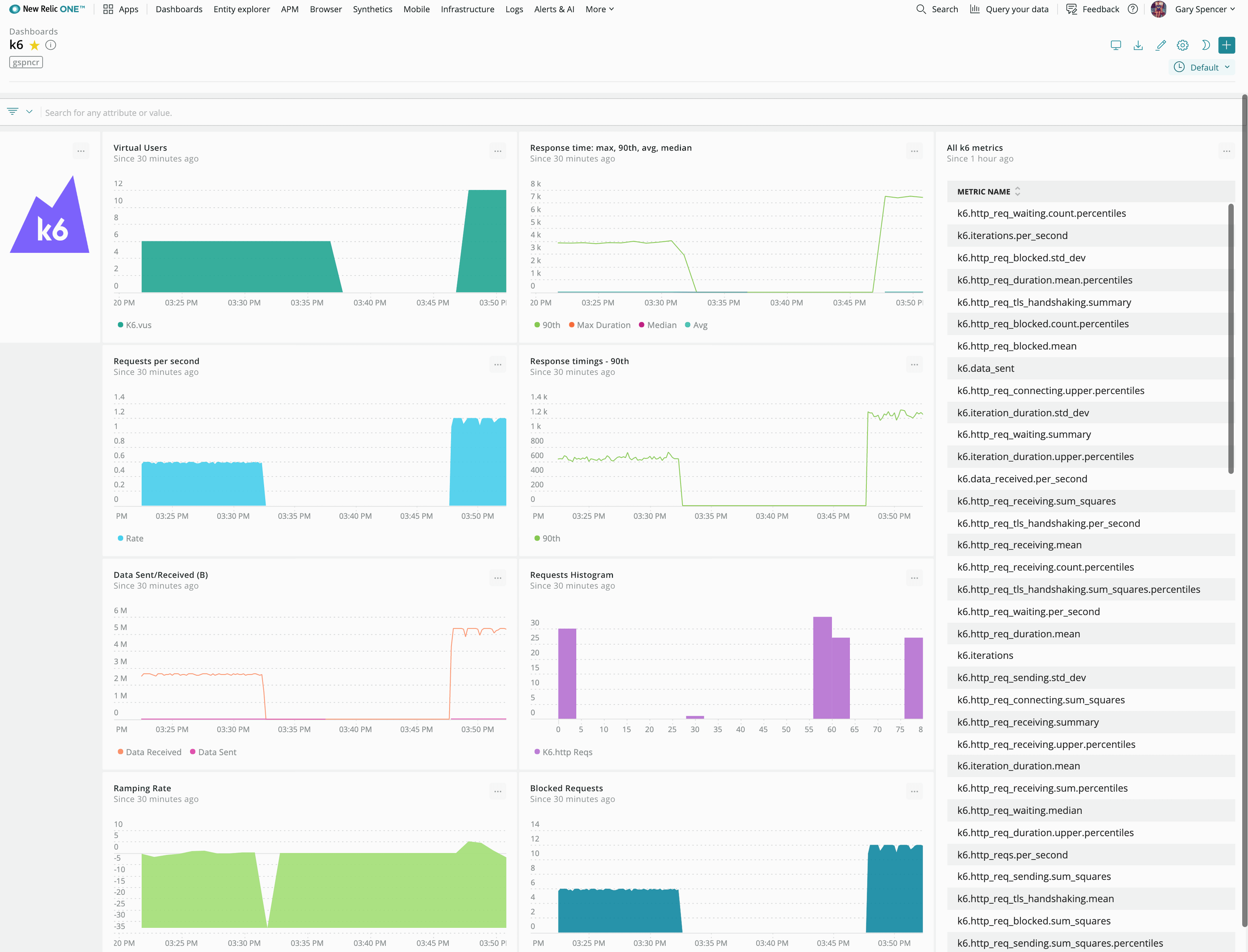

Sample New Relic k6 dashboard
You can also add these metrics to dashboards and alert on k6 metrics.
