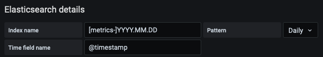

Index settings
Elasticsearch data source details
Use the index settings to specify a default for the time field and your Elasticsearch index’s name. You can use a time pattern, such as YYYY.MM.DD, or a wildcard for the index name.
