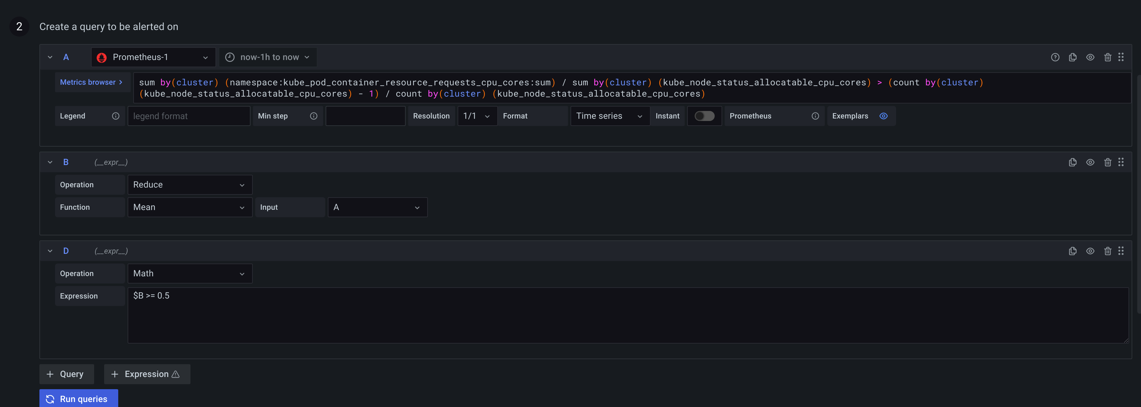

To generate a separate alert for each series, create a multi-dimensional rule. Use Math, Reduce, or Resample expressions to create a multi-dimensional rule. For example:
  • Add a Reduce expression for each query to aggregate values in the selected time range into a single value. (Not needed for rules using numeric data).
  • Add a Math expression with the condition for the rule. Not needed in case a query or a reduce expression already returns 0 if rule should not fire, or a positive number if it should fire. Some examples: $B > 70 if it should fire in case value of B query/expression is more than 70. $B < $C * 100 in case it should fire if value of B is less than value of C multiplied by 100. If queries being compared have multiple series in their results, series from different queries are matched if they have the same labels or one is a subset of the other.
Query section multi dimensional
Note: Grafana does not support alert queries with template variables. More information is available at https://community.grafana.com/t/template-variables-are-not-supported-in-alert-queries-while-setting-up-alert/2514.
