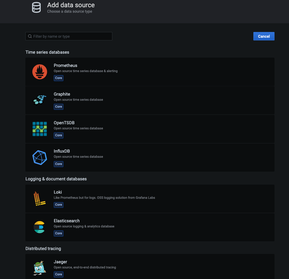

Click Add data source to see a list of all supported data sources.
Search for a specific data source by entering the name in the search dialog. Or you can scroll through supported data sources grouped into time series, logging, tracing and other categories.

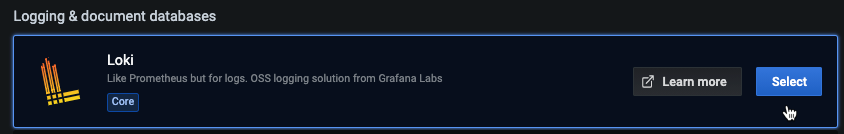

Move the cursor over the data source you want to add.
Click Select. The data source configuration page opens.
