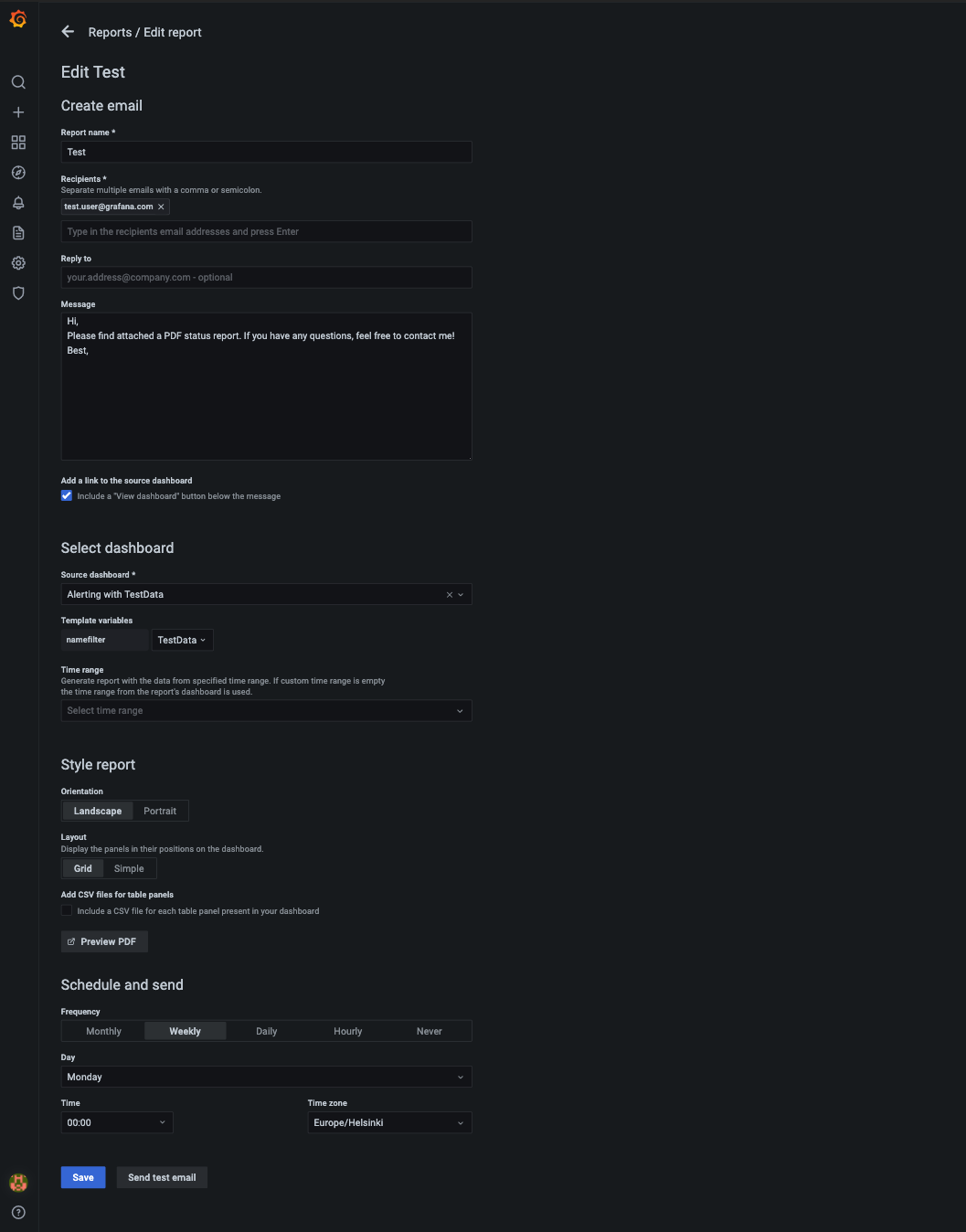

Create or update a report
Currently only Organization Admins can create reports.
  1. Click on the reports icon in the side menu. The Reports tab allows you to view, create, and update your reports.
  2. Enter report information. All fields are required unless otherwise indicated.
    • Name - Name of the report as you want it to appear in the Reports list.
    • Source dashboard - Select the dashboard to generate the report from.
    • Recipients - Enter the emails of the people or teams that you want to receive the report.
    • Reply to - (optional) The address that will appear in the Reply to field of the email.
    • Message - (optional) Message body in the email with the report.
    • Time range - (optional) Use custom time range for the report. For more information check Report time range.
  3. Preview PDF to make sure the report appears as you expect. Update if necessary.
  4. Enter scheduling information. Options vary depending on the frequency you select.
  5. Select the orientation option for generated report: Portrait or Landscape.
  6. Select the layout option for generated report: Simple or Grid.
  7. Save the report.
  8. Send test email to verify that the whole configuration is working as expected.
