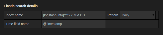

Index settings
Elasticsearch data source details
Here you can specify a default for the time field and specify the name of your Elasticsearch index. You can use a time pattern for the index name or a wildcard.

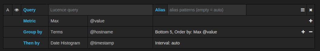

Metric Query editor
Elasticsearch Query Editor
The Elasticsearch query editor allows you to select multiple metrics and group by multiple terms or filters. Use the plus and minus icons to the right to add/remove metrics or group by clauses. Some metrics and group by clauses haves options, click the option text to expand the row to view and edit metric or group by options.

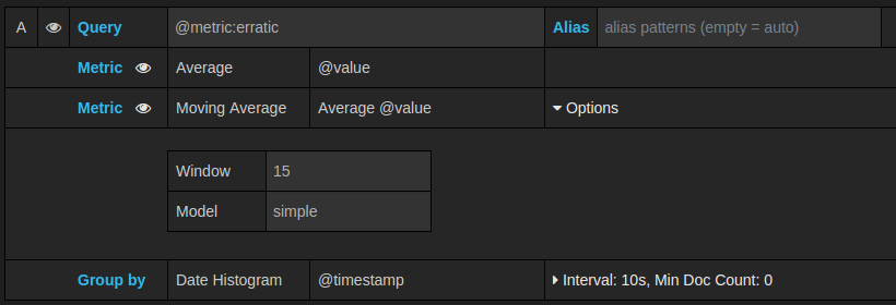

Pipeline metrics
Some metric aggregations are called Pipeline aggregations, for example, Moving Average and Derivative. Elasticsearch pipeline metrics require another metric to be based on. Use the eye icon next to the metric to hide metrics from appearing in the graph. This is useful for metrics you only have in the query for use in a pipeline metric.

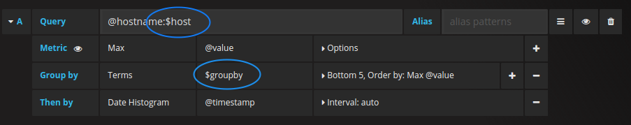

Using variables in queries
There are two syntaxes:
  • $<varname> Example: @hostname:$hostname
  • [[varname]] Example: @hostname:[[hostname]]
Why two ways? The first syntax is easier to read and write but does not allow you to use a variable in the middle of a word. When the Multi-value or Include all value options are enabled, Grafana converts the labels from plain text to a lucene compatible condition.
In the above example, we have a lucene query that filters documents based on the @hostname property using a variable named $hostname. It is also using a variable in the Terms group by field input box. This allows you to use a variable to quickly change how the data is grouped.
