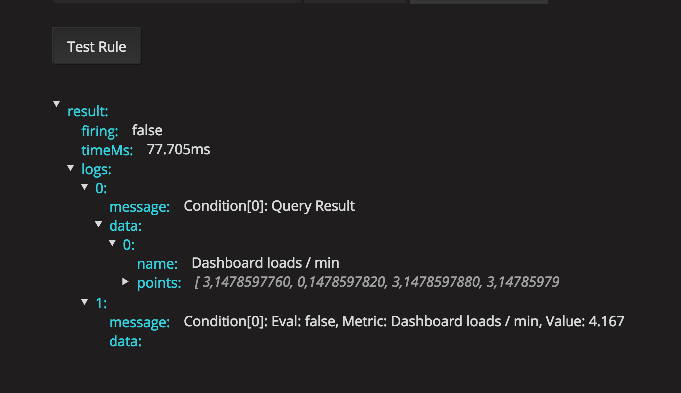

If alerts are not behaving as you expect, here are some steps you can take to troubleshoot and figure out what is going wrong.
Test Rule
Test Rule
The first level of troubleshooting you can do is click Test Rule. You will get result back that you can expand to the point where you can see the raw data that was returned from your query.
