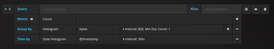

With Elasticsearch you control the size of the buckets using the Histogram interval (Y-Axis) and the Date Histogram interval (X-axis).
Elastic histogram
