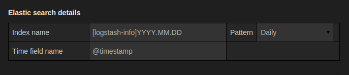

Here you can specify a default for the time field and specify the name of your Elasticsearch index. You can use a time pattern for the index name or a wildcard.

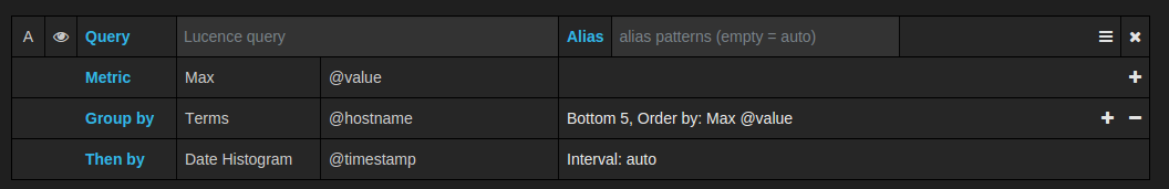

The Elasticsearch query editor allows you to select multiple metrics and group by multiple terms or filters. Use the plus and minus icons to the right to add/remove metrics or group by clauses. Some metrics and group by clauses haves options, click the option text to expand the row to view and edit metric or group by options.

You can control the name for time series via the Alias input field.
PatternDescription
{{term fieldname}}replaced with value of a term group by
{{metric}}replaced with metric name (ex. Average, Min, Max)
{{field}}replaced with the metric field name
