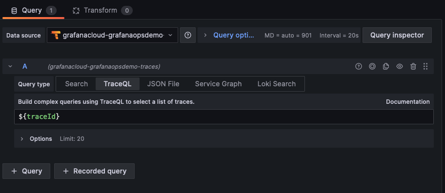

  6. In the query editor, click the TraceQL query type tab.
  7. Enter ${traceId} in the TraceQL query field to create a dashboard variable. This variable is used as the template query.

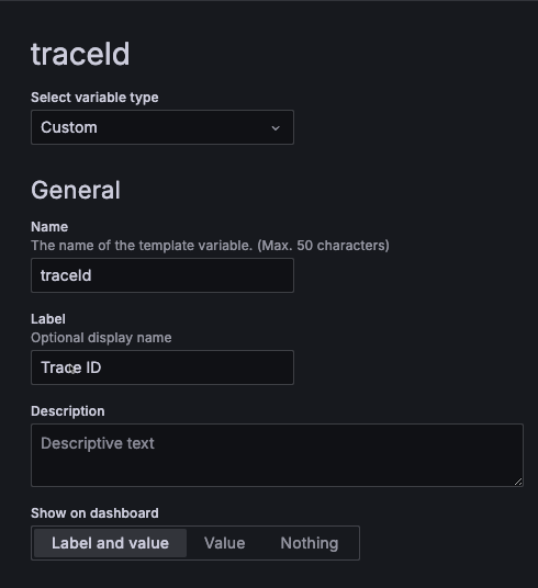

  9. Click the Add new element icon and click Variable.
  10. Add a new variable called traceId, of variable type Custom, giving it a label if required.

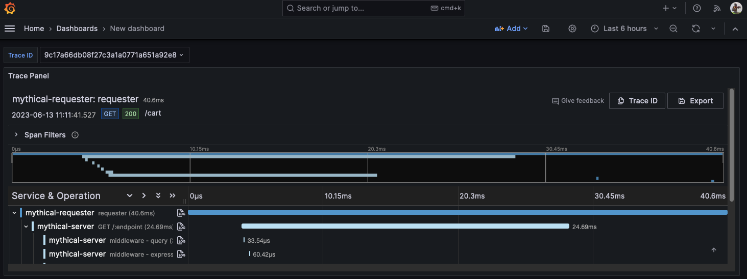

  14. Verify that the panel works by using a valid trace ID for the data source used for the trace panel and editing the ID in the dashboard variable.
    Results of query in trace panel

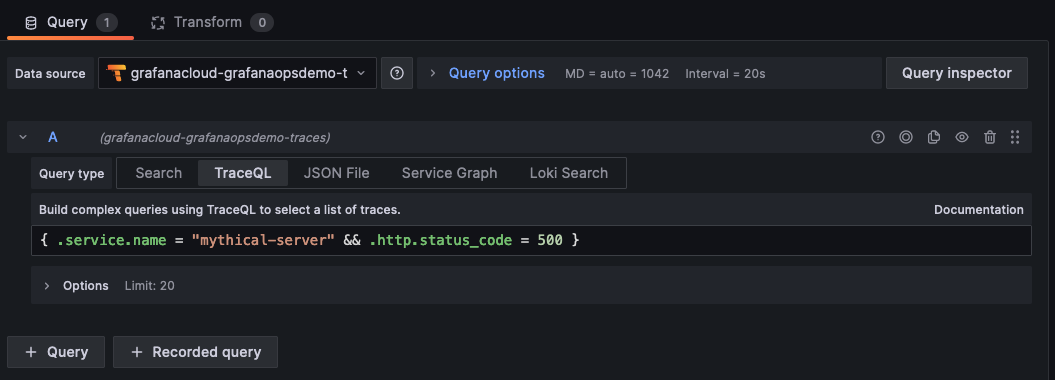

  8. Add an appropriate TraceQL query to search for traces that you would like to visualize in the dashboard. This example uses a simple, static query. You can write the TraceQL query as a template query to take advantage of other dashboard variables, if they exist. This lets you create dynamic queries based on these variables.
    Create a dynamic query

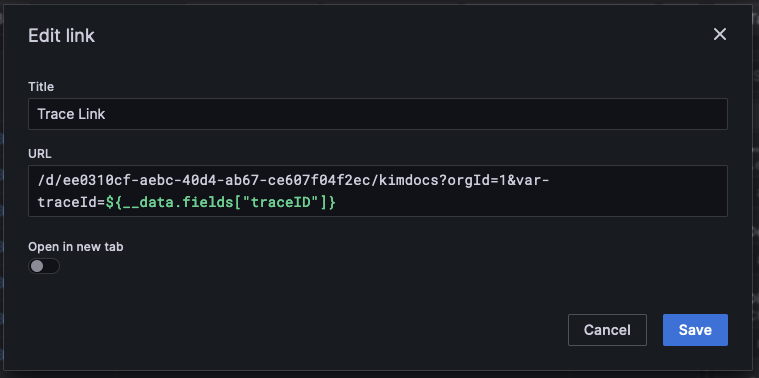

  1. In the panel editor menu, under Data links, click Add link.
  2. Add a Title for the data link.
  3. Find the UUID of the dashboard by looking in your browser’s address bar when the full dashboard is being rendered. Because this is a link to a dashboard in the same Grafana instance, only the path of the dashboard is required.
    Unique identifier for the dashboard
  4. In the URL field, make a self-reference to the dashboard that contains both of the panels. This self-reference uses the value of the selected trace in the table to fill in the dashboard variable. Use the path for the dashboard from the previous step and then fill in the value of traceId using the selected results from the TraceQL table. The trace ID is exposed using the traceID data field in the returned results, so use that as the value for the dashboard variable.
    Edit link and add the Trace link
  5. Select Save to save the data link.
