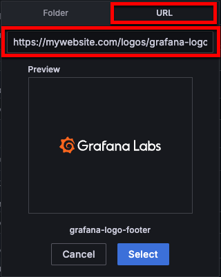

Add a custom icon
You can add a custom icon by referencing an SVG file. To add a custom icon, follow these steps:
  1. Under Icon > SVG Path, if it’s not already selected, select Fixed as your file source.
  2. Click Select a value in the field below.
  3. In the dialog box that opens, click the URL tab.
  4. Enter the URL in the field below the URL tab.
    Add a custom image URL
  5. Click Select.

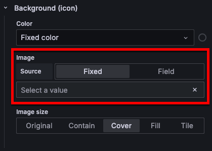

  6. (Optional) Add a background image to your icon with the Background (icon) option by following the steps to add a custom image.
If you don’t have an SVG file, you can use a rectangle element instead of an icon and set its background image to an image file type. To add a custom image for another element type, follow the steps to add a custom image.

  1. Under Background (<ELEMENT TYPE>), if it’s not already selected, select Fixed as your image source.
    Custom image source selection
  5. Click Select.

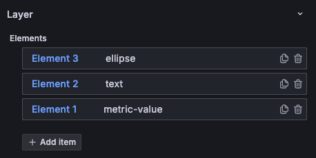

Elements (layer)
Use the Add item button to open the element type drop-down list. Elements are listed in the reverse order that you add them to the canvas:
Canvas elements added in the Layer options
By default, elements have numbered names, like “Element 1”, and those numbers correspond to the order in which the elements were added, but you can change the default names.
You can also take the following actions on elements:
  • Change the order of elements by clicking and holding the row of the element while moving it up and down in the element list.
  • Duplicate or remove elements by clicking the icons on the element row.
  • Access the element editing options by clicking the element row. This displays the Selected element section of options. Click Clear selection to remove the element from focus and stop displaying that section of options.

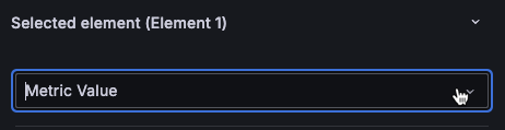

Element type
You can change element type by making a new selection in the drop-down list:
Cursor on the element type selection drop-down

Background (element)
Use the following options to set the background of the element:
