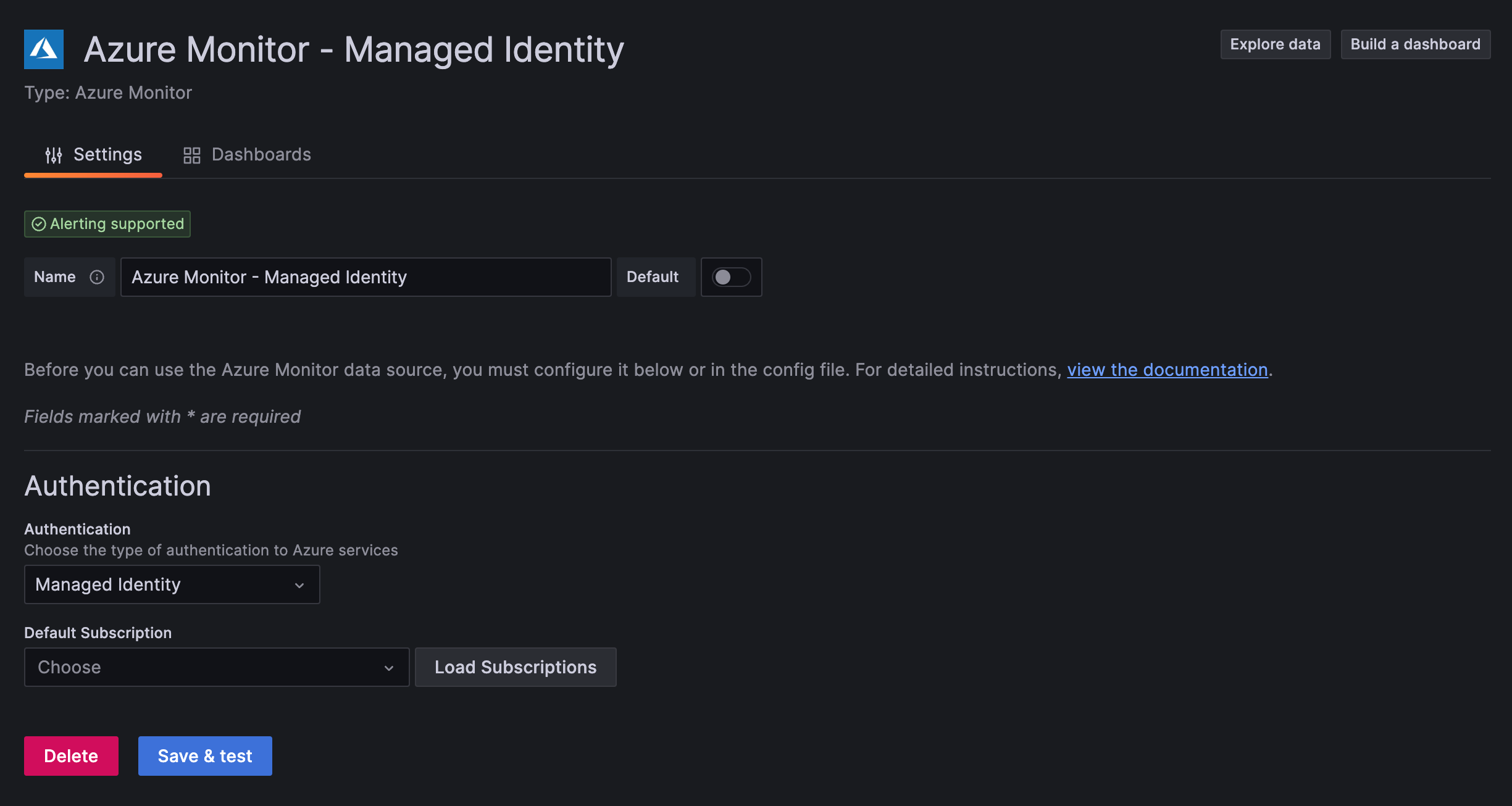

Configure Managed Identity
Note
Managed Identity is available only in Azure Managed Grafana or Grafana OSS/Enterprise when deployed in Azure. It is not available in Grafana Cloud.
You can use managed identity to configure Azure Monitor in Grafana if you host Grafana in Azure (such as an App Service or with Azure Virtual Machines) and have managed identity enabled on your VM. This lets you securely authenticate data sources without manually configuring credentials via Azure AD App Registrations. For details on Azure managed identities, refer to the Azure documentation.
To enable managed identity for Grafana:
  1. Set the managed_identity_enabled flag in the [azure] section of the Grafana server configuration.
    ini
    [azure]
    managed_identity_enabled = true
  2. In the Azure Monitor data source configuration, set Authentication to Managed Identity.
    This hides the directory ID, application ID, and client secret fields, and the data source uses managed identity to authenticate to Azure Monitor Metrics and Logs, and Azure Resource Graph.
    Azure Monitor screenshot showing Managed Identity authentication

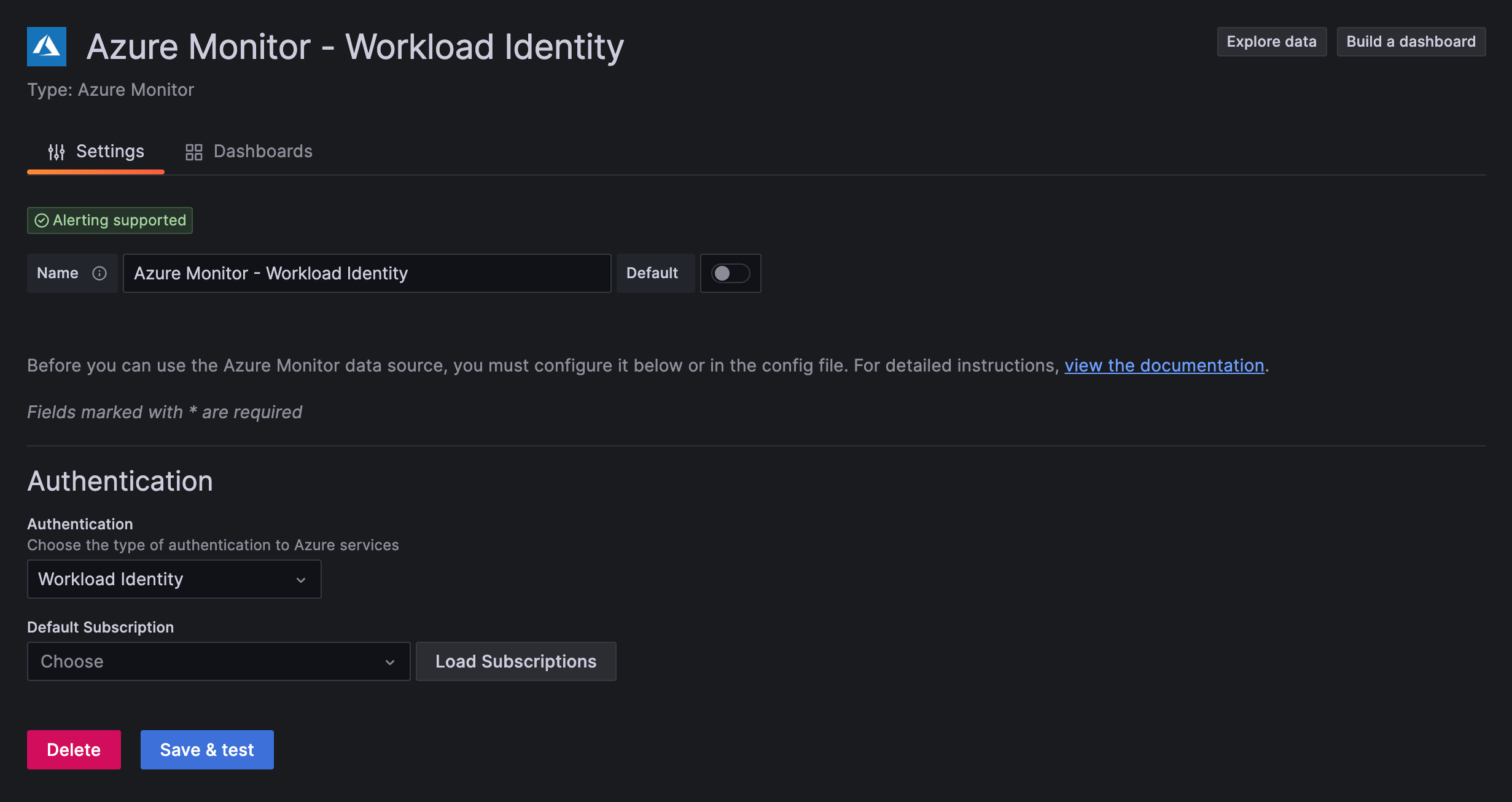

Configure Workload Identity
You can use workload identity to configure Azure Monitor in Grafana if you host Grafana in a Kubernetes environment, such as AKS, in conjunction with managed identities. This lets you securely authenticate data sources without manually configuring credentials via Azure AD App Registrations. For details on workload identity, refer to the Azure workload identity documentation.
To enable workload identity for Grafana:
  1. Set the workload_identity_enabled flag in the [azure] section of the Grafana server configuration.
    ini
    [azure]
    workload_identity_enabled = true
  2. In the Azure Monitor data source configuration, set Authentication to Workload Identity.
    This hides the directory ID, application ID, and client secret fields, and the data source uses workload identity to authenticate to Azure Monitor Metrics and Logs, and Azure Resource Graph.
    Azure Monitor screenshot showing Workload Identity authentication
  3. There are additional configuration variables that can control the authentication method.workload_identity_tenant_id represents the Azure AD tenant that contains the managed identity, workload_identity_client_id represents the client ID of the managed identity if it differs from the default client ID, workload_identity_token_file represents the path to the token file. Refer to the documentation for more information on what values these variables should use, if any.
