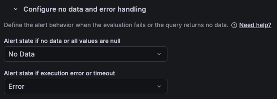

Modify the No Data or Error state
A screenshot of the configure no data and error handling section in the alert rule form.
In Configure no data and error handling, you can configure the behavior when the evaluation returns no data or all values are null:
  • Set No Data state (Default)
    If the pending period is 0, the alert instance transitions immediately to No Data. Otherwise, it transitions to the Pending state, and then to No Data after the pending period has elapsed and the last evaluation returns no data.
    When entering the No Data state, the alert rule creates a new DatasourceNoData alert instance with labels for the alert rule name, UID, and data source UID.
  • Set Alerting state
    If the pending period is 0, the alert instance transitions immediately to Alerting. Otherwise, it transitions to the Pending state, and then to Alerting after the pending period has elapsed and the last evaluation returns no data or a threshold breach.
  • Set Normal state
    The alert instance transitions immediately to the Normal state.
  • Keep last state
    The alert instance keeps its current state.
You can also configure the behavior when the evaluation returns an error or timeout:
  • Set Error state (Default)
    If the pending period is 0, the alert instance transitions immediately to Error. Otherwise, it transitions to the Pending state, and then to Error after the pending period has elapsed and the last evaluation returns an error.
    When entering the Error state, the alert rule creates a new DatasourceError alert instance with labels for the alert rule name, UID, and data source UID.
    If the pending period is 0, the alert instance transitions immediately to Alerting. Otherwise, it transitions to the Pending state, and then to Alerting after the pending period has elapsed and the last evaluation returns an error or a threshold breach.
  • Set Normal state
  • Keep last state
