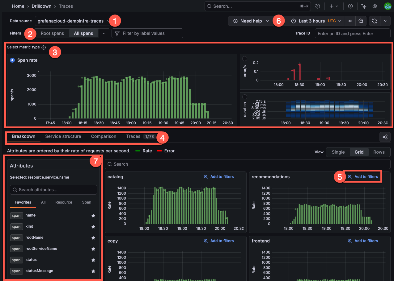

Numbered sections of the Traces Drilldown app
  1. Data source selection: At the top left, you select the data source for your traces. In this example, the data source is set to grafanacloud-traces.
  2. Filters: The filter bar helps you refine the data displayed. You can select the type of trace data, either Root spans or All spans. You can also add specific label values to narrow the scope of your investigation.
  3. Select metric type: Choose between Rate, Errors, or Duration metrics. In this example, the Rate metric is selected, showing the number of spans per second.
    • The Rate graph (top left) shows the rate of spans over time.
    • The Errors graph (top right) displays the error rate over time, with red bars indicating errors.
    • The Duration heatmap (bottom right) visualizes the distribution of span durations and can help identify latency patterns.
  4. Investigation-focused tabs: Each metric type has its own set of tabs that help you explore your tracing data. These tabs differ depending on the metric type you’ve selected. For example, when you use Rate, the investigation tabs show Breakdown, Service structure, Comparison, and Traces.
    • Exceptions (Errors only): Group exception messages with counts, trend sparkline, emitting service, and last-seen.
    • Percentiles (Duration only): Choose p50, p75, p90, p95, p99 for Duration views. Default: p90. If you clear all, p90 applies automatically.
  5. Add to filters: Each attribute group includes an Add to filters option, so you can add your selections into the current investigation.
  6. Time range selector: At the top right, you can adjust the time range for displayed data using the time picker. In this example, the time range is set to the last 24 hours. Refer to Set dashboard time range for more information.
    You can also open a specific trace by ID by entering the trace ID into the Trace ID input and pressing Enter. Refer to Open a trace by ID for more information.
  7. Attributes sidebar: Use the Attributes sidebar to select and manage attributes across views. Search attributes with regular expressions. Press Escape or click Clear to reset the search.
    Click the star icon to add or remove a favorite. Drag and drop favorites to reorder them. Switch between scopes: Favorites, All, Resource, Span. A filter icon marks attributes already applied in the Filters bar.
    In Breakdown and Comparison views, selecting an attribute sets the current Group by attribute. In Trace list view, select multiple attributes to add or remove table columns. The app saves favorites in your browser.
