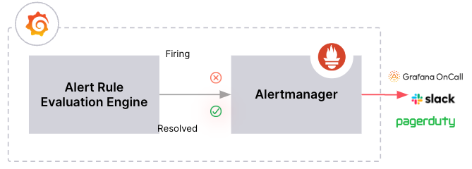

Grafana Alerting is based on the architecture of the Prometheus alerting system. Grafana sends firing and resolved alerts to an Alertmanager, which is responsible for handling notifications.

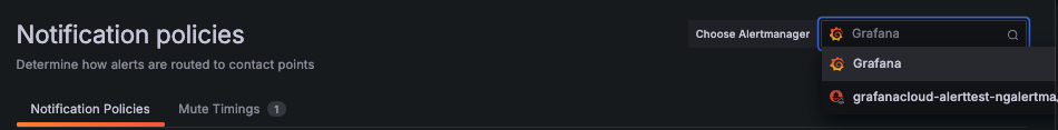

After you have added the Alertmanager, you can use the Grafana Alerting UI to manage silences, contact points, and notification policies. A drop-down option in these pages allows you to switch between alertmanagers.

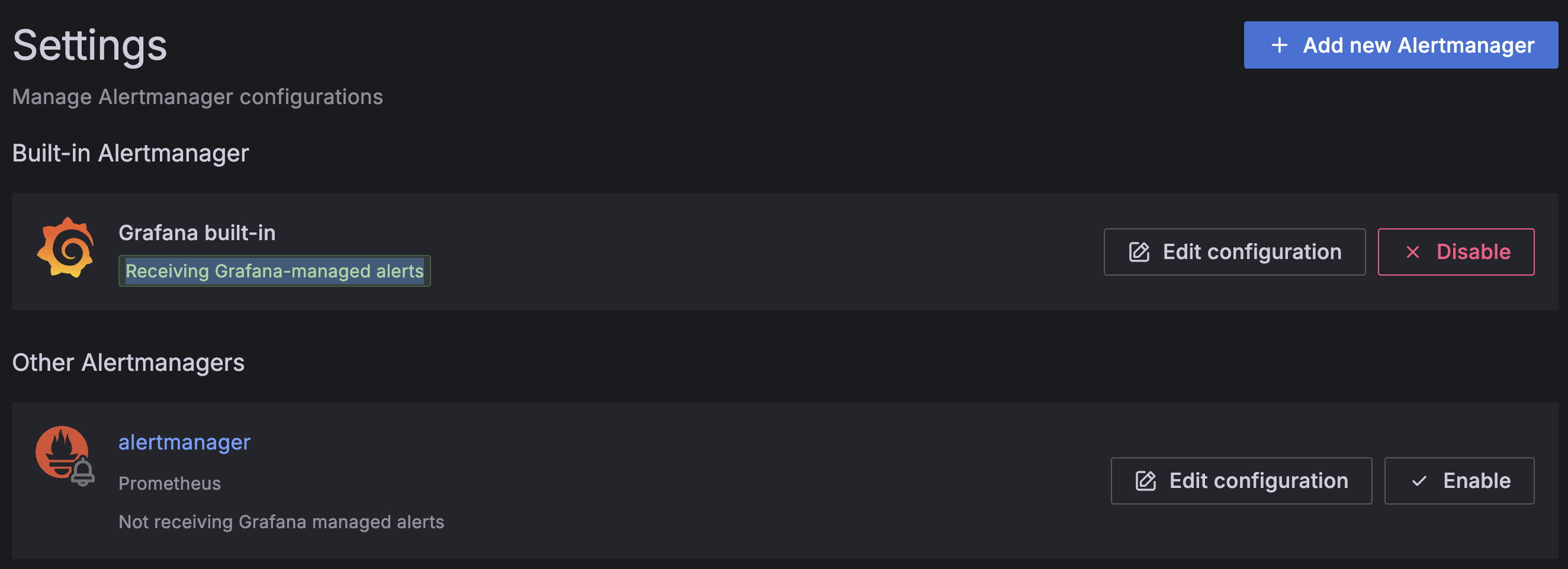

On the Settings page, you can manage your Alertmanager configurations and configure where Grafana-managed alert instances are forwarded.
- Manage which Alertmanagers receive alert instances from Grafana-managed rules without navigating and editing data sources.
- Manage version snapshots for the built-in Alertmanager, which allows administrators to roll back unintentional changes or mistakes in the Alertmanager configuration.
- Compare the historical snapshot with the latest configuration to see which changes were made.
