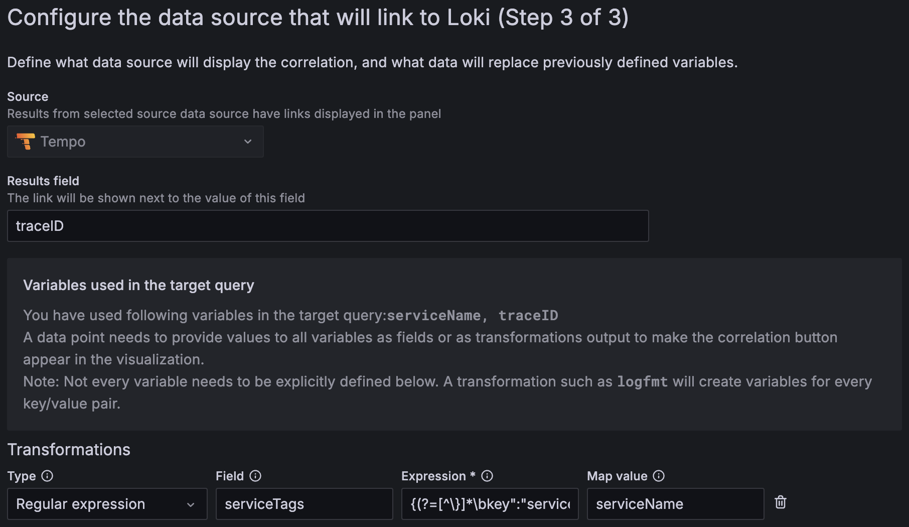

  6. On step 3, configure the correlation data source:
    • Select your Tempo data source in the Source drop-down list.
    • Enter the trace data variable you use for the correlation in the Results field.
    • Optionally, add one or more Transformations to parse the trace data into additional variables. You can use these variables to configure the correlation Target.

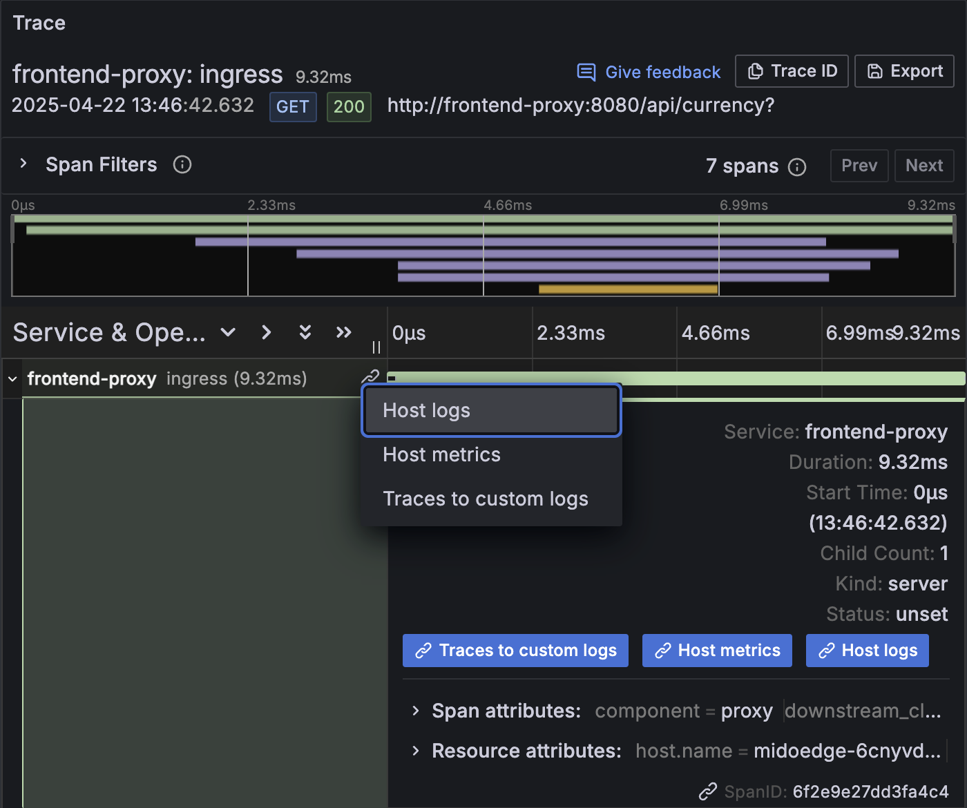

Verifying correlations in Explore
  1. Open Explore and select your Tempo tracing source.
  2. Run a query to load spans.
  3. Hover over the span links menu or open the span details to reveal the correlation link buttons.
    Using correlations for a trace
  4. Click a correlation link to open a split view or navigate to your target system or query.

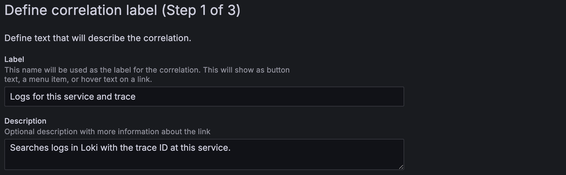

  1. On step 1, add a new correlation with the label Logs for this service and trace and an optional description.

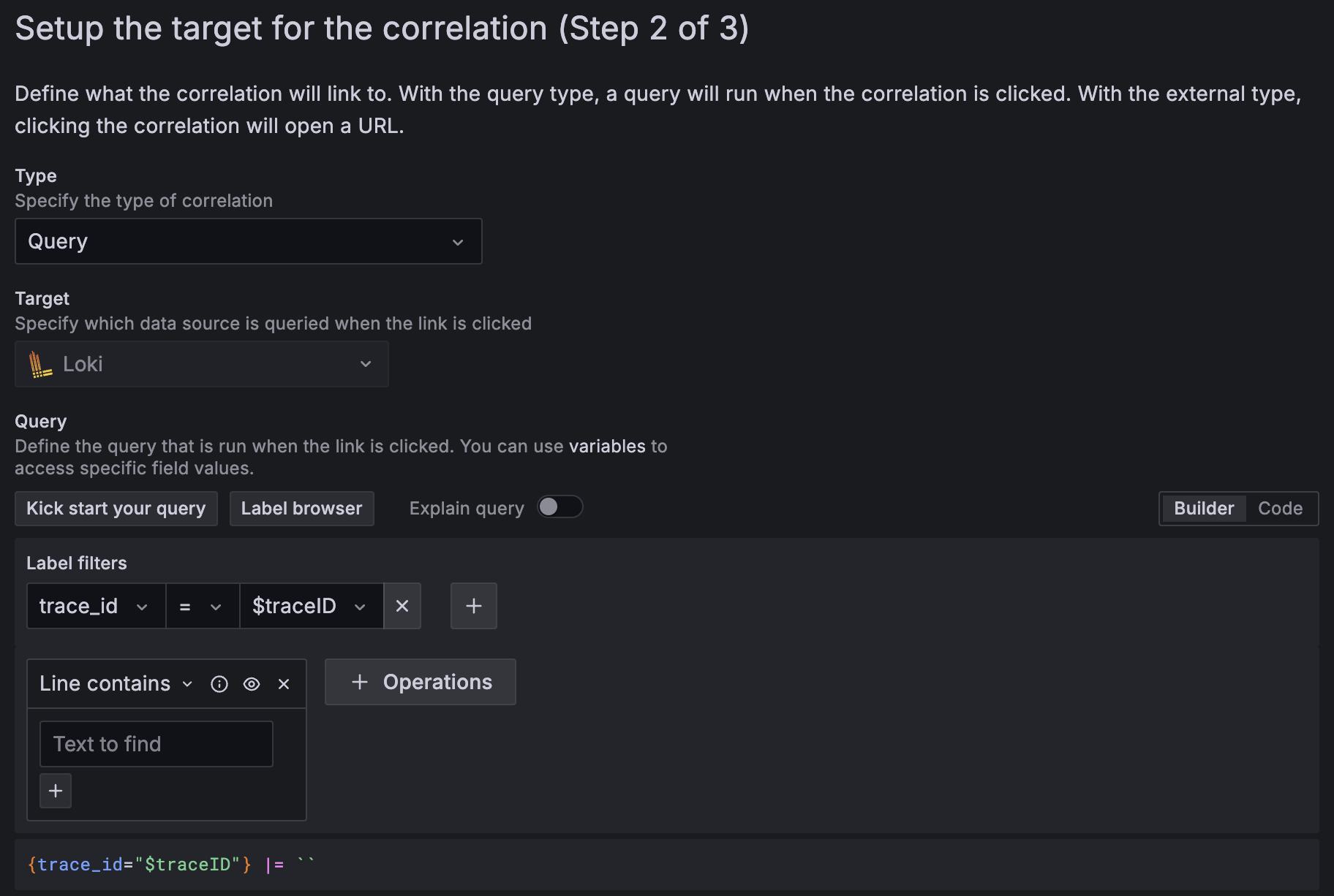

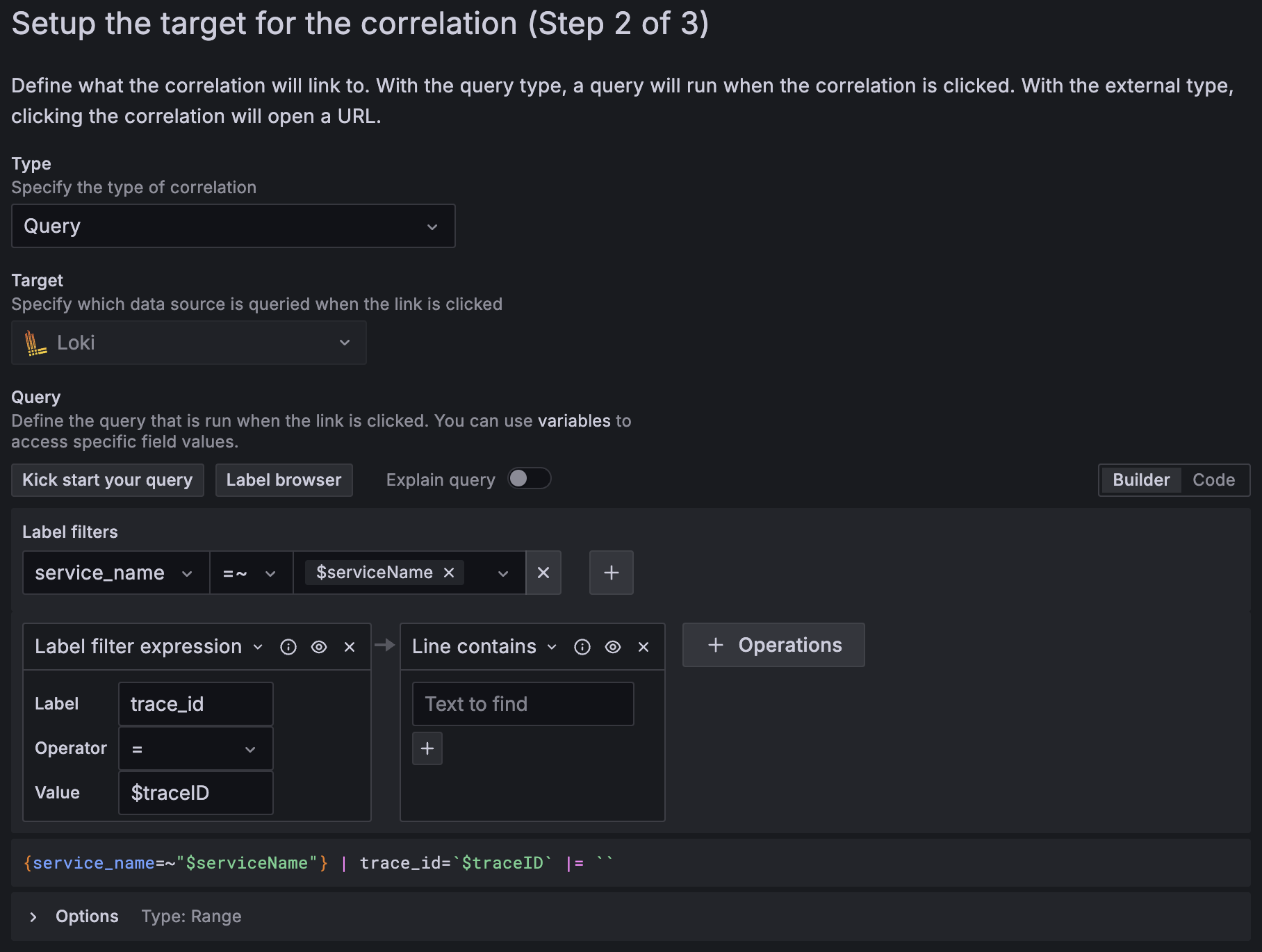

  2. On step 2, configure the correlation target:
    • Select the target type Query and select your Loki data source as Target.
    • Define the Loki query, using serviceName and traceID as variables derived from the span data:
      {service_name="$serviceName"} | trace_id=`$traceID` |= ``

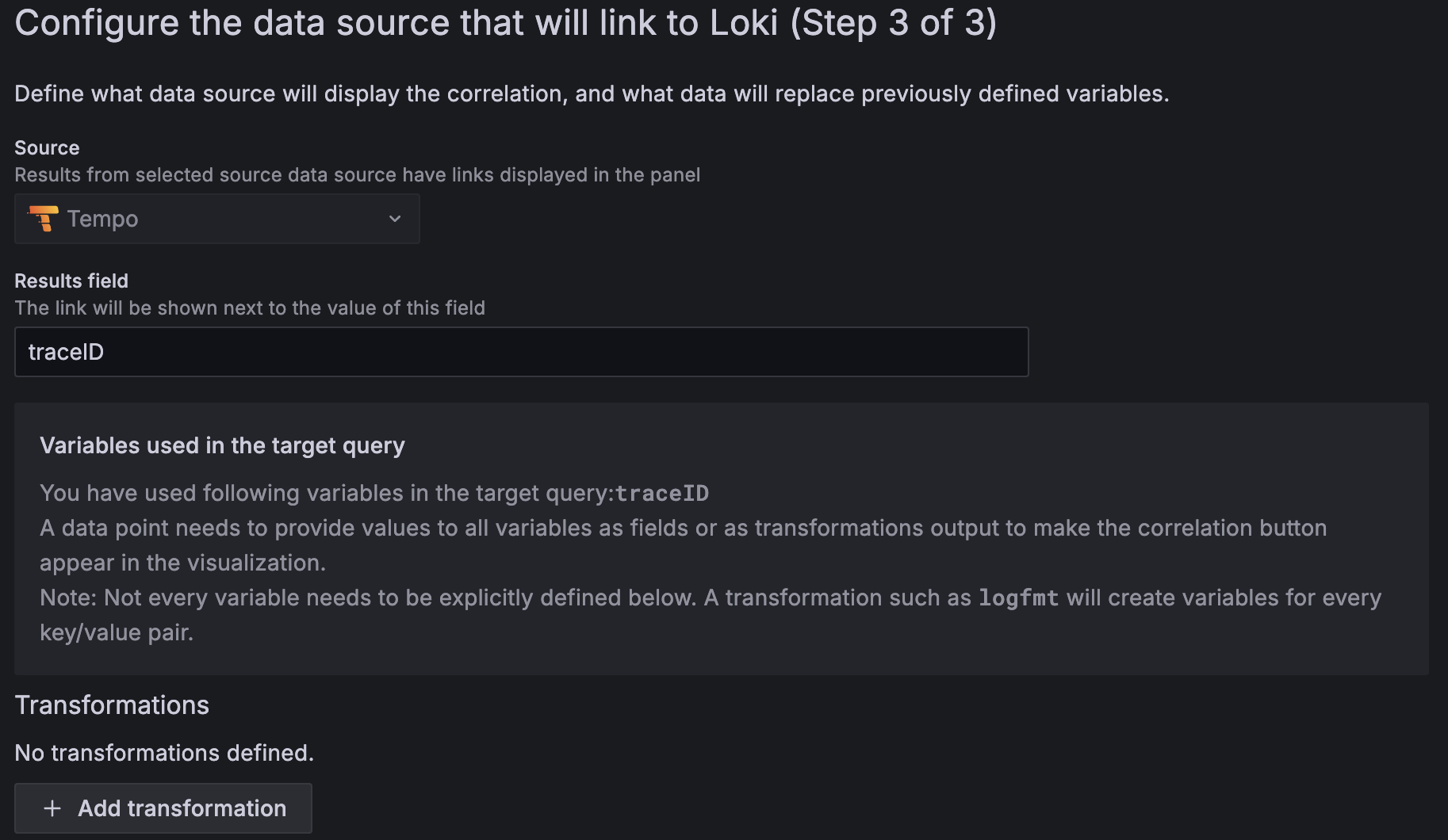

  3. On step 3, configure the correlation source:
    • Select your Tempo data source as Source.
    • Use traceID as Results field.
    • Add a new transformation to extract the serviceName from the span serviceTags using the regular expression:
      {(?=[^\}]*\bkey":"service.name")[^\}]*\bvalue":"(.*?)".*}
