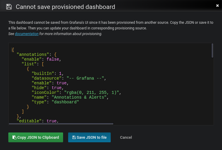

Grafana has an active provisioning system that uses configuration files. This makes GitOps more natural since data sources and dashboards can be defined using files that can be version controlled.

Data sources
You can manage data sources in Grafana by adding YAML configuration files in the provisioning/datasources directory. Each configuration file contains a list of data sources, under the datasources key, to add or update during startup. If the data source already exists, Grafana reconfigures it to match the provisioned configuration file.
You can also list data sources to automatically delete, using the key deleteDatasources. Grafana deletes the data sources listed in deleteDatasources before adding or updating those in the datasources list.
You can configure Grafana to automatically delete provisioned data sources when they’re removed from the provisioning file. To do so, add prune: true to the root of your data source provisioning file. With this configuration, Grafana also removes the provisioned data sources if you remove the provisioning file entirely.

Make changes to a provisioned dashboard
You can make changes to a provisioned dashboard in the Grafana UI but its not possible to automatically save the changes back to the provisioning source. If allowUiUpdates is set to true and you make changes to a provisioned dashboard, when you save the dashboard, Grafana persists the changes to its database.
Caution
If you save a provisioned dashboard in the UI and then later update the provisioning source, Grafana always overwrites the database dashboard with the one from the provisioning file. Grafana ignores the version property in the JSON file, even if it’s lower than the dashboard in the database.
Caution
If you save a provisioned dashboard in the UI and remove the provisioning source, Grafana deletes the dashboard in the database unless you have set the option disableDeletion to true.
If you set allowUiUpdates to false, you can’t save changes to a provisioned dashboard. When you try to save changes to a provisioned dashboard, Grafana brings up a Cannot save provisioned dashboard dialog box.
Grafana offers options to export the JSON definition of a dashboard. Use either Copy JSON to Clipboard or Save JSON to file to sync your dashboard changes back to the provisioning source. Grafana removes the id field from the dashboard JSON to help the provisioning workflow.
The following screenshot illustrates this behavior.
