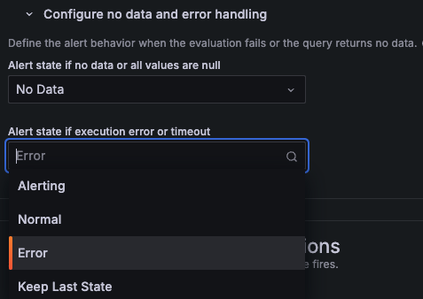

Grafana Alerting has built-in handling for execution errors, regardless of the data source. That includes Prometheus, and others like Graphite, InfluxDB, PostgreSQL, etc. By default, Grafana Alerting automatically handles query errors so you don’t miss critical failures. When an alert rule fails to execute, Grafana fires a special DatasourceError alert.
You can configure this behavior depending on how critical the alert is and on whether you already have other alerts detecting the issue. In Configure no data and error handling, click Alert state if execution error or timeout, and choose the desired option for the alert:
  • Error (default): Triggers a separate DatasourceError alert. This default ensures alert rules always inform about query errors but can create noise.
  • Alerting: Treats the error as if the alert condition is firing. Grafana transitions all existing instances for that rule to the Alerting state.
  • Normal: Ignores the query error and transitions all alert instances to the Normal state. This is useful if the error isn’t critical or if you already have other alerts detecting connectivity issues.
  • Keep Last State: Keeps the previous state until the query succeeds again. Suitable for unstable environments to avoid flapping alerts.
    A screenshot of the `Configure error handling` option in Grafana Alerting.
This applies even when alert rules query Prometheus itself—not just external data sources.
